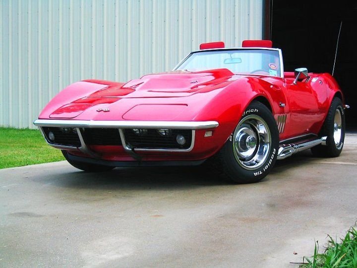

Side-pipes are a cool thing to have on any old Corvette. My cousin had a 1967 SB convertible with the factory side-pipes and it was virtually impossible to have a conversation while running around town or at highway speeds. I would imagine that you can deaden the sound a bit but you still have to deal with the other issues of Side-Pipes like really bad burns on inner leg that made contact with the Hooker Side-pipes. The factory style with fiberglass covers would be a much better option over the beautiful Chrome Hooker side-pipes.
I found a company (who is no longer around) who offered side-pipe conversions with the Fiberglass covers for around $2K (UN-Painted) back in the late 1990's. The company (Allen's SS Exhaust) also offered new Chambered Exhaust Systems in either SS or Aluminized Steel. They offered the chambered exhaust in three noise levels so I bought a set for my 1968 C3 427 with it's convertible. Using the Chambered Exhaust the noise is "following you" and not "next to you". My chambered exhaust system sounds like side-pipes but all the noise is out the rear of the car. I actually have 2 sets of these chambered pipes, one on my 1968 C3 and the other on a 1988 C4 and they both have performed perfectly for over 2 decades on each of the Corvettes. The C4 even sounds ferocious with it's little L98 engine making 255 hp. The system makes the car sound like a Corvette should sound (at least in MY Book) and the elimination of the mufflers gets rid of the ugly cans in the rear of the Corvette.
The car above that belongs to Corey 68 is beautiful with the side-pipes on it, I personally like the look of the Hooker chrome side-pipes myself but even the factory system looks nice. If you choose to use a side-pipe setup be sure to get as much sound deadening material in them. Another buddy here in Virginia has a 1967 Coupe with factory side-pipes and he removed all the deadening material but soon started getting hounded by a Local LEO who thought the sound was a bit too much for the street use. In the end he was ticketed for excessive noise three times and finally had to put the sound deadener back into the system.
The chambered system on my C3 will still wake neighbors when I start it early in the day and it regularly sets off vehicle alarm systems. As long as I don't rev it too high it is very easy to get along with neighbors. My system is attached to a 427 that was rebuilt to be a L88 copy and it sounded ferocious with the standard exhaust but the chambered exhaust really improved the sound. With the high compression it makes a spitting sound at idle which seems to attract small Asian cars that think they can play with a BB Corvette. Having a 3.36 rear makes the sound much more tolerable at highway speeds. My cousin's 1967 C2 had a 4.11 rear and I heard buzzing in my ears after a few minute ride, it was just a bit too much for me.
I just wanted to be sure that you are aware that a Chambered System can make the same sounds but just coming out of a better place on the car. Even with my hard top on the Corvette it is still very easy to listen to the radio or carry on a conversation.
