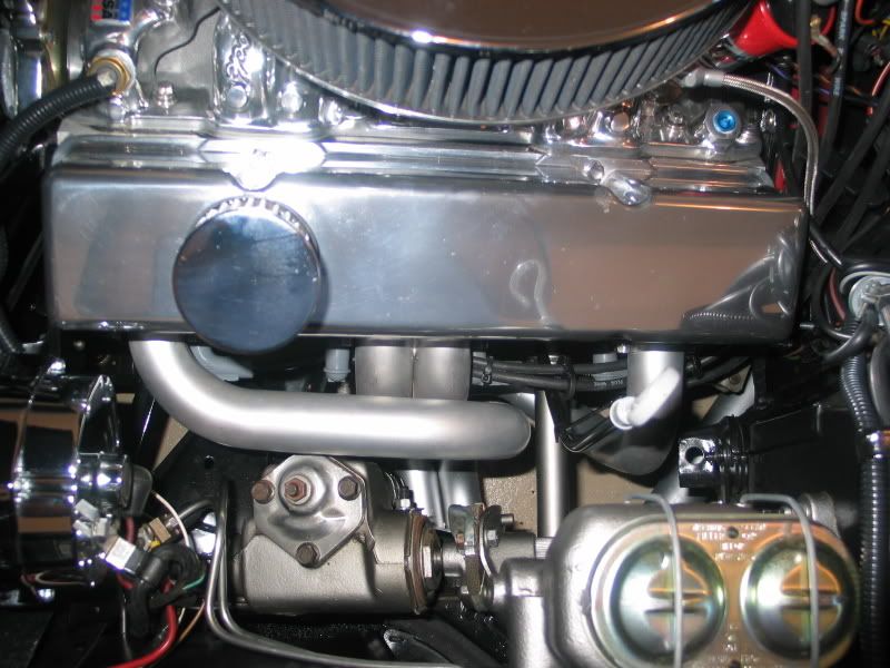

Until this point, I didn't think high performance and factory side pipe covers went together. Let me say - kudos to Stahl Headers and Spiral Turbo Specialities (STS)! Both designed a new product using my car as a prototype. The punch line is 1 3/4" Stahl headers with split collectors into 3.5" tail pipes with shortened STS baffles... and, a balance tube. Photos and two video links at the end of this post.
I have always been a fan of the original factory side pipe covers on chrome bumper cars, but when I completed my last engine upgrade I thought I might not have a choice but to switch to rear exit exhaust to ensure I maximized my performance and maintained a reasonable sound quality. With the amount of money I invested in the 406, I didn't want to lose 70-90 hp through my existing exhaust (Hedman Headers into 2.5" pipes with dynomax chambered exhaust under the factory covers). I searched and searched and could not find anything I liked. Then I ran across Stahl and STS. These guys both spent a lot of time discussing combinations and design options with me over the phone - then I drove my car two hours to have Stahl use the car as a prototype to design a new set side exit headers.
To give an idea of performance... I drove the car 125 miles to Stahl. I have a Kiesler/Tremec 5 speed and I discovered on the drive up that my engine did not like 5th gear at all below 70 mph - I found myself constantly shifting between 4th and 5th gear. I was amazed on the way home that I was able to comfortably stay in 5th gear the entire way home - even below 65mph. Low end torque was significantly increased. On the top end, I was even more amazed. Seat of the pants says I got back at least 50-70 hp and the thing just wants to keep pulling over 6500 rpm - before it was running out of steam just over 6000rpm. I have flywheel dyno data, so I promised STS I would do some chassis dyno runs to provide data inputs - will post once I find a chassis dyno.
As for sound, I am running the baffles uncapped. Even still, the sound is no louder than my old chambered exhaust. The main difference is I have a whole new sound - much more "racey". For now, I will leave them uncapped. Stahl also made me a set of shortened race pipes, so I might cap the baffles to reduce sound and use the race pipes at the track.
Workmanship and quality of materials for both Stahl and STS was top notch. I have gained significant performance improvements and achieved a reasonable sound level (yes, it is loud, but can be quieted by capping the baffles or using a longer baffle).
Here are some photos and a video link (1st and 2nd gear to 6500 - 90% throttle with granny shifts... still running the original rear - don't want to break it before it has a chance to be rebuilt.)

Going from Headman side exhaust headers to Stahl alone is a HUGE difference. Adding the cool quad(?) exhaust has gotta be way helpful.
