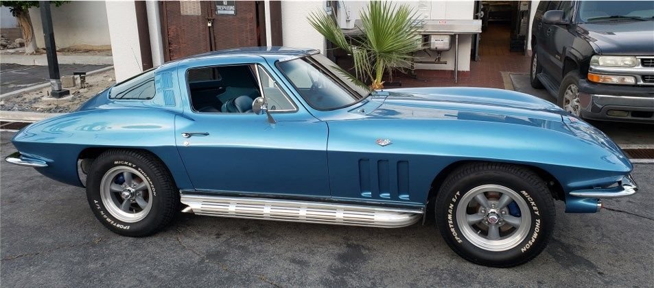

Hello All,
I soon need to replace my 8 year old BF Goodrich tires on my 72 and would possibly like to go with Mickey Thompson white letters. Anyone out there running Mickey Thompson tires and if so what size? Pics would be great!!! Would love to see what they look like mounted. Many Thanks

I am, love them!
215/70/15 all around. I bought a pair of 295/50/15's for the rear but they were a little too big and touched the fenders on my '65. You won't have that problem with a C3.
