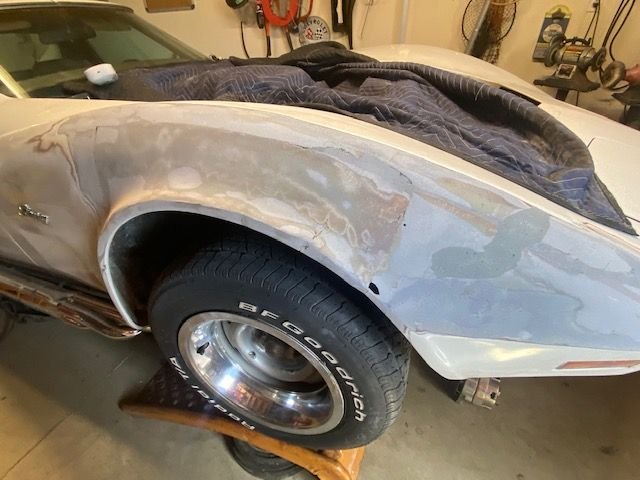

Will packing tape work as a release agent for SMC panels? I am planning on starting the fiberglass work.

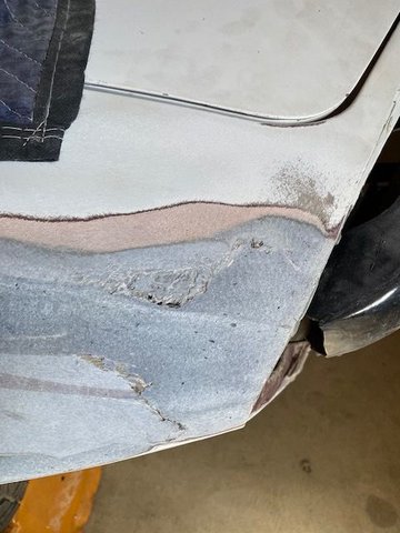

Big repairs. Passenger fender is way off

Yup, looks like a big repair. Best of luck.

Glassed-in front noses, usually (eventually) crack. Yours doesn't look too bad though..
