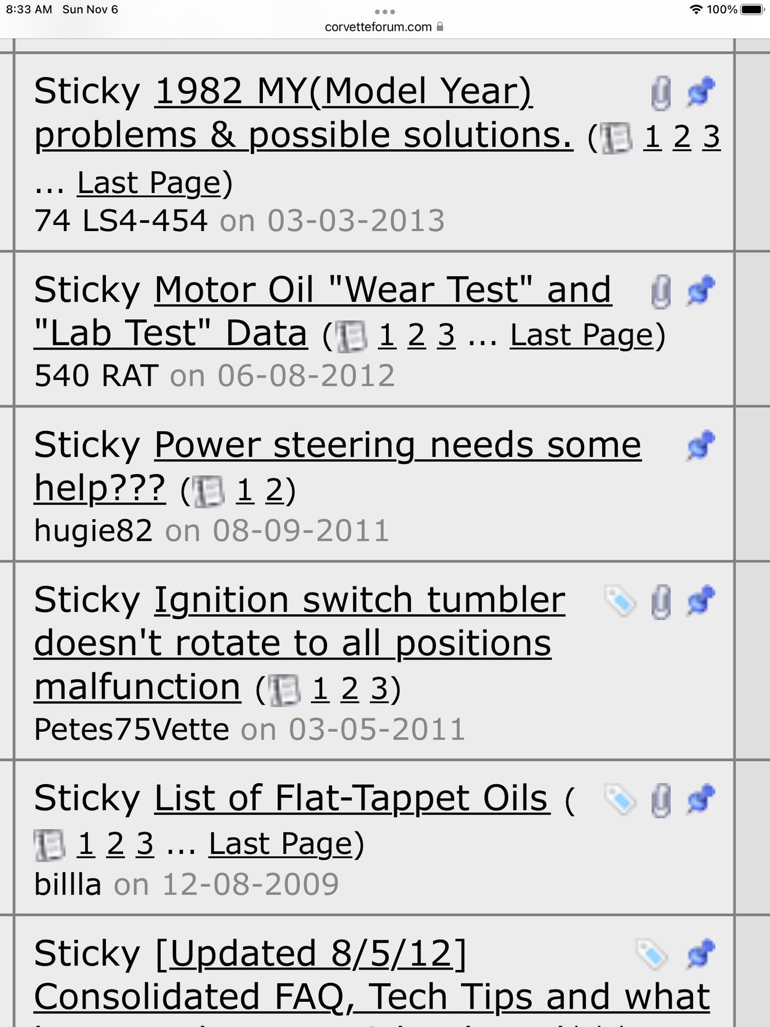

There are two stickies at the top of the page on oil goes into some pretty good detail. With that said it’s always good to update what’s been available on the market in the past and what’s available now. For me Walmart mobile one 15–50 full synthetic with a lot of zinc in it is the best most economical for me. I drive about about 5000 miles a year and change it about every 3000 miles and I go through about a quart in between. My engine has 43,000 miles on it now.
