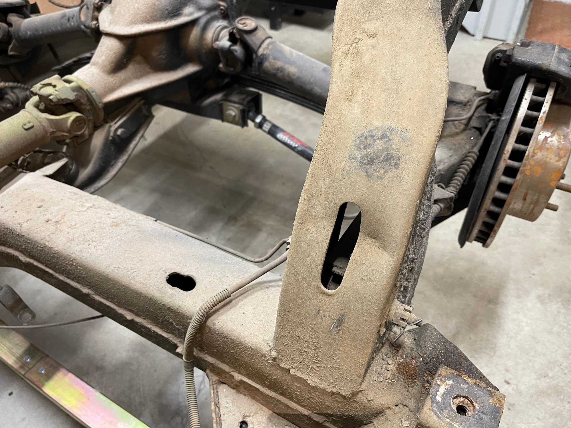

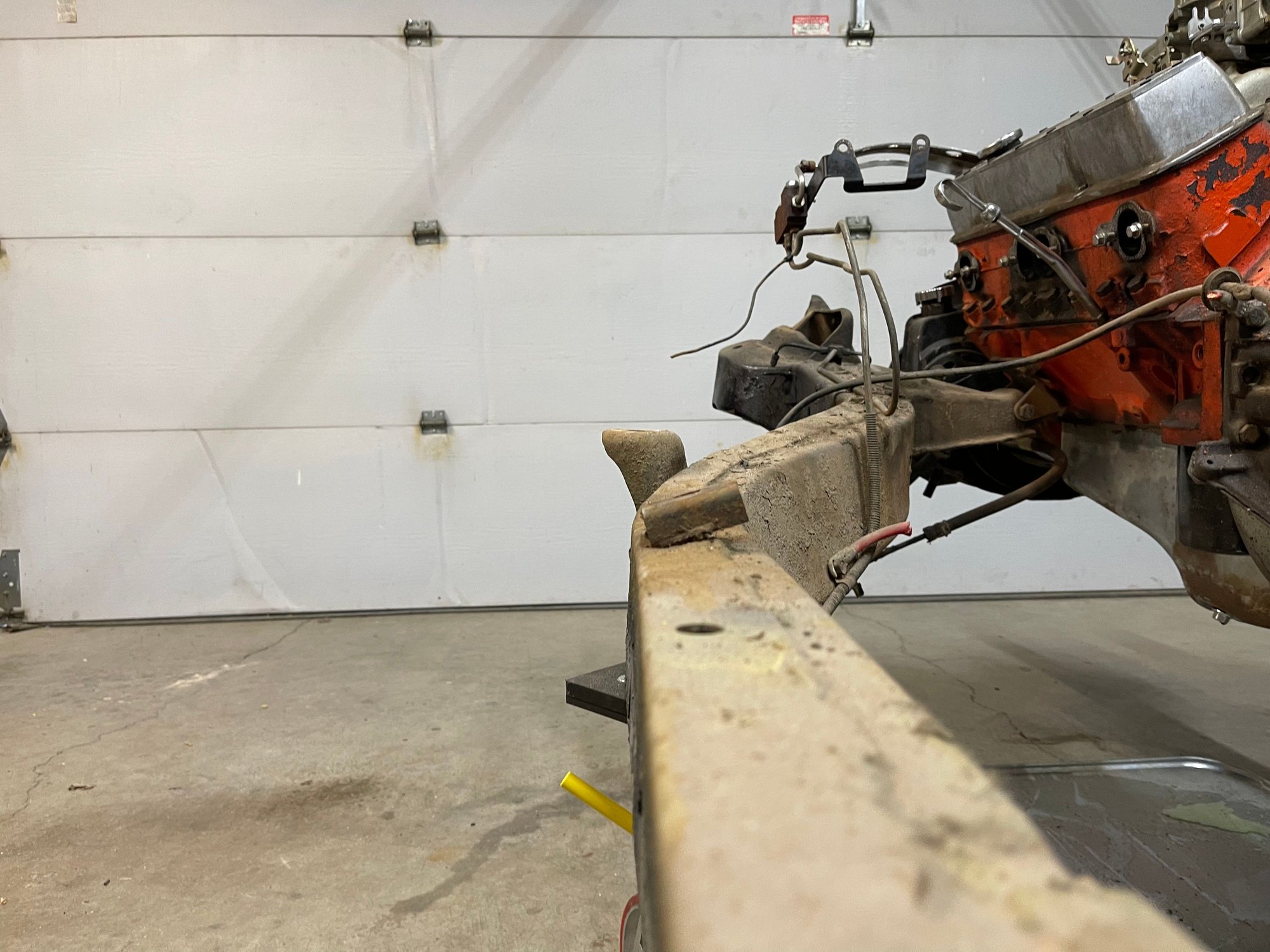

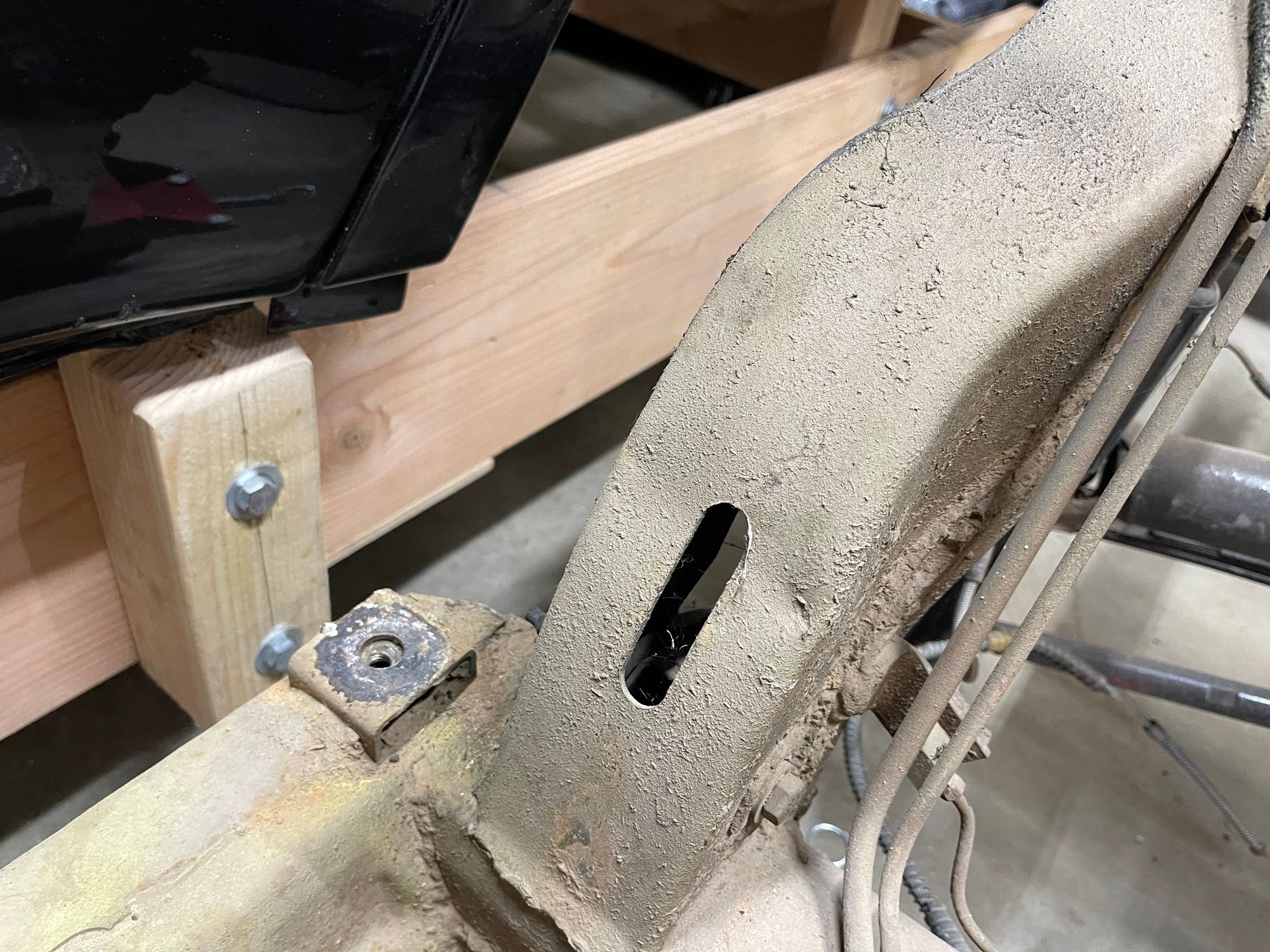

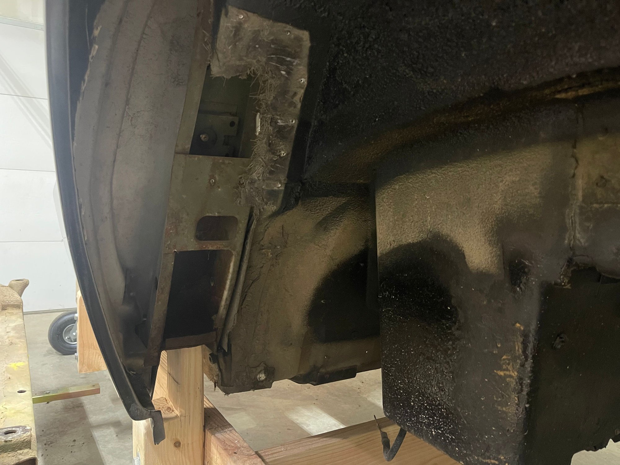

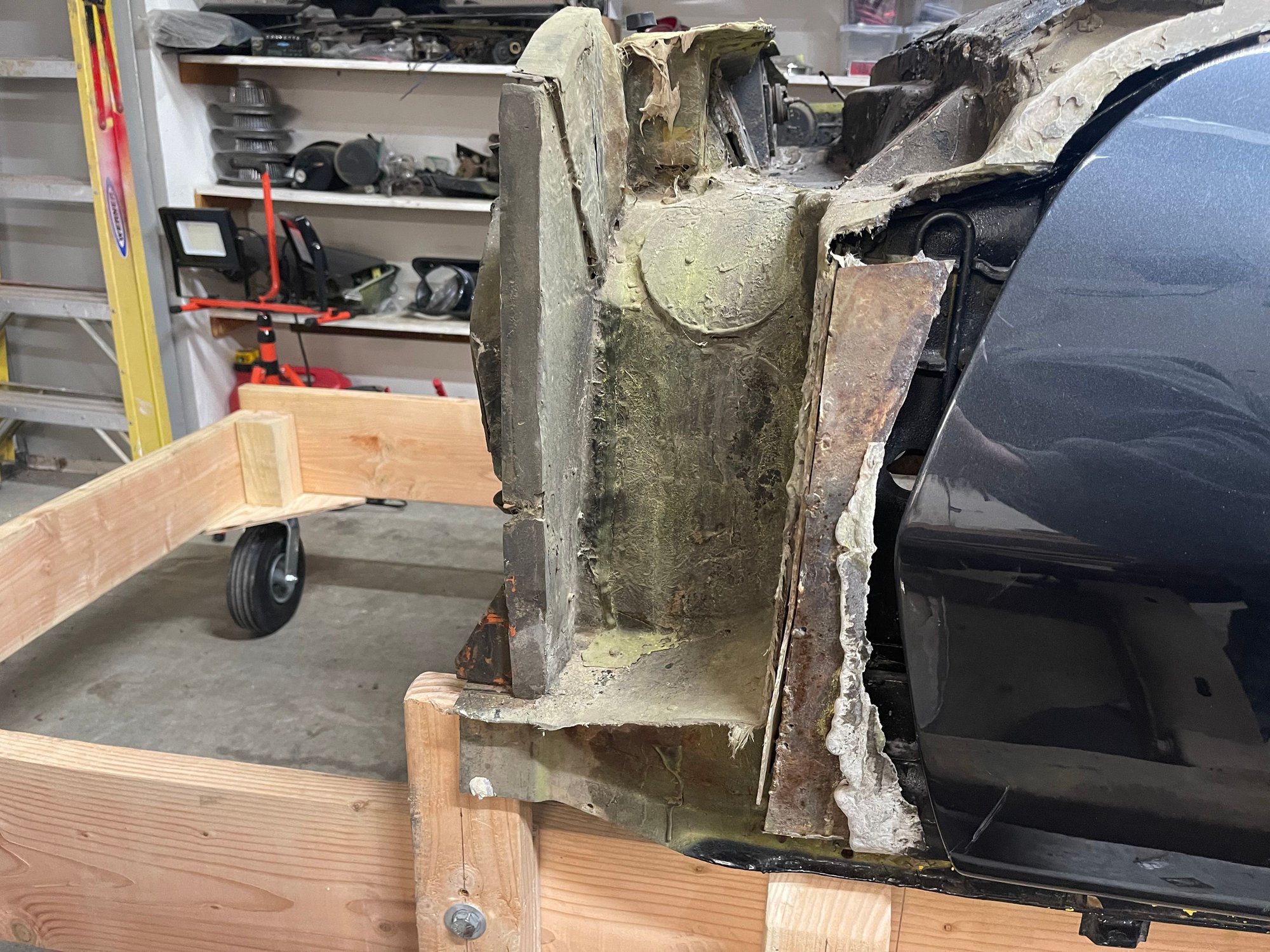

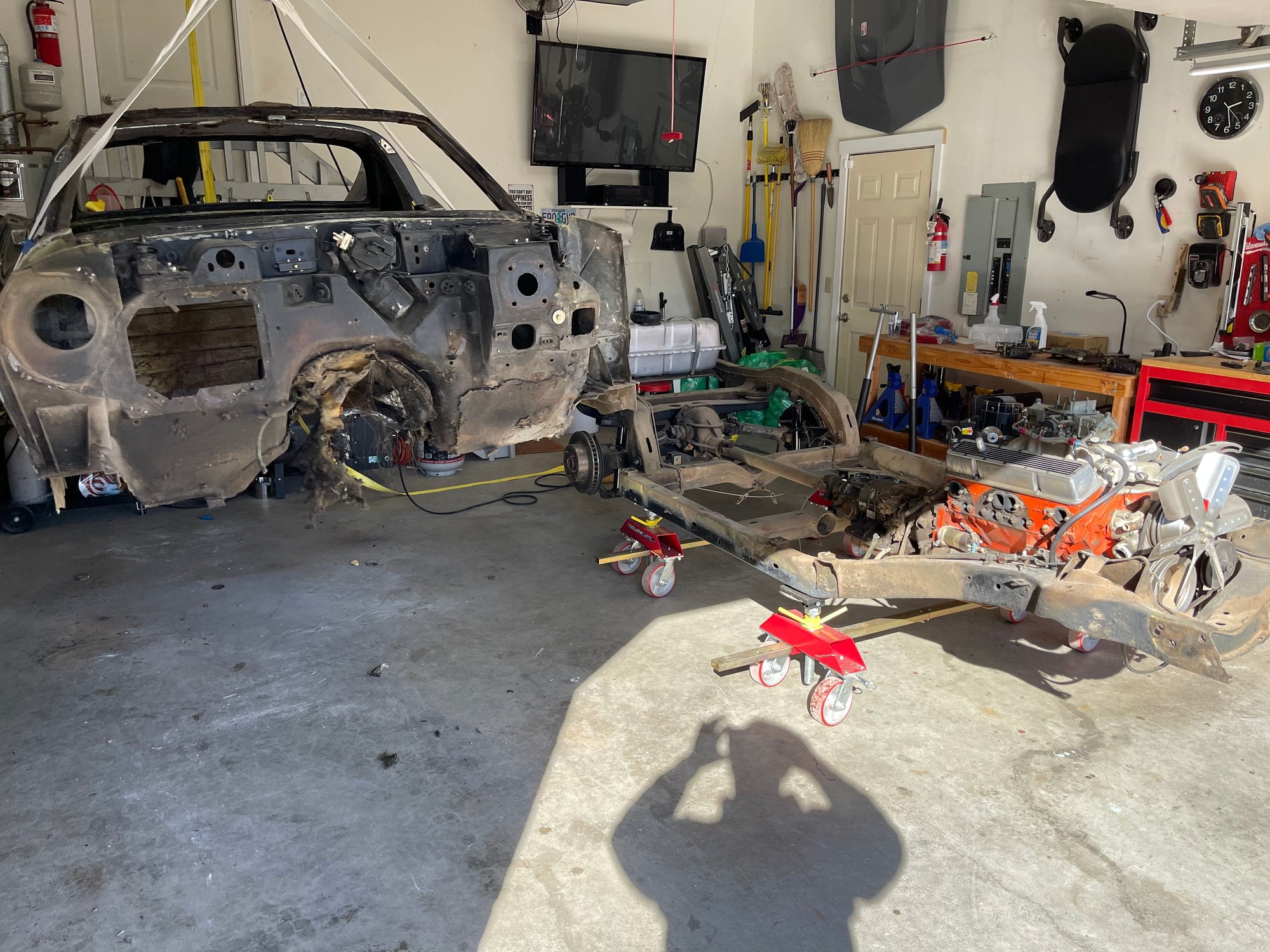

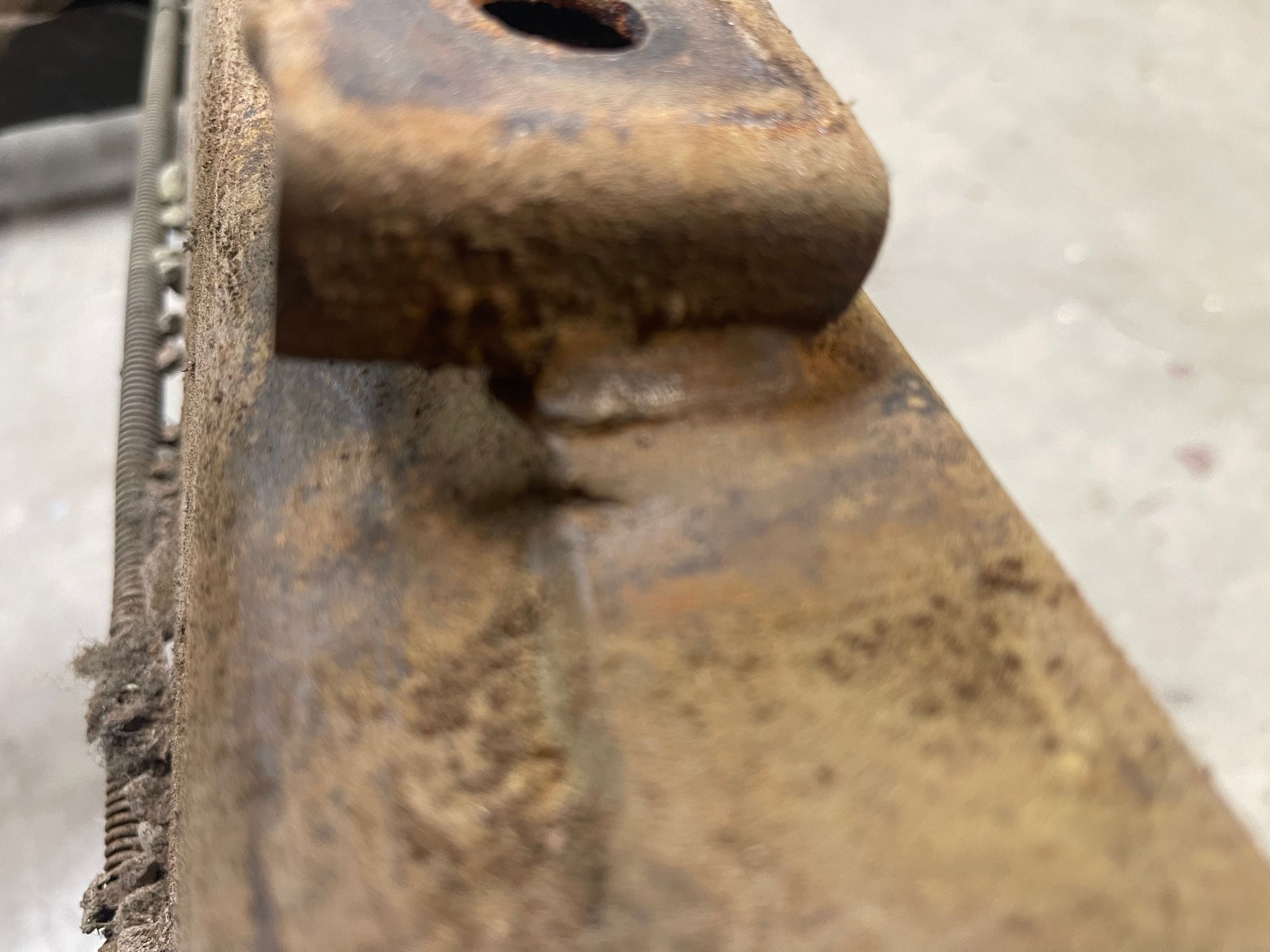

Hey everyone, been awhile. Well I have been a little busy but I don’t think any of it is good news, but I am not an expert as previously revealed. When I pulled the front clip it was obvious that it was replaced for not a good reason. When I went to remove the body bolts the drivers side 2 was leaning to the outside. Got the body off the frame today and I think the bad news continues. Look at the pictures and please give me your opinion. Any advice as always is appreciated!

Interesting damage. I am no expert by any means, but I’m not sure how that would happen from an auto accident of any kind. Could that be from the birdcage getting pushed into the frame?Hmm??

I would recommend you conduct a full dimensional measurement of the frame to see where you are at. You can do this yourself by building a simple tram gauge. All the dimensions are readily available in the AIM.

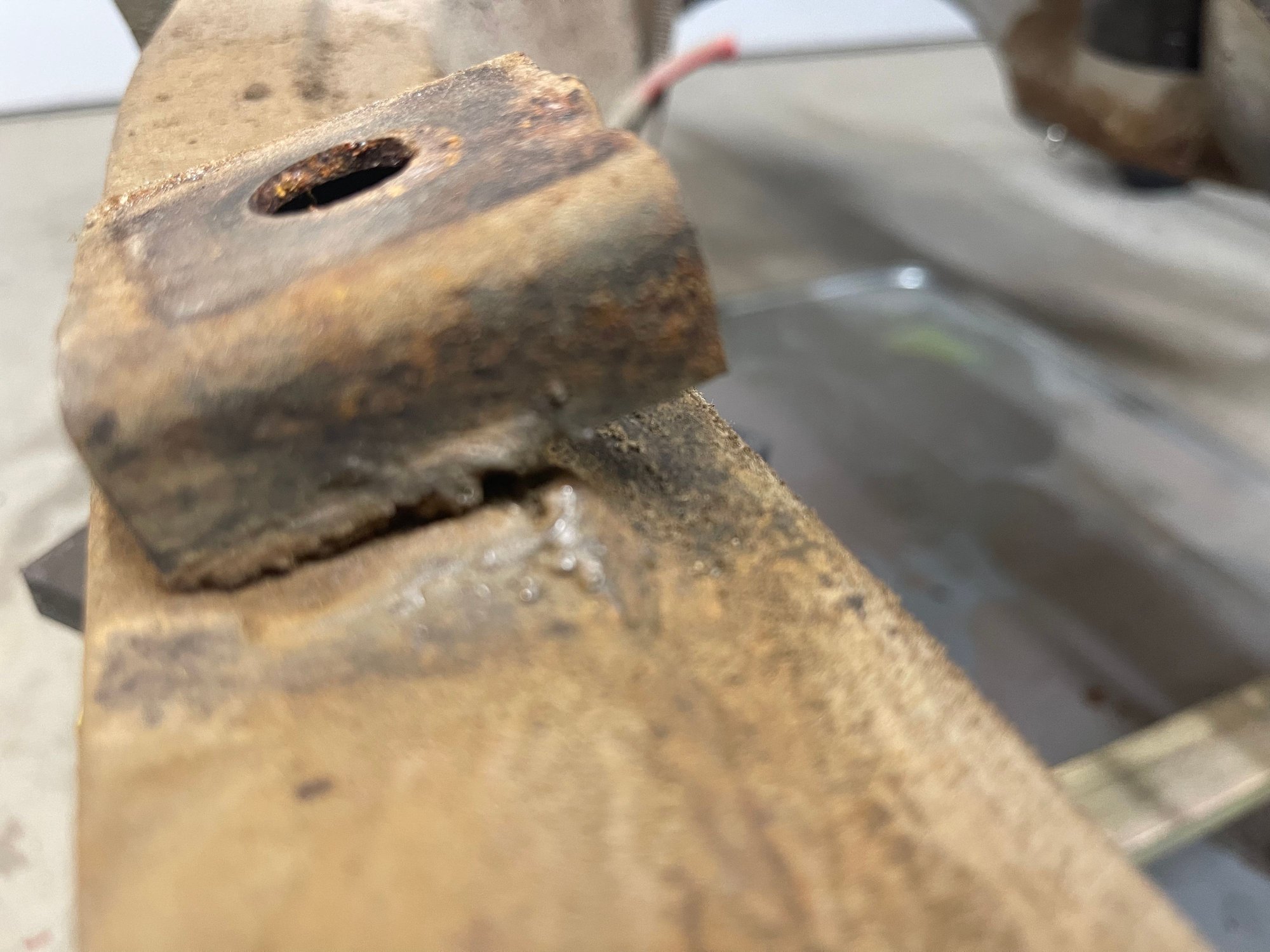

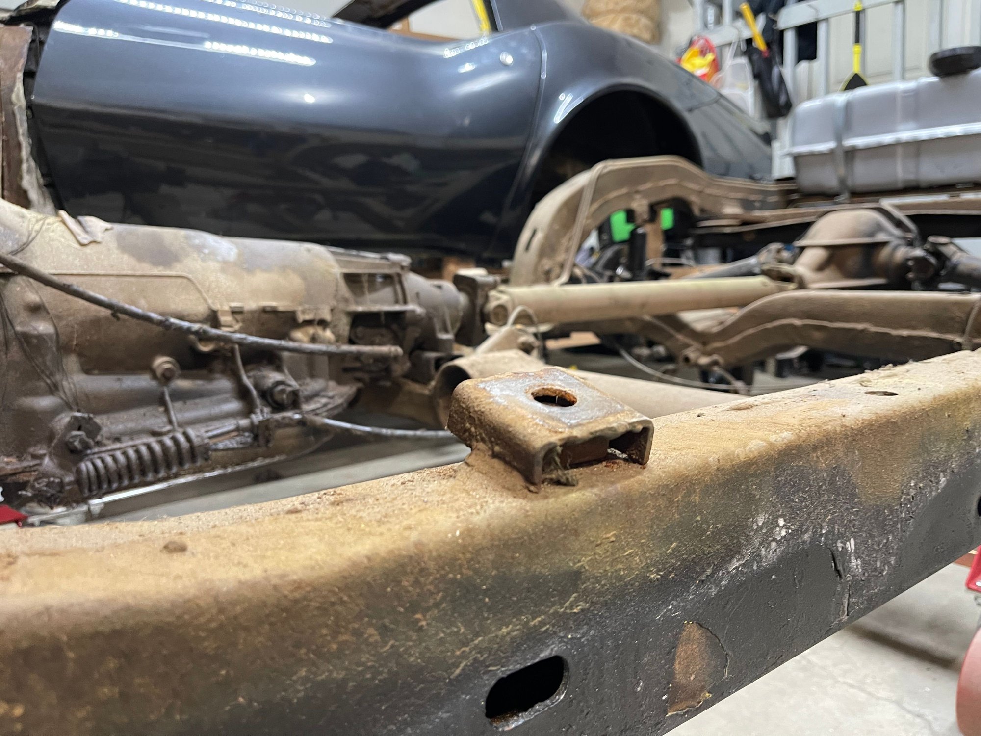

That frame looks fairly rust free, that's a plus. You were able to unbolt the body bolts without cutting them, that's a plus. That leaning no.2 pad, does it look like factory welds? Or has it been rewelded? That rear side of that pad looks like the weld never penetrated the frame. I have no idea about the dents in the kick ups, looks like someone may have been in there with a pry bar for some reason.
Looks like a factory weld. Does not look like weld penetrated on the right side. (Right being towards the rear). Also neither side was weld past the stitch in the frame.

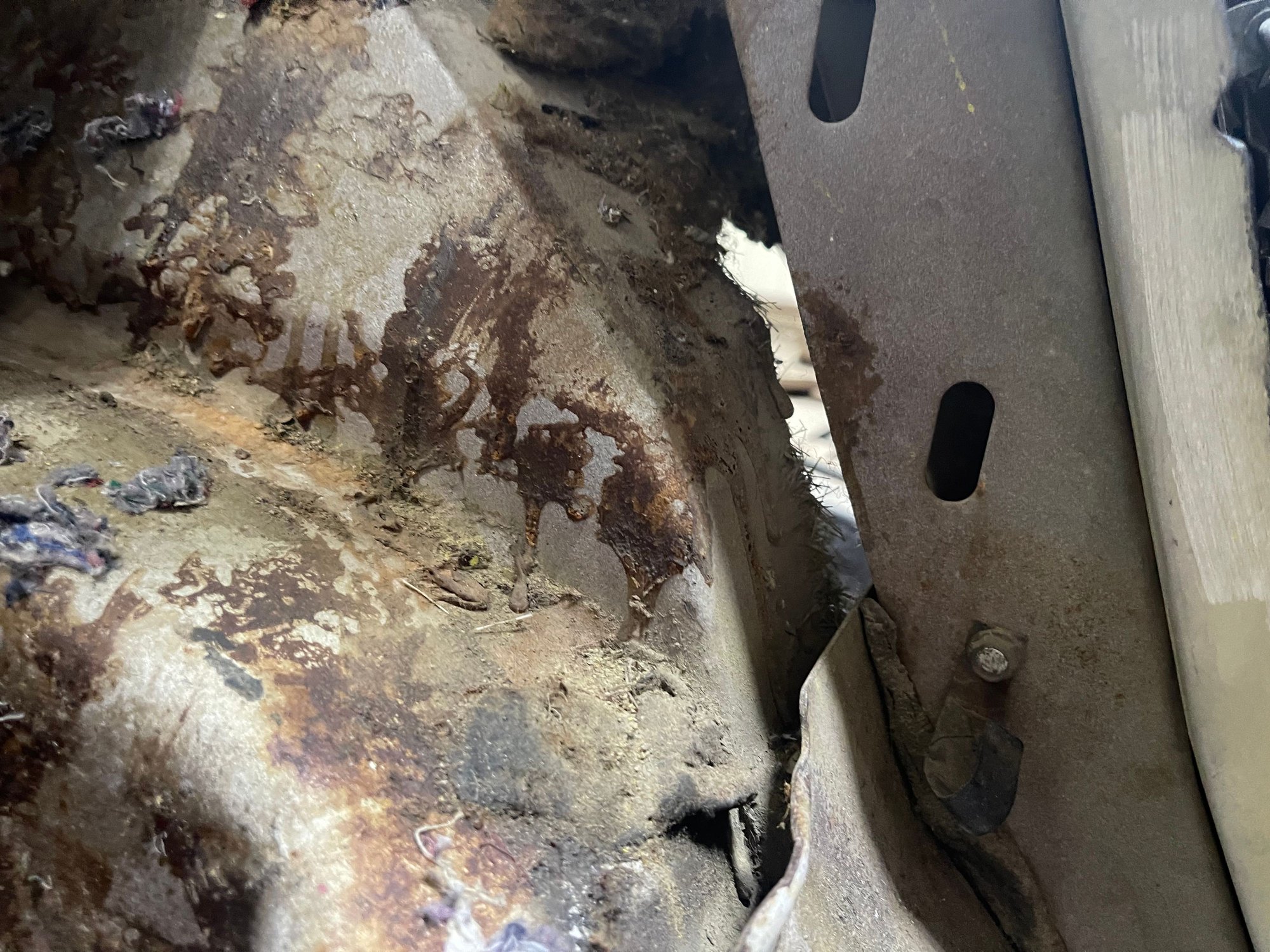

So here are some pictures of what I found behind the left rear inner fender patch also what was under the left side under the front clip. My guess is it must have got smacked on that side and that’s what led to the replacement clips and 69 doors. I will start with checking frame dimensions like 69L88 recommended and report back. Hopefully this doesn’t turn into a 14k dump run!
