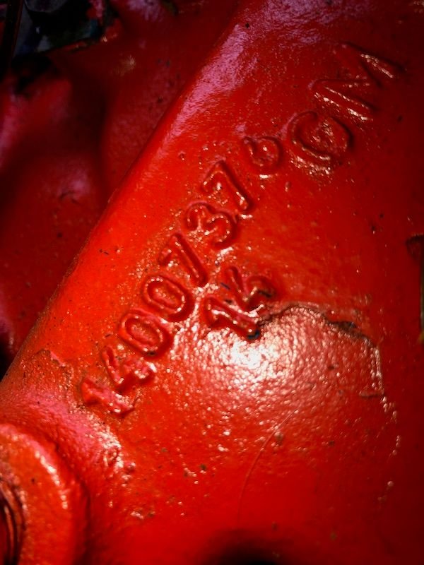

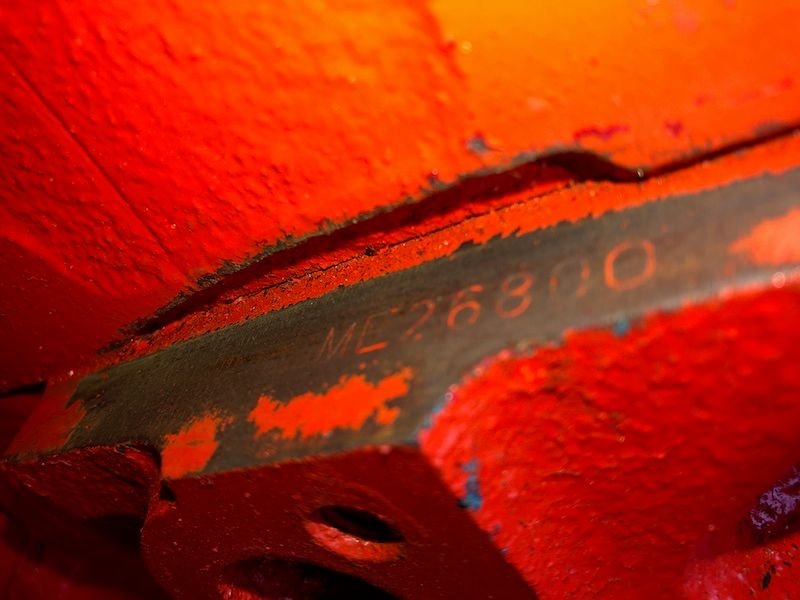

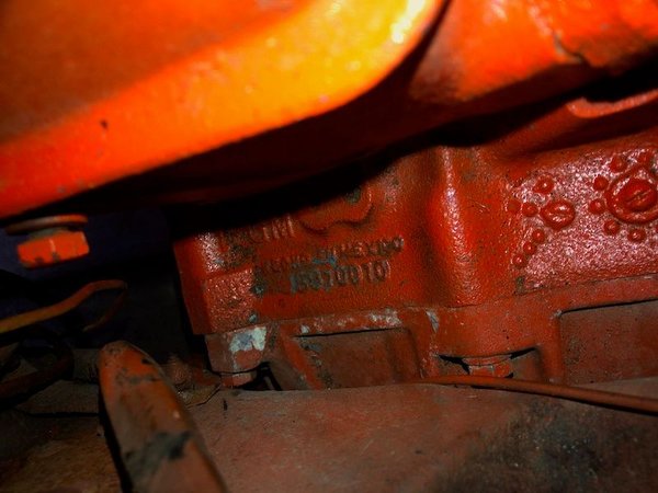

Tried to do some research on this and only get more confused. Here are some pics of the block ID and the stamp pad. I can't interpret the stamp pad, but that's not unusual for me.
The block ID is 3970010, made in Mexico. The intake is a 350 (1400737,1238 date I believe). This is supposed to be a '68 327 but I really don't know and can't say for sure. I saw a print out that said this block was used from '67-69, however the '68 had the large journals in stead of the small like the '62-'67 had. The only difference is the piston travel (?) from the 350. So the block id is a 350 (Mexico), intake is a 350, so how can one determine the crank size without tearing the motor apart, which I won't do. Want to sell it but would like to know what it is, think that would help as I don't want to be dishonest about it. I can't figure out the stamp pad. Hoping some of the tech experts could. I want to thank you guys for all your help and time and info on this. Hope some one can figure it out for me. BTW, the stamp pad is: ME26800 in case it isn't readable to you.

stingr69's Avatar
stingr69
Joined: Mar 2004
Posts: 7,473
Likes: 1,495
From: Little Rock AR
You can look at the rear crankshaft flange to determine the stroke.
You can stop trying to research the engine. Nobody ever documented Mexican crate engines. They were never used in production or warranty, only generic over the counter replacements. They were 350 cube, low compression base 350s. Any documentation you find will be for original production line engines, not for generic replacement crate engines.
