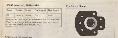

it is not a 327 unless somebody put a 327 crank, etc in that 350 block.

This should help.
