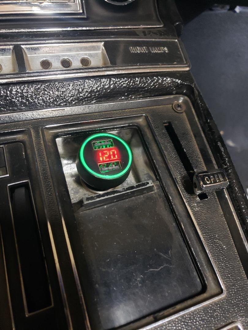

That's what I did too, but I got one with a built-in voltage display - instead of tearing the dash apart to convert the ammeter to a voltmeter.
Pictures? Thanks
Old Nov 15, 2022 | 12:41 PM
bradleyb66's Avatar
bradleyb66
Joined: May 2013
Posts: 789
Likes: 129
From: Los Banos CA
Originally Posted by red topless gator
Pictures? Thanks
Here you go:
Here's the link to the one I bought (I have no affiliation with seller or manufacturer), but I'm sure there are other similar ones.
Amazon Amazon
