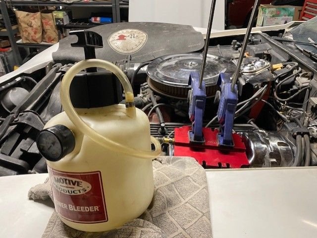

Dammit... the connections are not tight at the proportionate valve.

I think the previous owner did not get the brake line fittings tightened down all of the way. I am going to let my son make some progress on his own to see if he can figure it out. Its a good way for him to learn how to wrench on his own.
This picture?

^^^^ Yep, that's the one. If you need to use them for fuel or brake fittings, they work great. As I'm sure you know, if the PO used stainless lines, they can sometimes be much harder to get a seal. And good on you for giving guidance and letting your son make some progress!

Yeah, he could not figure out how to get the rear calipers loose where the impact could not get in there with a socket. I told him get a box end and start whacking on it. That worked fine for the passenger side. The driver side it was not fine since the leverage was in the other direction. So thats when I get out the ole breaker bar. He got it on there and put all of his 205 lbs of power on it then whoop loose bolt. Success!
Really thats the part I do not like. At least the mess is at the minimum after I forgot to air test using the motive bleeder. Instead I filled it full of DOT3 and started pumping without checking to see if there were any leaks. Well I found the leaks. GREAT! Now, my garage floor is covered in DOT3 fluid. Luckily there are enough shop towels and more DOT3 on the shelf.
