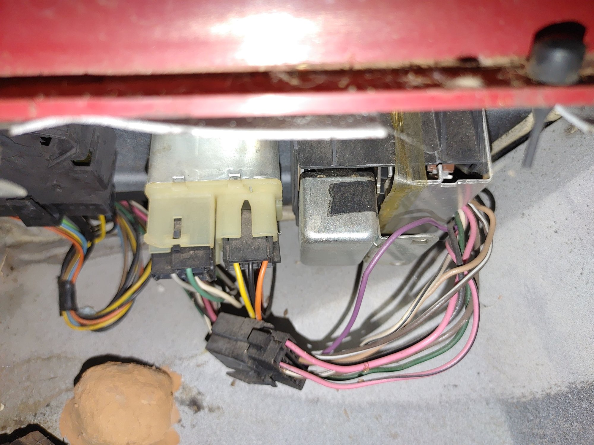

This is the passenger side compartment behind seat

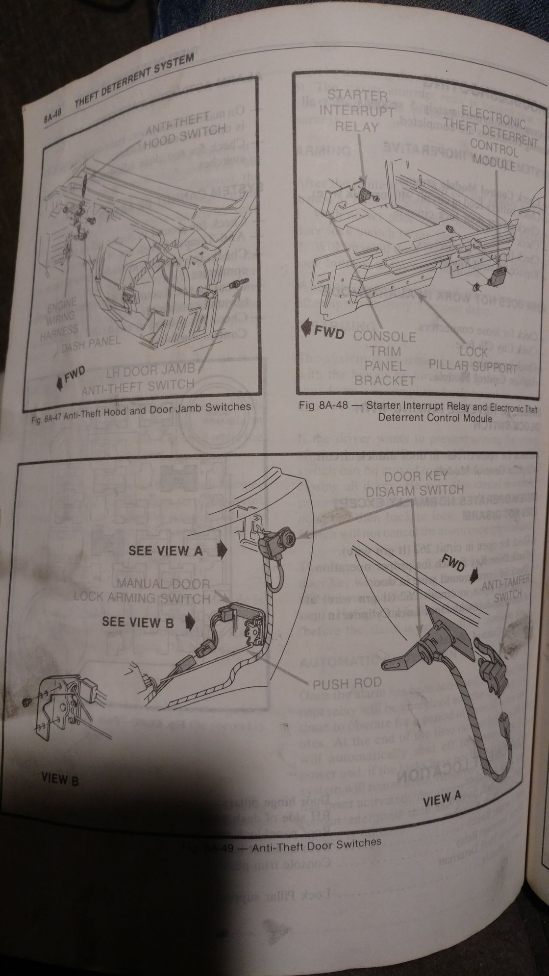

Update .. I removed black and white wire from starter disconnect relay plug ( which is part of the anti theft).... I test voltage on the purple and white wires both are receiving 12 volts with ignition on ... Plug it back into relay .. Starter does click ... My question is on the starter .. U have the larger bolt that feeds it power i assume .. Then there is the starter wire .... At what point should i be receiving 12 volts at the starter ? .. Testing from the large bolt im only getting 2 to 4 volts with ignition on ..i have no one to try and start it at the moment.. Is there somewhere else between the anitheft relay and the starter i should be checking voltage ?

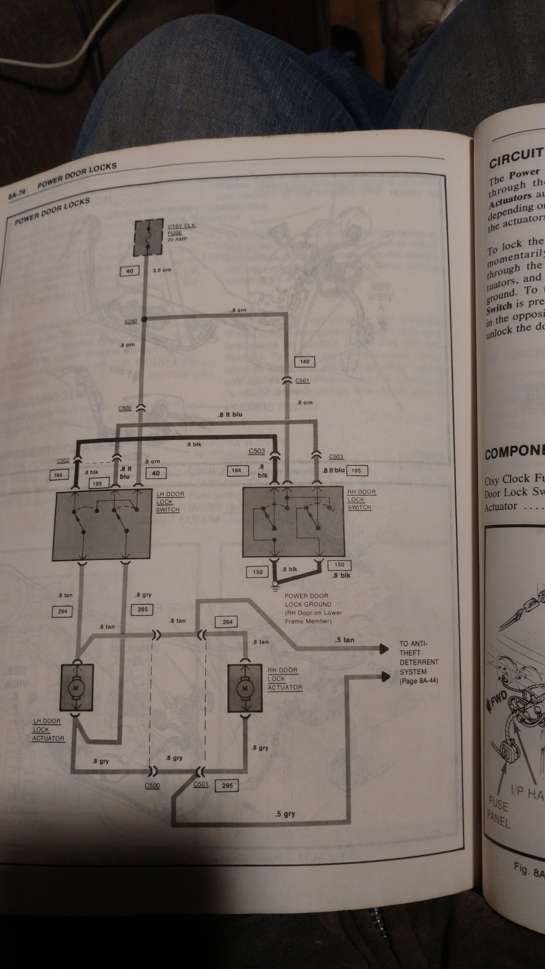

Old Nov 29, 2022 | 12:13 AM

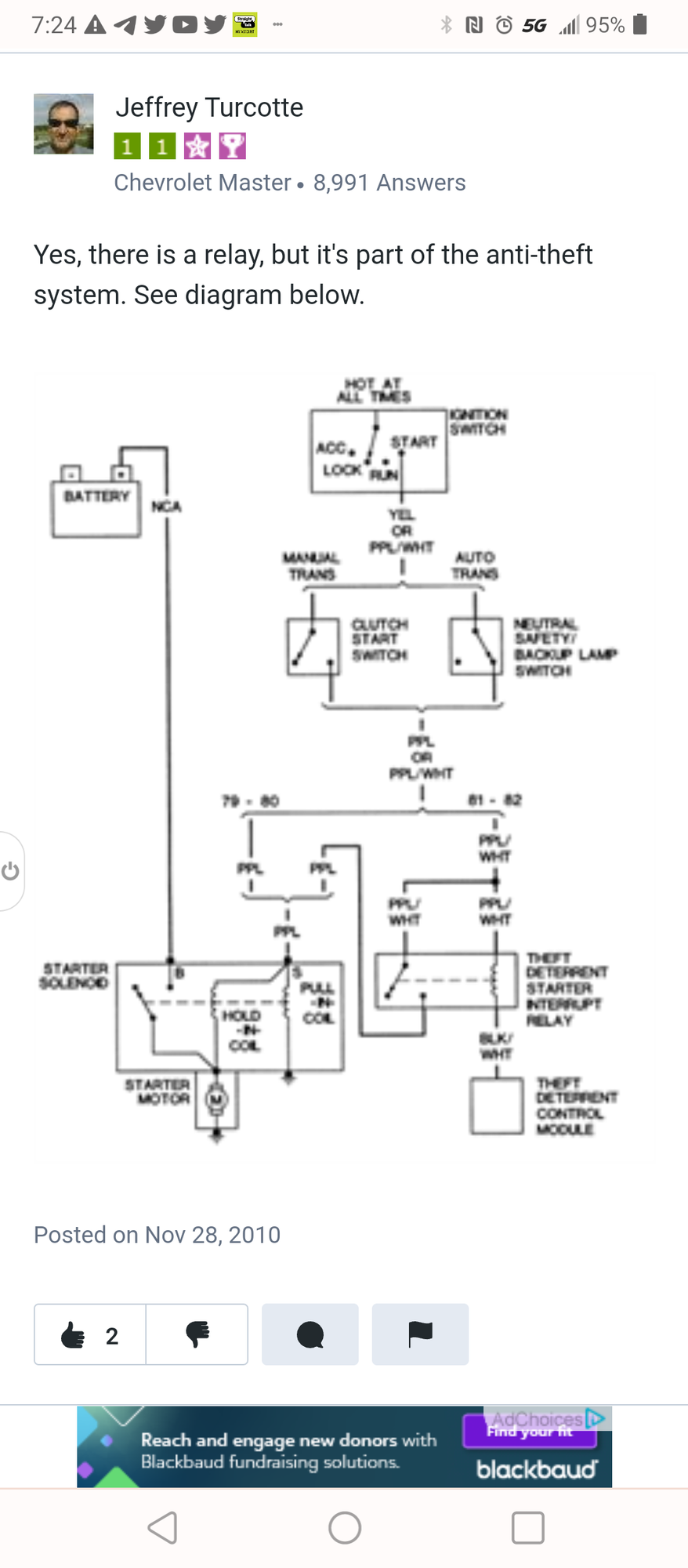

Originally Posted by bw81
This is the passenger side compartment behind the seat
Relays in the jack box:
Outboard to inboard
Delay wiper relay
Power antenna relay
Theft deterrent electric control module
Now go to Papawana and get an '81 schematic.

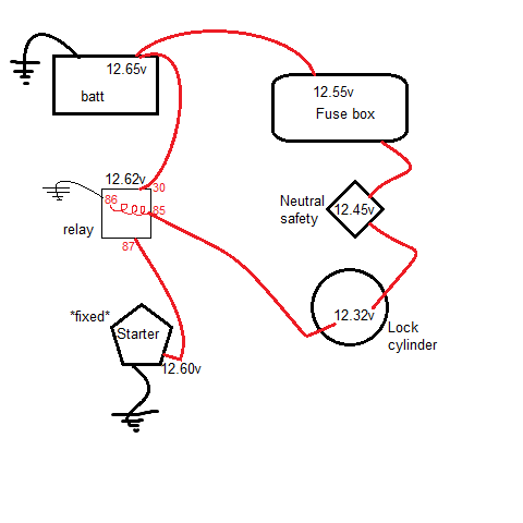

I'm not saying this is your issue. But this may be a future issue you may face, and also it may serve as an alternative to bypass your current situation, possibly.
Most cars use something like this to trigger starter solenoid. The battery feeds a fusebox, neutral safety, lock cylinder contacts which are thin, and this can result with significant wear in the lock cylinder contacts as well as voltage drop which may create difficulty trying to move the starter. This is a common problem for older vehicles.
This is a simple fix to bypass the lock cylinder and fuse box while still keeping the circuit in effect and utilizing any theft protection it may offer separately from the solenoid current driver. You can add a general 40amp relay as shown below which runs a short wire directly from battery to starter, using the lock cylinder ignition circuit as a trigger.
That will relieve the lock cylinder circuit from the current draw of the solenoid, which while it isn't much, is still significant and troublesome to many types of old vehicle
thx was going to trace wires and see how they were routed
