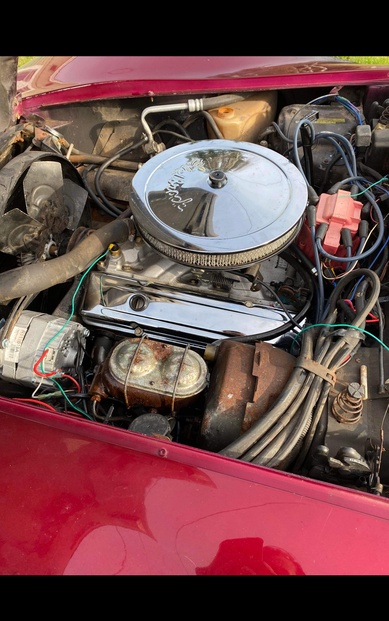

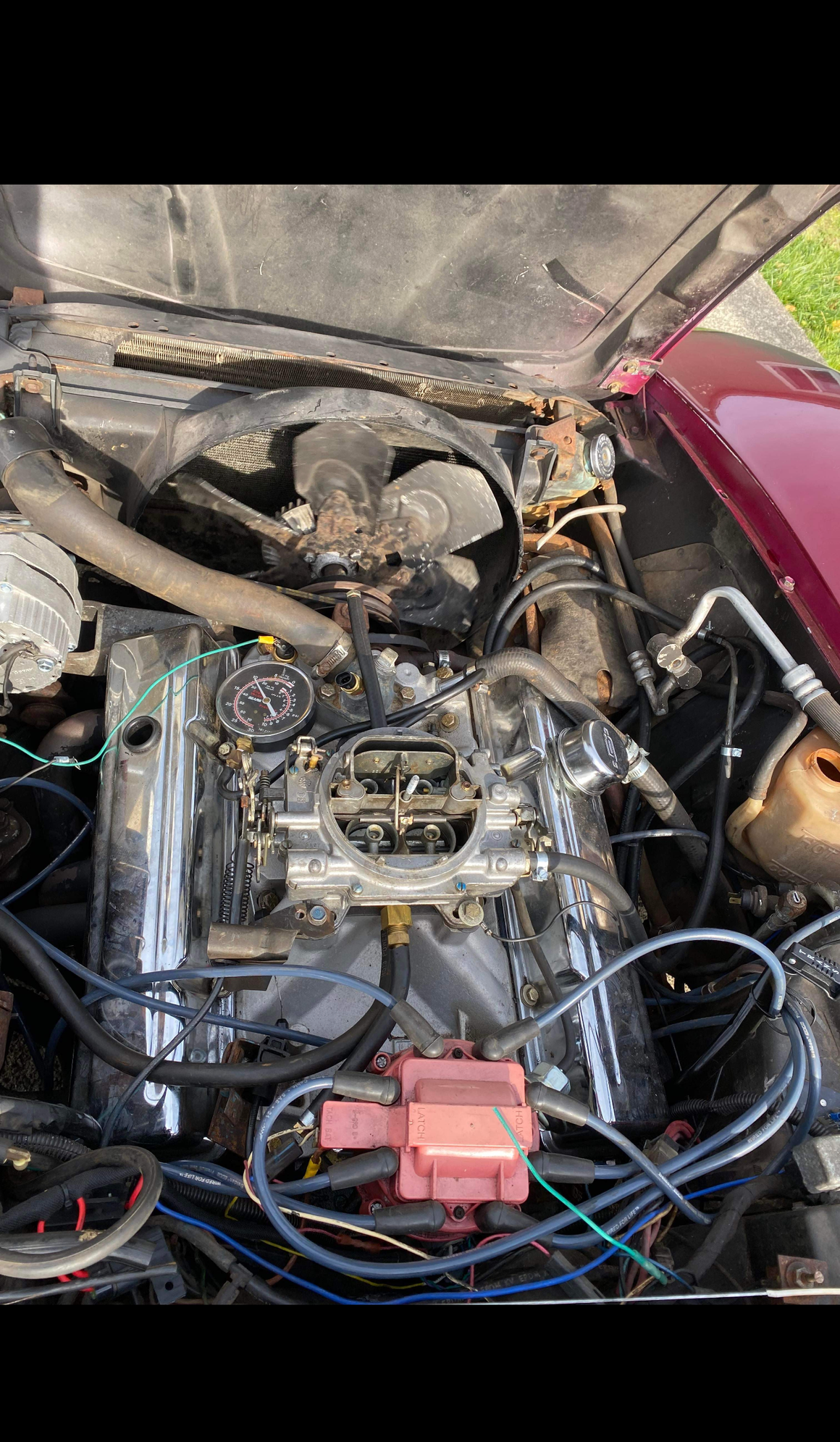

the previous owner dropped a new 700r4 trans in it, and put a new starter and alternator along with a few top end engine parts. It also came with a Holley Sniper EFI that he says has a blown fuse in it from a wire touching the headers.

For the clanking. check the front universal joint on the drive shaft.
For your A/C, it appears your compressor is missing.
You're missing some seals around your radiator. These are critical in hot weather.
Steering wheel play can be from a bad rag joint. Can be checked visually.
