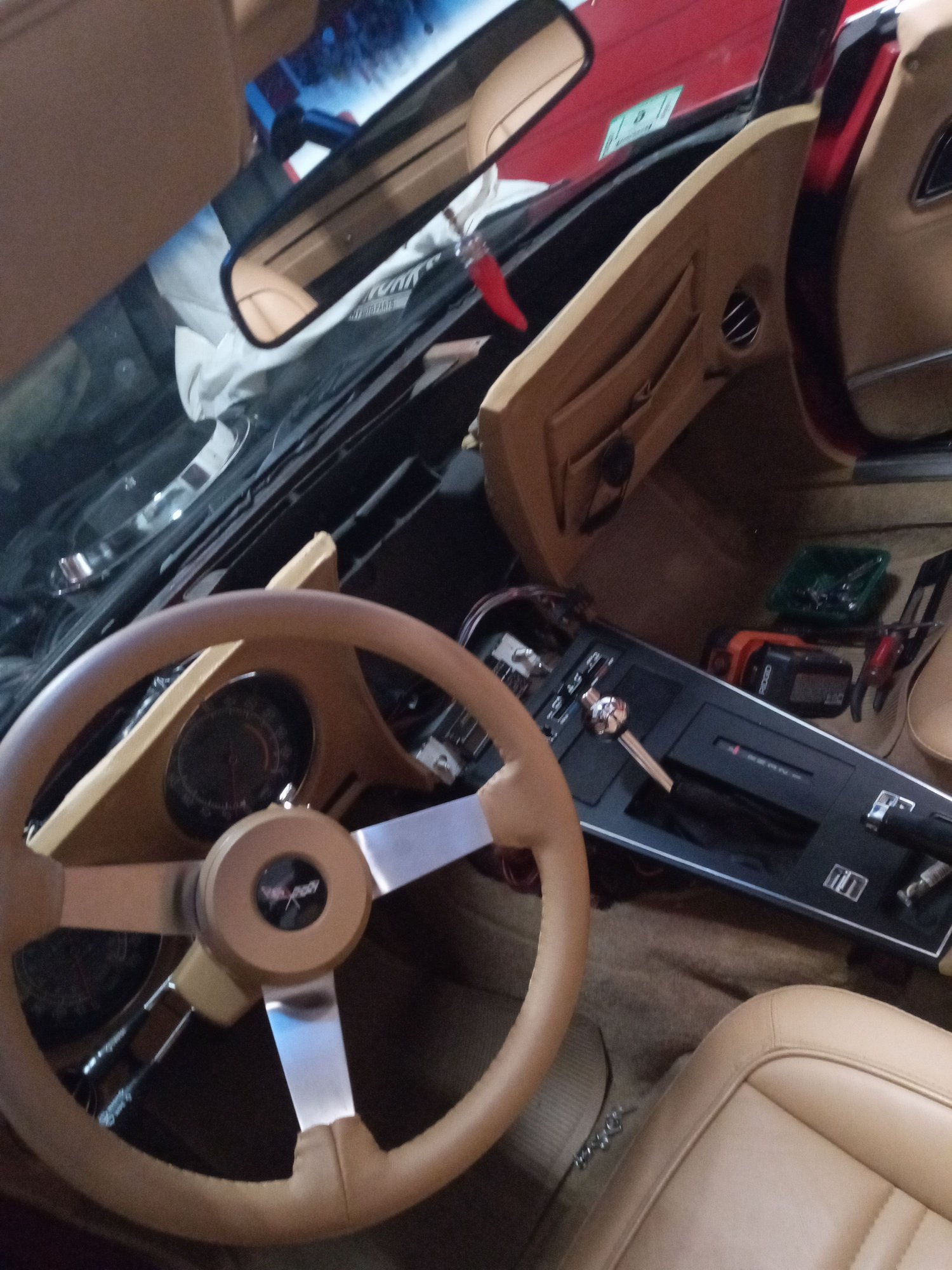

I replaced the lense in the center cluster and removed the upper dash pad as well. Since I had everything exposed I figured I replace all the 194 bulbs. I thought about going with LED's to make it brighter but some of the threads I read said don't bother. The new 194 bulbs have better filaments and are a little brighter. I wanted to ask if those that did replace the old incandescent bulbs with LED's, if they had any problems with them? Are the newer ones dimmable and is the added expense worth it? This is something that would probably benefit my son more as he will inherit the car one day and I never drive it at night. Just thinking it looks like a possible upgrade while I have everything exposed. Thanks.

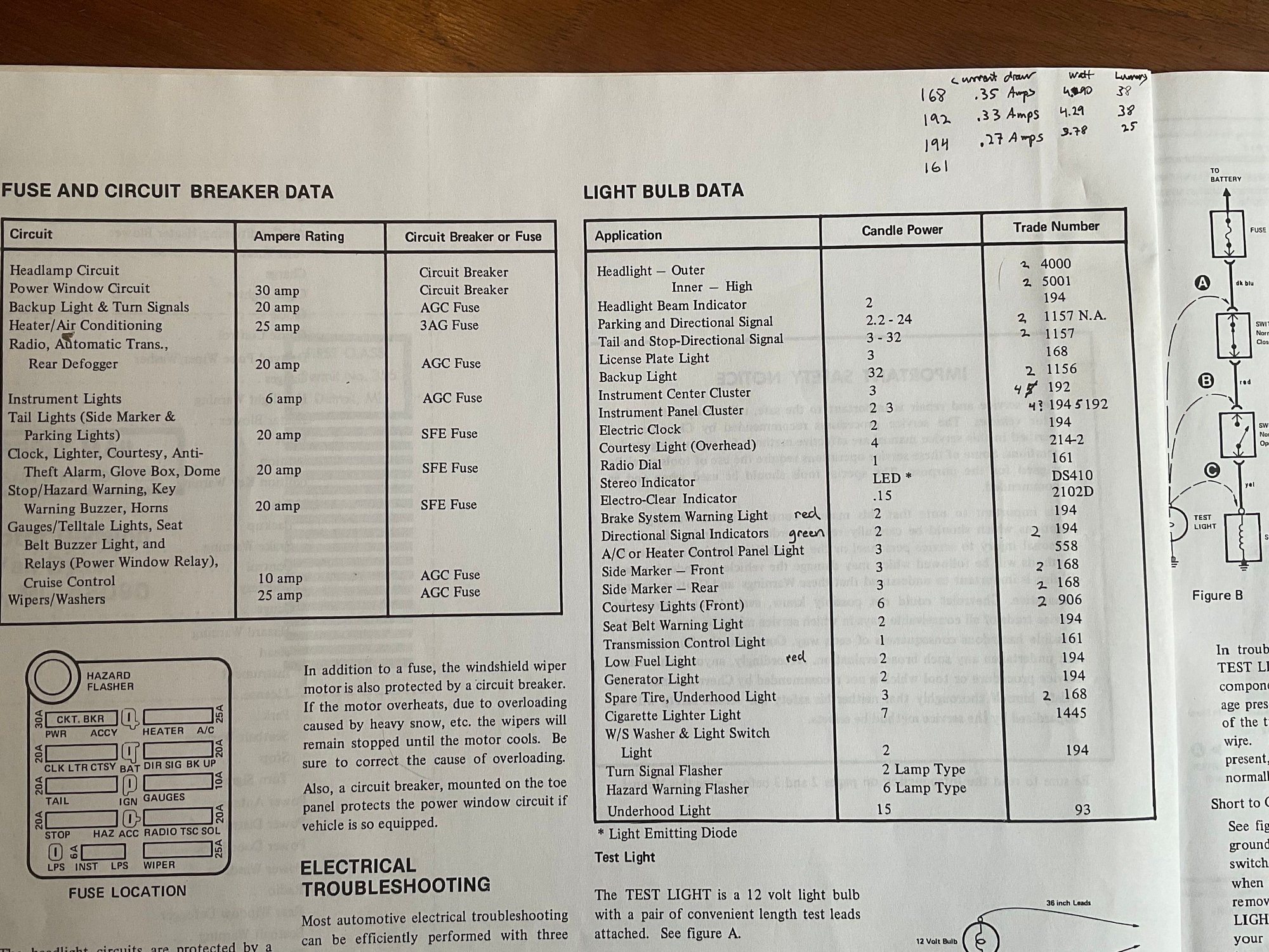

For 78-79 (not sure about other years) 9 of the dash lights are 192; the rest are 194, except the the heater control light is a projection bulb(558). 192’s are 3 candle power vs 2 candle power 194’s. Good to double-check the AIM for your year.
Charlie
