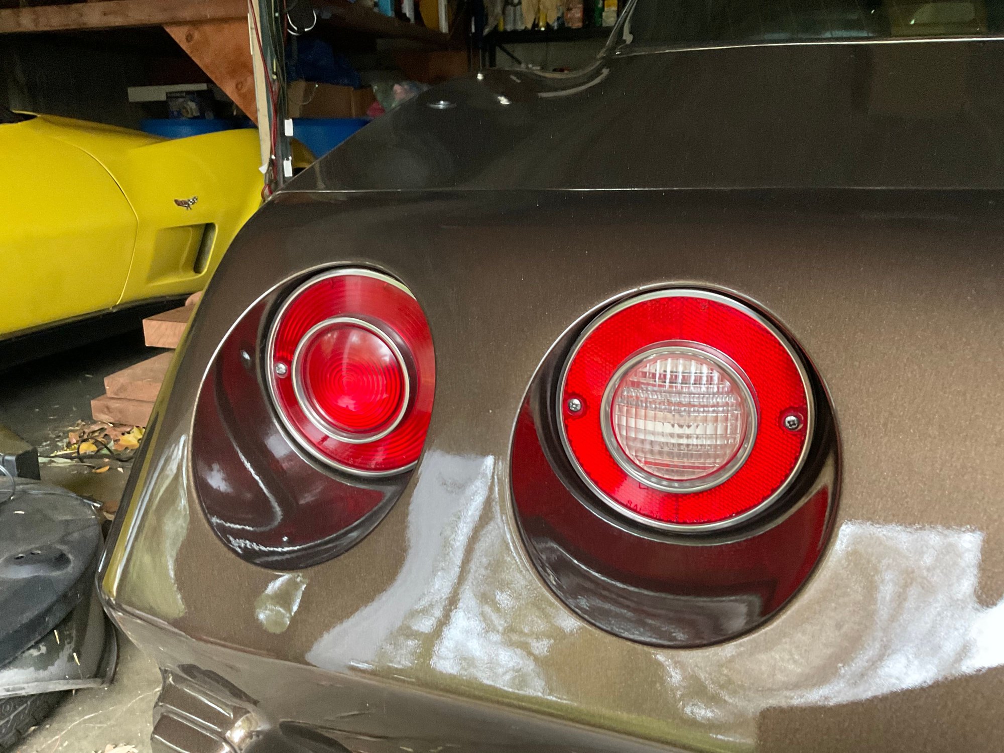

Faded taillights and emblems indicate lots of time outdoors. Lots of garage-kept cars out there with much less chance of rust in bad places. Total new paint job with little attention to getting the hood and doors aligned; most people fix the door gaps as well when they re-paint. Numbers matching for a 79 doesn’t really add value. You’ll have more fun with one that’s had a higher performance engine swapped in.
Charlie
Original 78 taillights; back-up lens on a garaged car will look clear-white. Avoid or expect a big discount for opaque amber-yellow.
