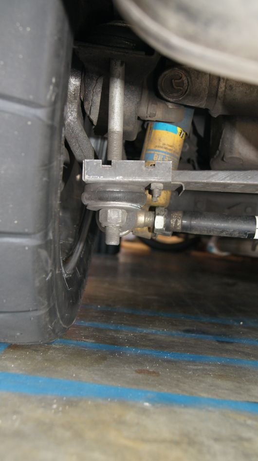

Originally Posted by cagotzmann
What backspacing on the wheels that required moving the parking / emergency cable.
I have 18x 9.5 wheels with 4.75" Backspacing and didn't need to modify anything. same 275 40R 18" tires.
They are 5" backspace or 0 offset.
https://www.summitracing.com/parts/are-vn5158961
The tire fit but had very little room until contact. I'll post a picture with the bracket removed showing how much space is there now.

ddawson's Avatar
ddawson
Posts: 5,738
Likes: 644
From: Lincoln, CA
A few pictures. Shows the small spacer just to move the wheels out a small amount. Also how much space with the bracket cut "not welded LOL"
