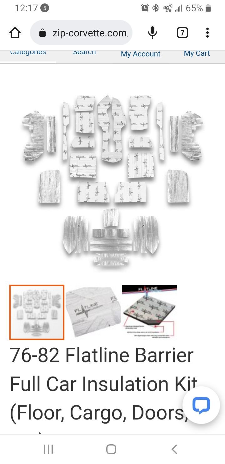

Has anyone used this, and if so what were your impressions? Considering spending gift card money on this. I definitely need to do something about heat in the interior of my car. Ceramic coating my headers helped, but not as much as i would have liked. My gift card is to Zip, but if the majority here has a single better suggestion, ill definitely give it a look.

I ordered the Flatline barrier kit for the rear storage area on my car. Can't tell you how disappointed I was. After spending another 80 bucks on sound insulation I purchased locally, I finally had enough to actually cover the rear storage area. I found the fitment was incredibly poor, leaving large gaps and no material at all for the back wall. The stuff I bought locally was far superior, but I had to cut it myself.
Wish I never wasted my money on this garbage.

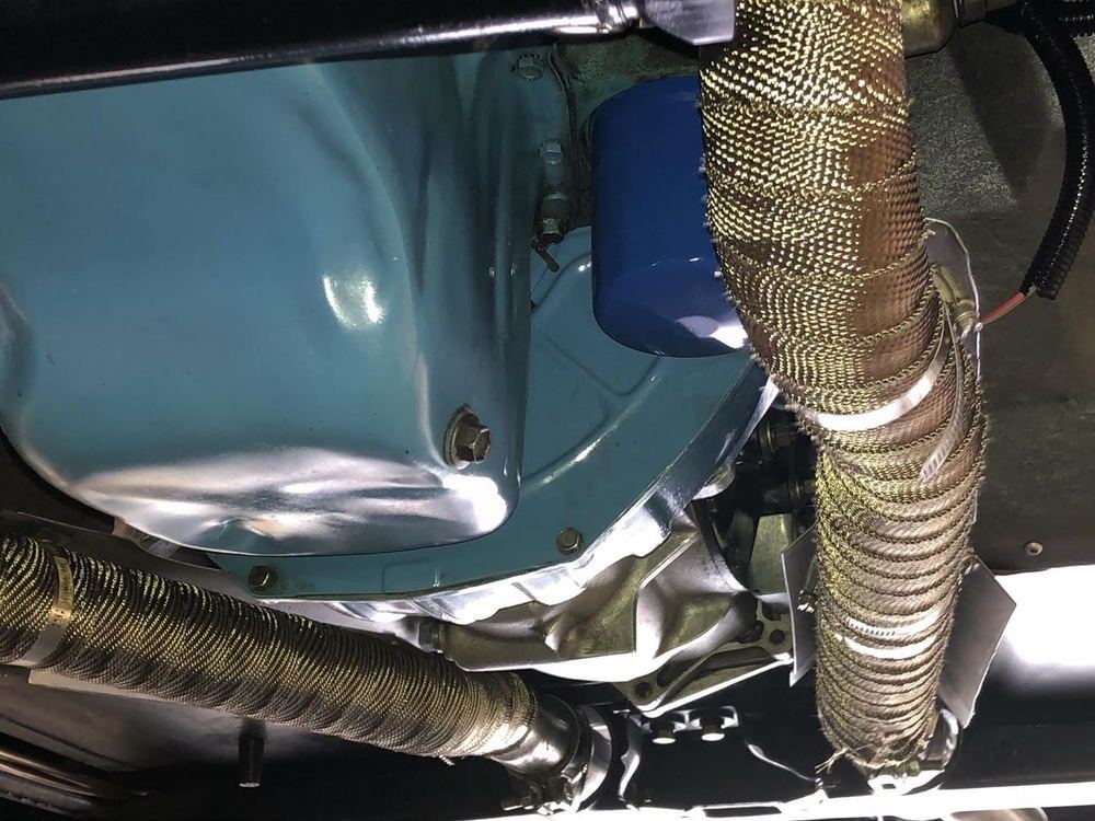

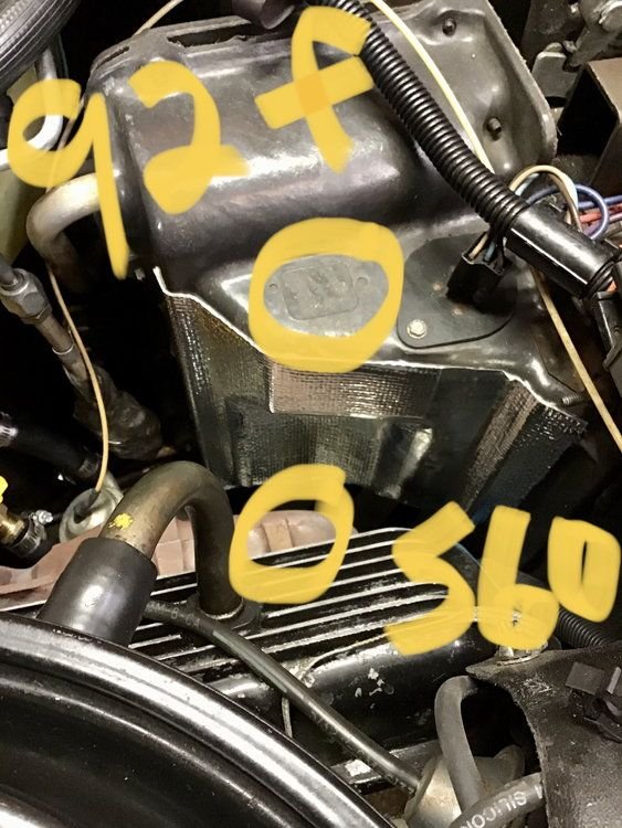

the best is heat shields and heat wrap. I think shielding heat before hitting vehicle makes sense
here is my thread on some heat..make sure hot water shut off working too
https://www.corvetteforum.com/forums...79-w-ac-3.html
