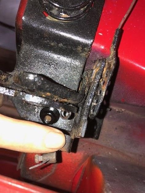

The '81 is the same as my '80. You can reach the latch by reaching up through the opening where the "gills" are and moving the latch down.
Once you have your arm up at the hood latch find the lever that opens the hood and pull down on it.

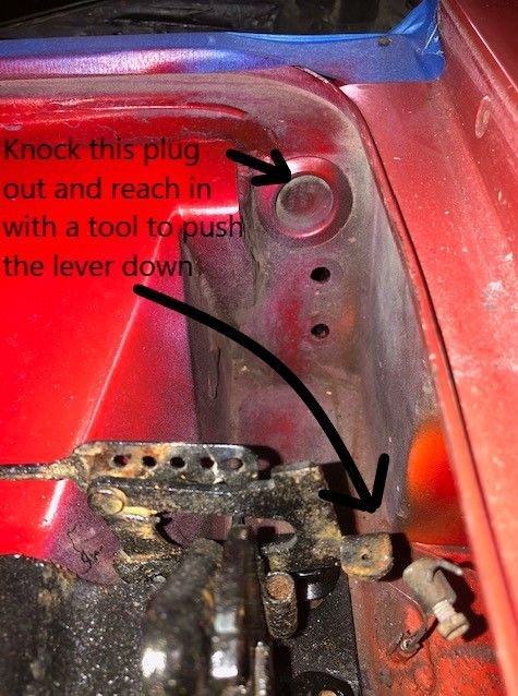

Another alternative is to go from the windshield wiper trough, knock a plug out and reach in with a screwdriver or something similar to push the arm down.

So, I was able to reach the latch from the gills on the side pretty easily the, only issue is the latch is seized it will not release. I have sprayed it with PB blaster in hopes that it will give but nothing yet. If anyone has any other suggestions that would be great!

Did you try prying them with a screwdriver via the alternate access ports in the videos I sent?

Wow! I wonder if something sprung inside the mechanism and has it jammed? If both are stuck, then unlikely that would be it.
Are both jammed?
Also, from the side grill, can you get a wrench or socket on the hook side on the hood and maybe unbolt the bar style hooks?
