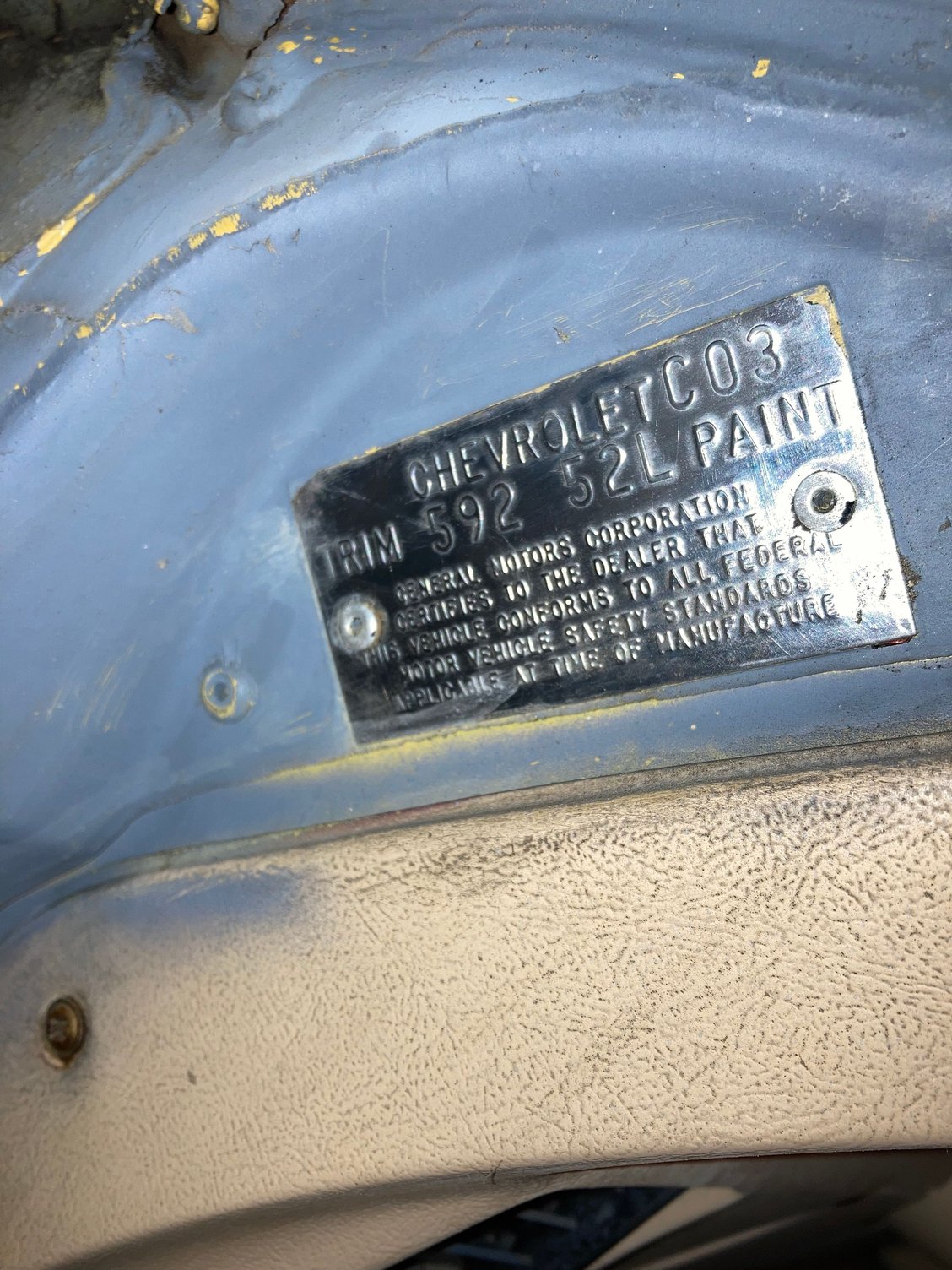

1Z37L6S417429 is my vin
and this is my trim tag

Well, this is certainly interesting Mike.
VIN shows a build date of January 1976 but trim tag shows a date (C03) of October 3rd.
Interior trim code 592 was not available in 1976 or 1977. It was offered in 1978 and 1979 as Light Beige, which seems to match the bit of interior shown in your photo. 592 comes up again in 1980 as Doeskin, but not offered with the Code 52 Yellow that year. Interestingly, 1978, 79 & 80 all offered Code 52 Yellow paint.
Do you know any history on your car? Could it have been re-bodied at some point? Stranger things have happened in Corvette world.
Cheers, Greg

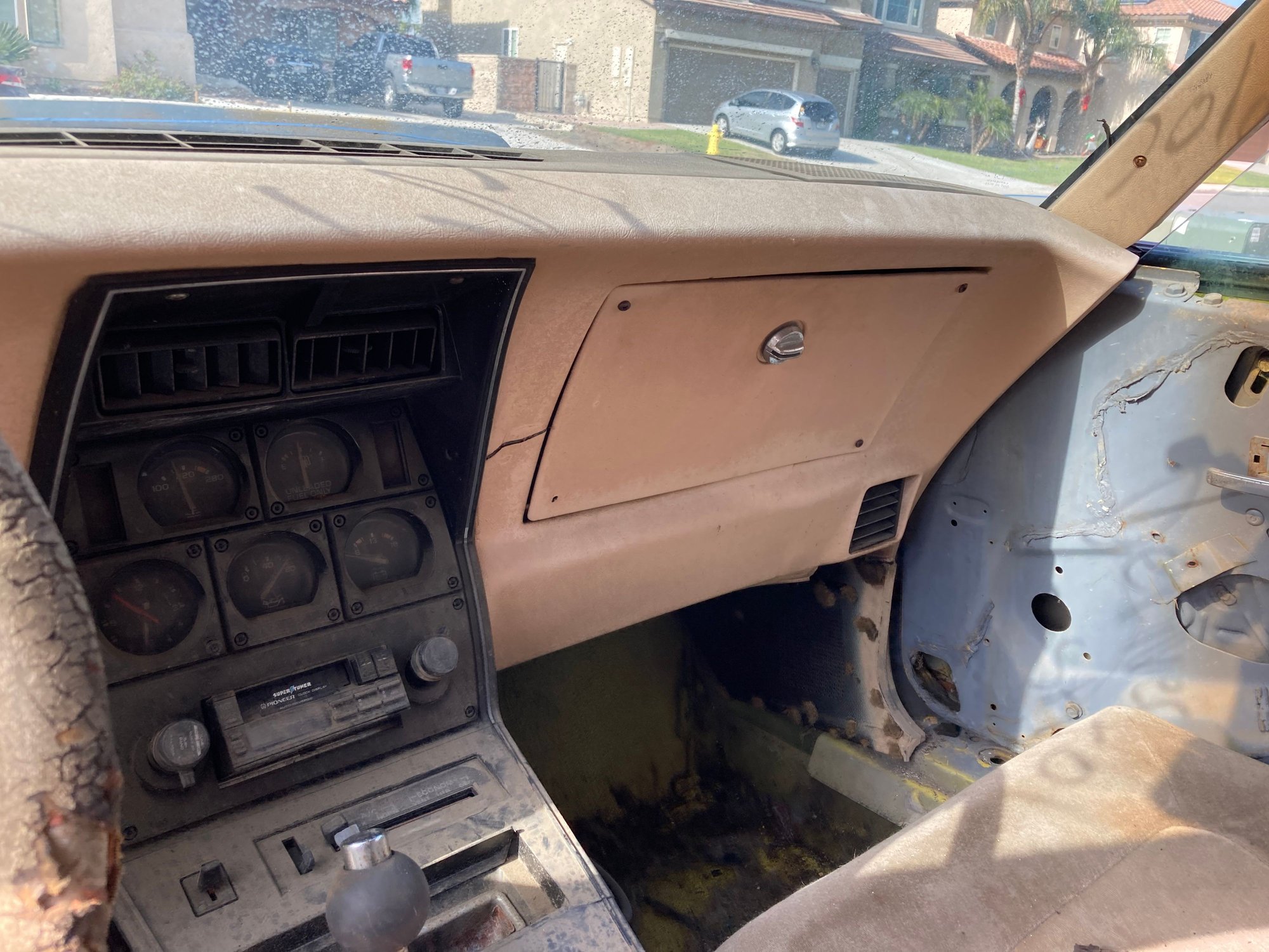

I haven’t gone to check or take pictures of my car since it’s dark out but I have looked at pictures and my gauge cluster is definitely from a 1978+ if that helps at all

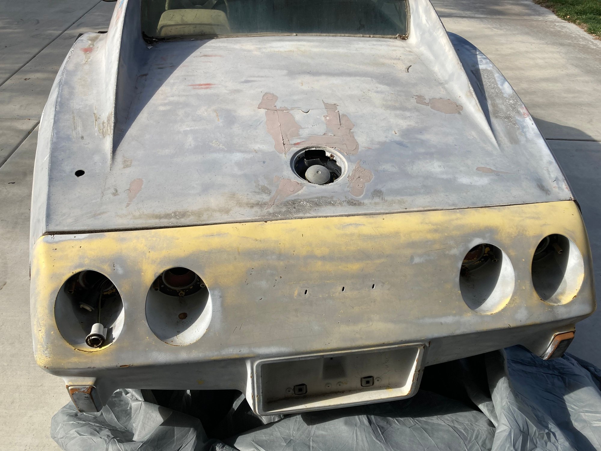

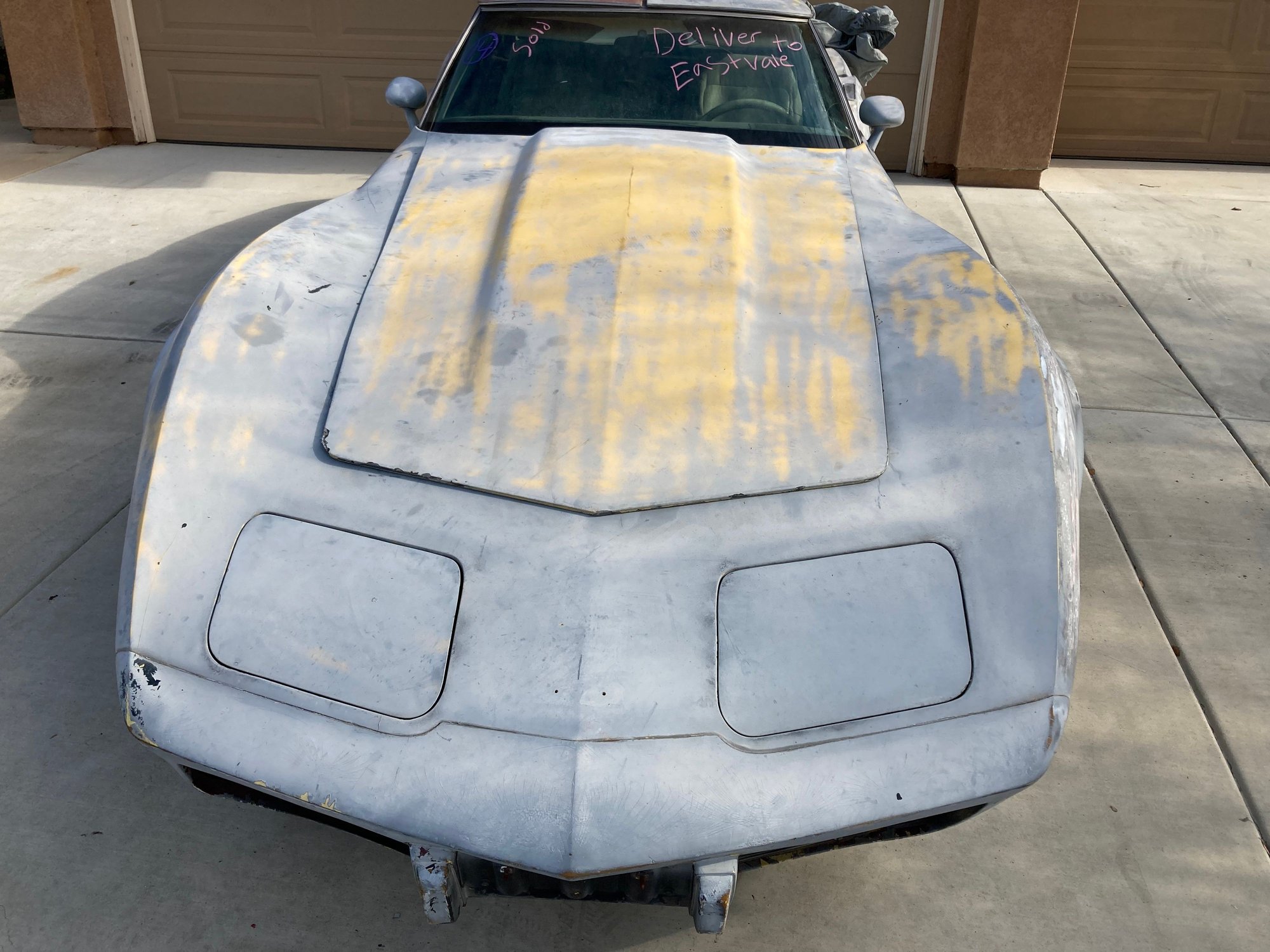

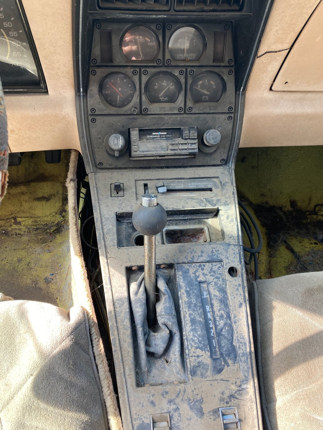

Originally Posted by Greg
Can you share a few pics of the body and interior? Maybe we can still figure this out.
let me first say my car is very rough and it’s definitely a project but here are some pictures

Hmmm?
Thanks for sharing the pics Mike.
Nothing wrong with a great project. I always like to see another vintage Corvette saved from the scrap heap.
It definitely looks like a '76 body (so VIN is fine) with a '78 interior installed.
As for the trim tag, perhaps the '76 had some front end damage and the front clip was replaced with the almost identical clip from a donor '78 (the two pin emblem hole above the side vent seems to confirm this), they left the '78 trim tag in place and it's just coincidence that both cars were yellow originally. If the '76 interior was tired, this could explain where the '78 style interior came from as well.
Good luck on the restoration!
Cheers, Greg

Old Dec 15, 2022 | 02:50 PM
CarterDawson's Avatar
CarterDawson
Joined: Oct 2022
Posts: 201
Likes: 68
From: Washington
That inside doesn’t look like a 76 or a 77. To me that looks more like a 1978 interior. But the outside looked like a 1976. Weird. Somebody that knows more can verify this. Maybe somebody made a effort at restoring it and only got to the inside? Weird about the trim tag tho. 🤔
