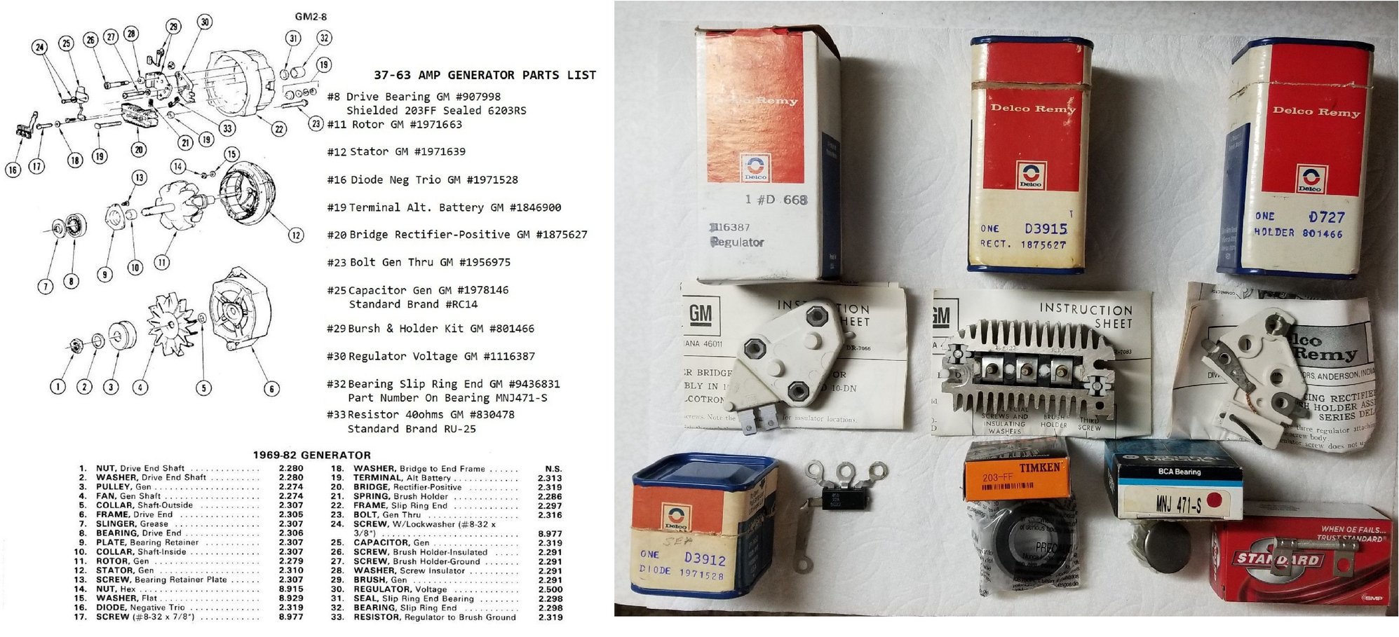

Believe it or not the 10si alternators amp ranges between 37-63 all used the same general rebuild parts...
Part numbers and leg work done,,,your welcome...
All U.S.A. made parts except the 40ohm resistor
My total cost for these parts $42.00
Last edited by bmotojoe; Jan 7, 2023 at 11:28 AM. Reason: Updated 1 Superseded Part Number

bmotojoe…..This information may be priceless…..HUGE THANKS!

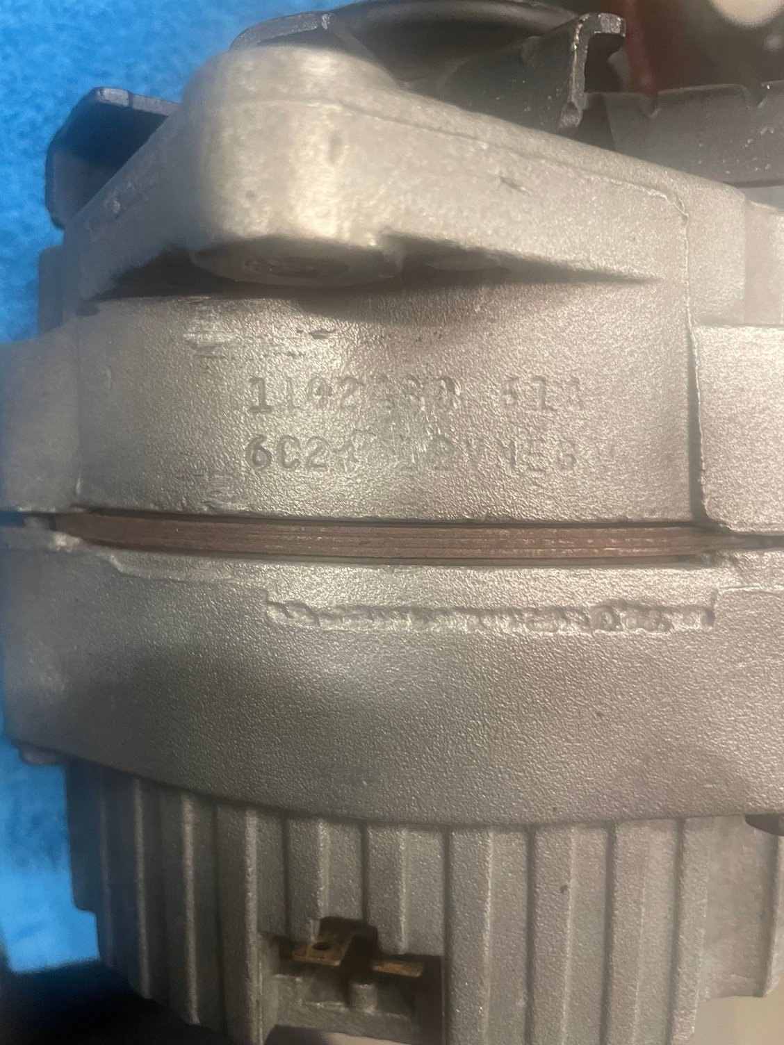

My old alternator is stamped
1102480 61A
6C24 12V NEG
Dont think it’s the original, it does have
Delco - Remy embossed on the back of th casing…

april 1966, 1976?
if original (maybe not to your car) non chinesium hacked then i would still rebuild it..
pic?

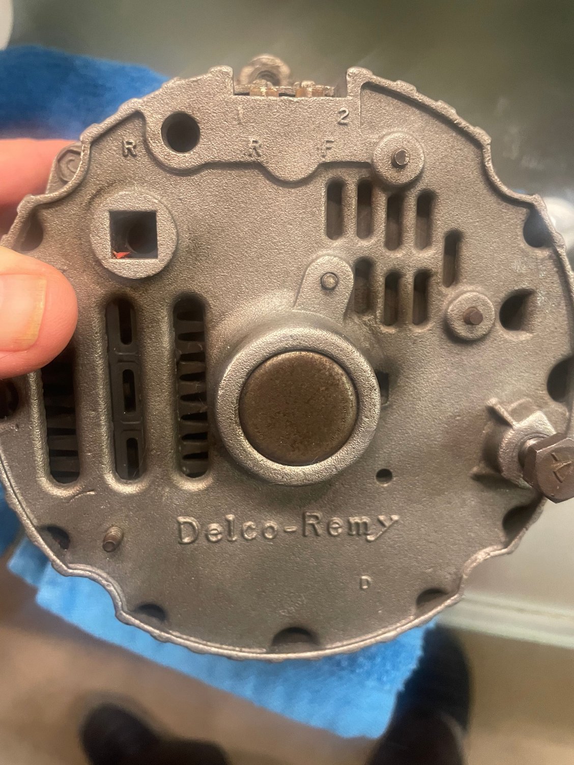

Originally Posted by interpon
april 1966, 1976?
pic?
Old Jan 7, 2023 | 08:17 PM
interpon's Avatar
interpon
Joined: Jun 2019
Posts: 7,658
Likes: 2,470
From: Indiana
That looks nicely unmolested original ..
stator color and not blasted..
easy rebuild and bearing replacement..

May I ask where is the through bolt and insulator?
Old Jan 7, 2023 | 09:06 PM
Daveinspain's Avatar
Daveinspain
Obsessed
Joined: Apr 2019
Posts: 627
Likes: 394
From: Valencia, Spain
2025 C3 ('68-'73) of the Year Finalist - Unmodified
Yes, when I was trying to losen the nut off the through bolt it wouldn’t come off, it was frozen on. I sprayed it with WD 40 but still couldn’t get it off. Then the whole bolt started turning and I noticed the red plastic insulator was cracked. Anyway the whole bolt came out and the insulator was in two pieces… Can that be fixed, Not sure if I still have the bolt.

Yes there is, but most likely all of these cheep kits are made overseas.
Here is one of those kits for up to a 75 amp 10si alternator,
E-bay LINK: https://www.ebay.com/itm/19060680196...Bk9SR6TKx_KxYQ
If you open that alternator and there is a single loose flanged nut with no home it came from that missing through bolt, that's why you see 2 nuts in the NOS bolt kit I posted. 1 for the battery wire and one securing through bolt to rectifier.
