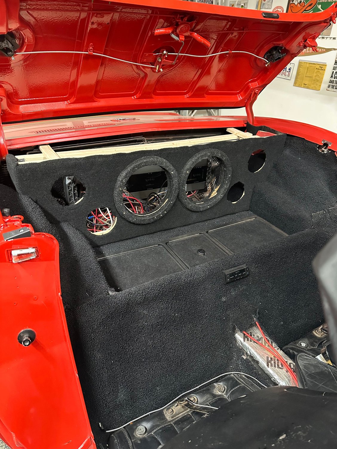

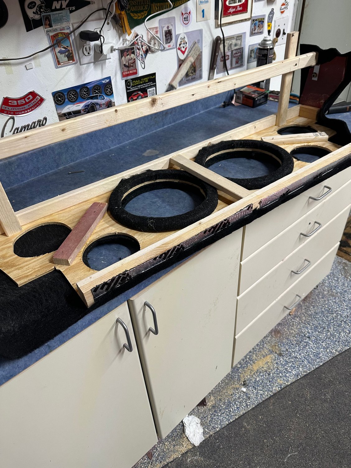

Coincidentally I was installing speakers in my 71 convertible. It’s not difficult to use the 3M adhesive and staple gun on my homemade speaker box. I purchased the fabric on Amazon. It’s inexpensive enough to take a stab at it.
Not quite finished
