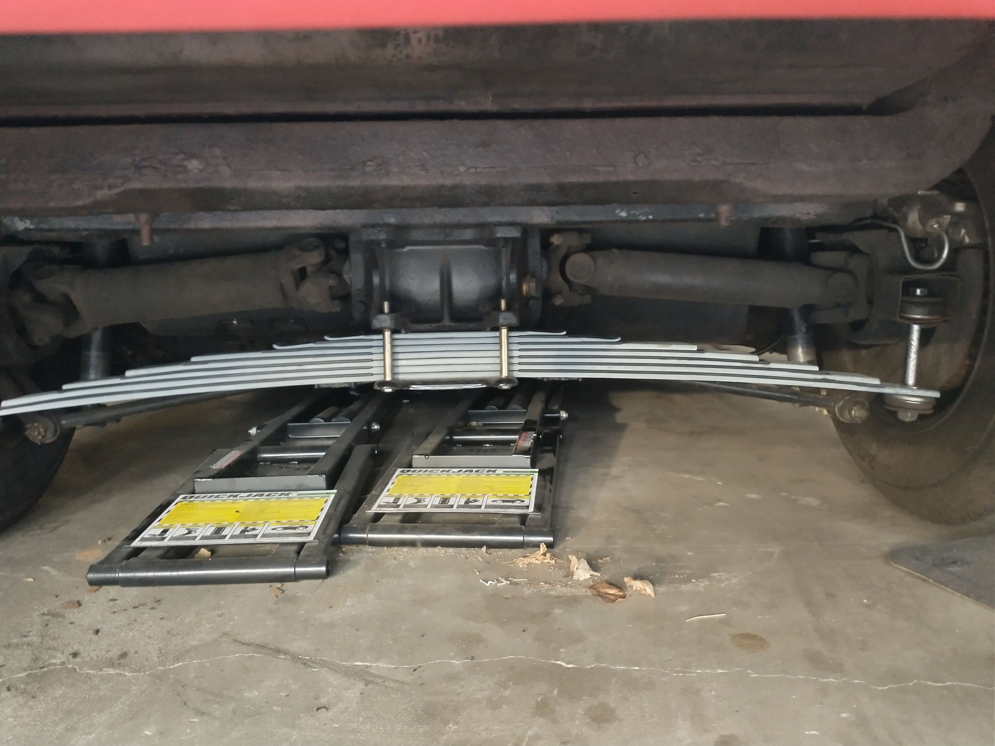

I have a 68. It came with a 7 leaf rear spring. Being new to the C3 I thought I would change the ride. I got a new 9 leaf, it didn't change the ride a bit.
I thought I needed something to keep me busy so I restored the 7 leaf. Old springs can get rusted and the spacers can be totally gone. I would think this alone could change the ride. Any new spring would probably improve the ride. It isn't that hard to restore the old spring. Take it apart, clean up the metal, paint it with gray galvanized paint, get new spacers, reinstall. Easy peasy,,,, unless your spring is really bent.
I did lower it a bit from the picture.

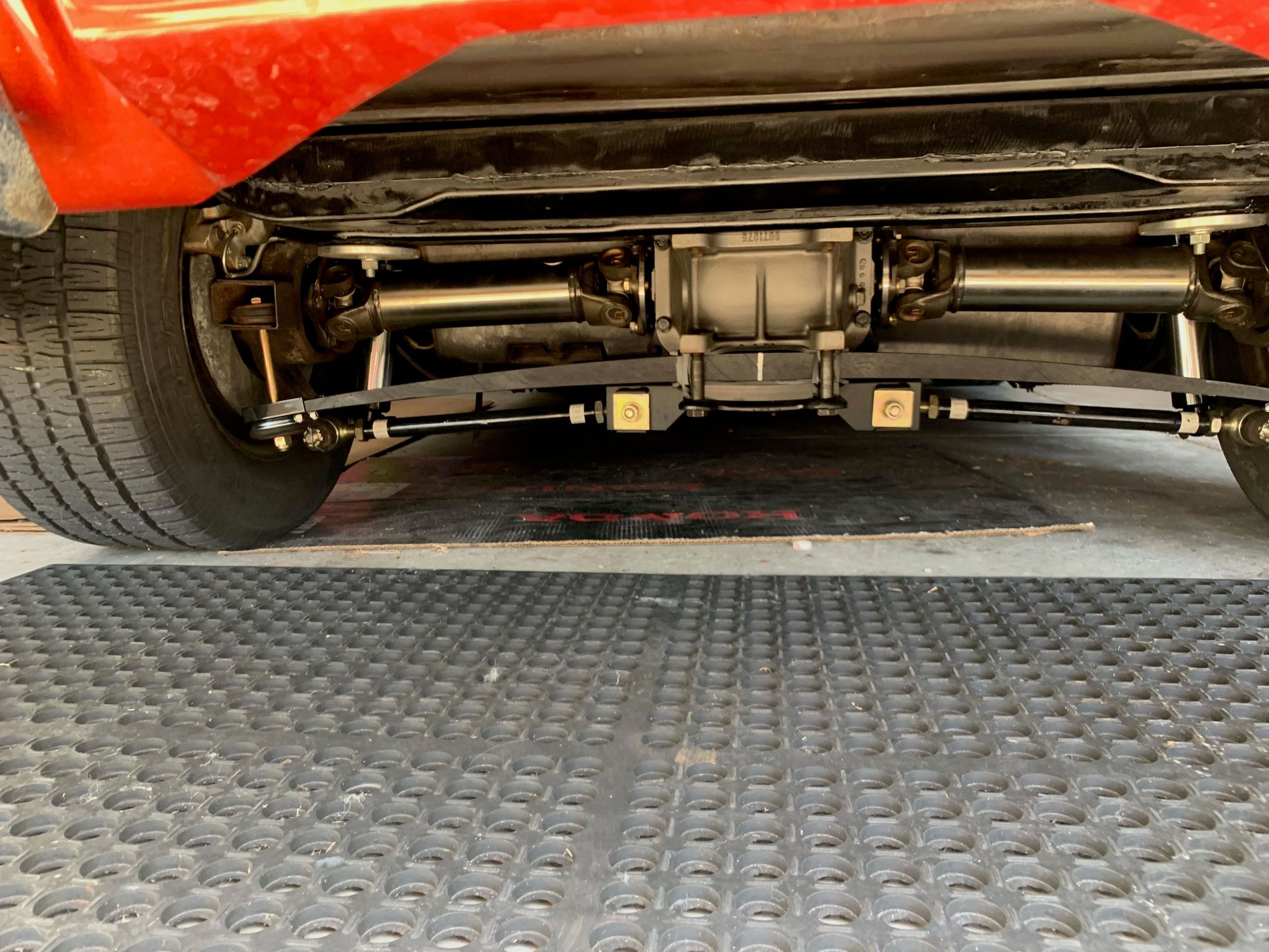

Default Long bolts
Originally Posted by ignatz
I disagree with the original spring proponents. My initial impression of my VBP install was that all the harshness of the steel spring was gone. I can't however say how the present aftermarket springs feel, but the fabrication tech ain't really be all that different from my what is now a 20 year old spring. I would expect new fiberglass composites feel the same today.
The two things you need to be aware of are the spring rate and installing a simple aluminum panel over the spring where the exhaust crosses under it. It functions as a heat shield. Even there, I never been all that sure it was really needed, but it's a cheap piece of insurance.
Last comment is I did not like the TRW spring at all, although I don't remember why. It has/had kind of an odd shape which may have something to do with its impulse response or linearity or I don't what else governed the design.
You didn't say who is projecting a month wait but I would bet that's optimistic if they're waiting for somebody to start a production run, so that's the only downside if you feel something HAS to be done now. And it doesn't sound like it.
Just looking at the rear suspension. How long are the end bolts on your spring? If you get a flat tire will the bolts hit the ground?
