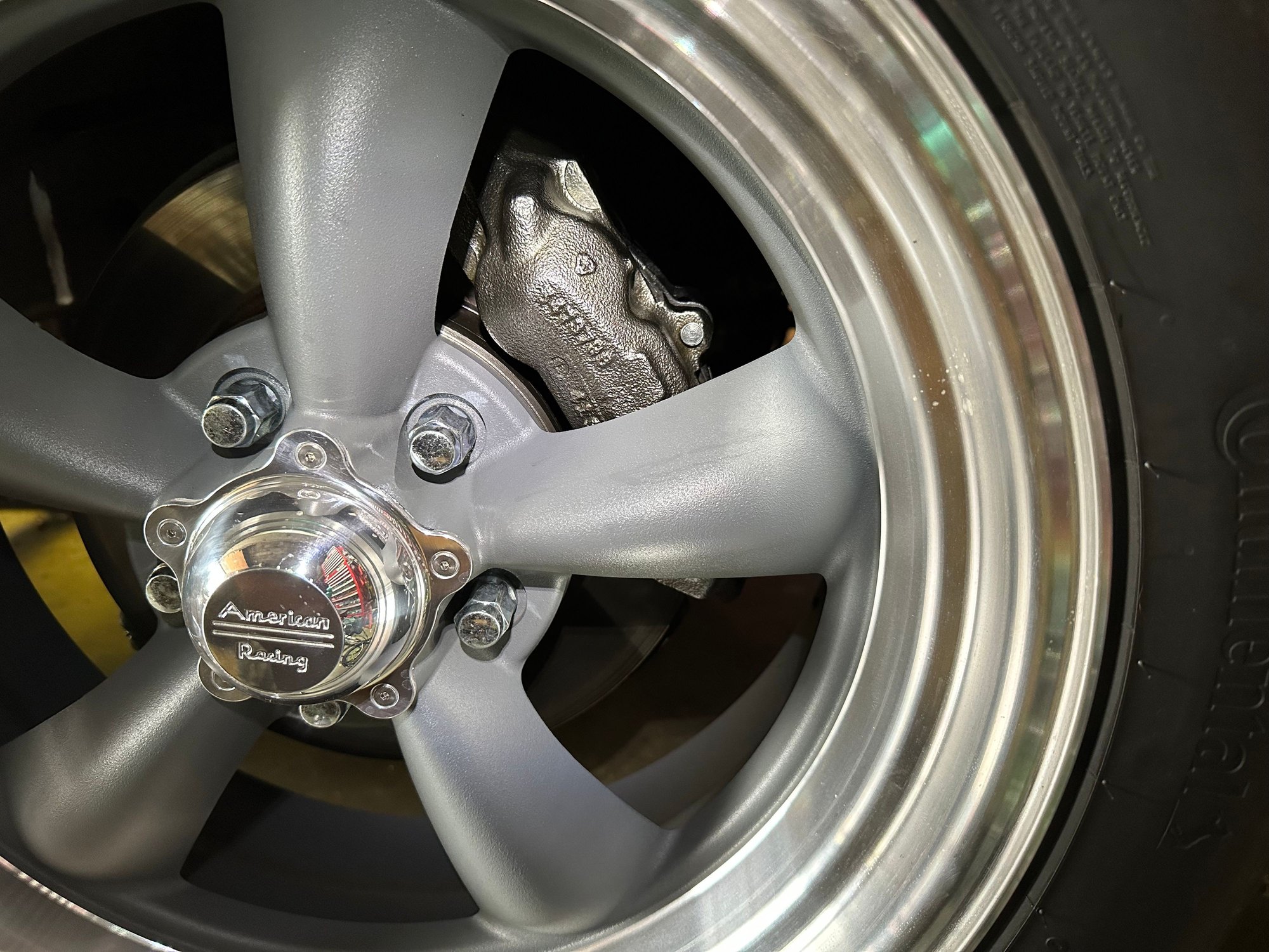

Here’s a pic of TT II 18x8 4” BS. Plenty caliper clearance.

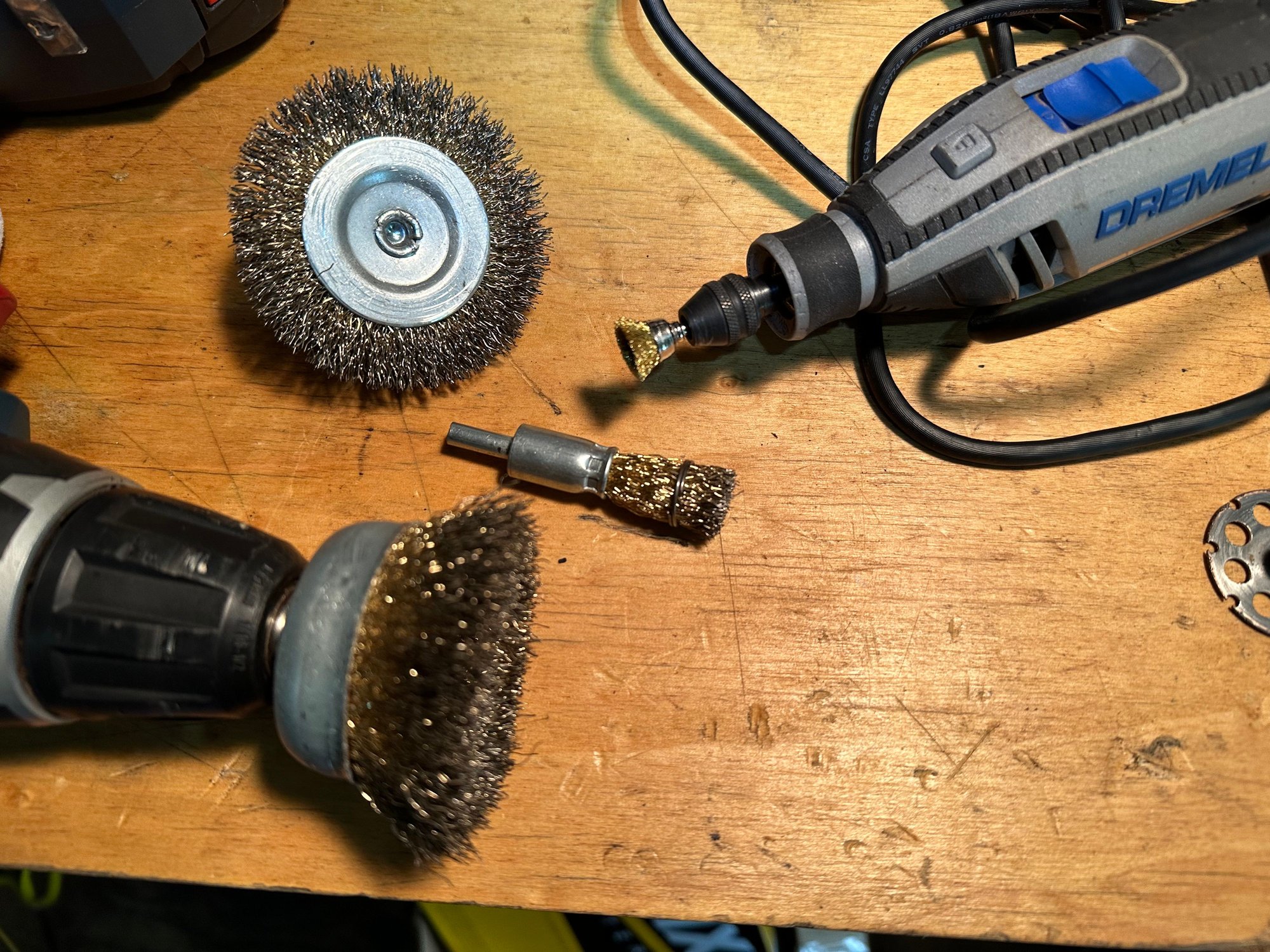

After installing these wheels, the rusty calipers are much more exposed. Considered painting them, but found they’re easy enough to clean off with brass-wire wheel, then coat with rust-preventative.
