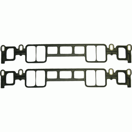

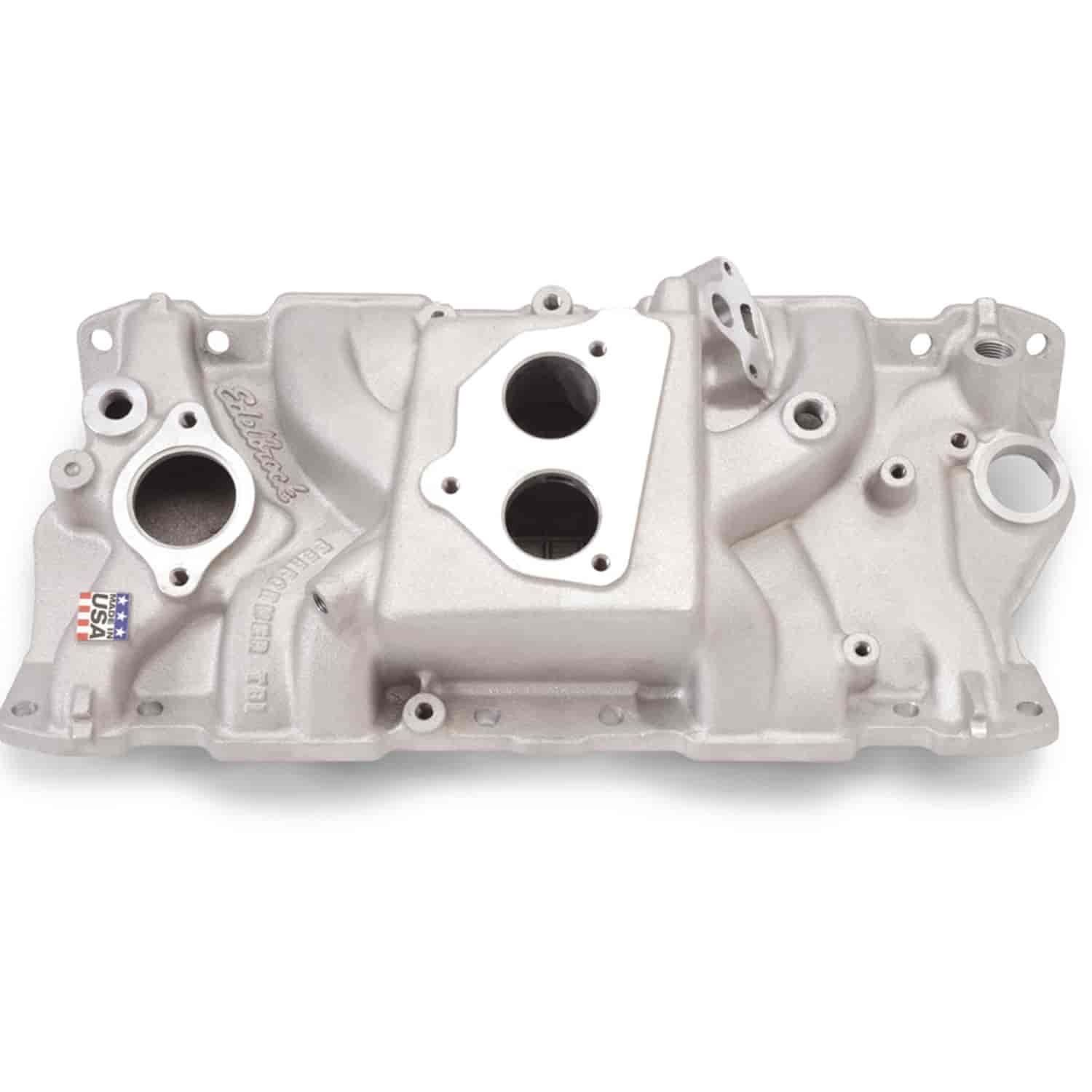

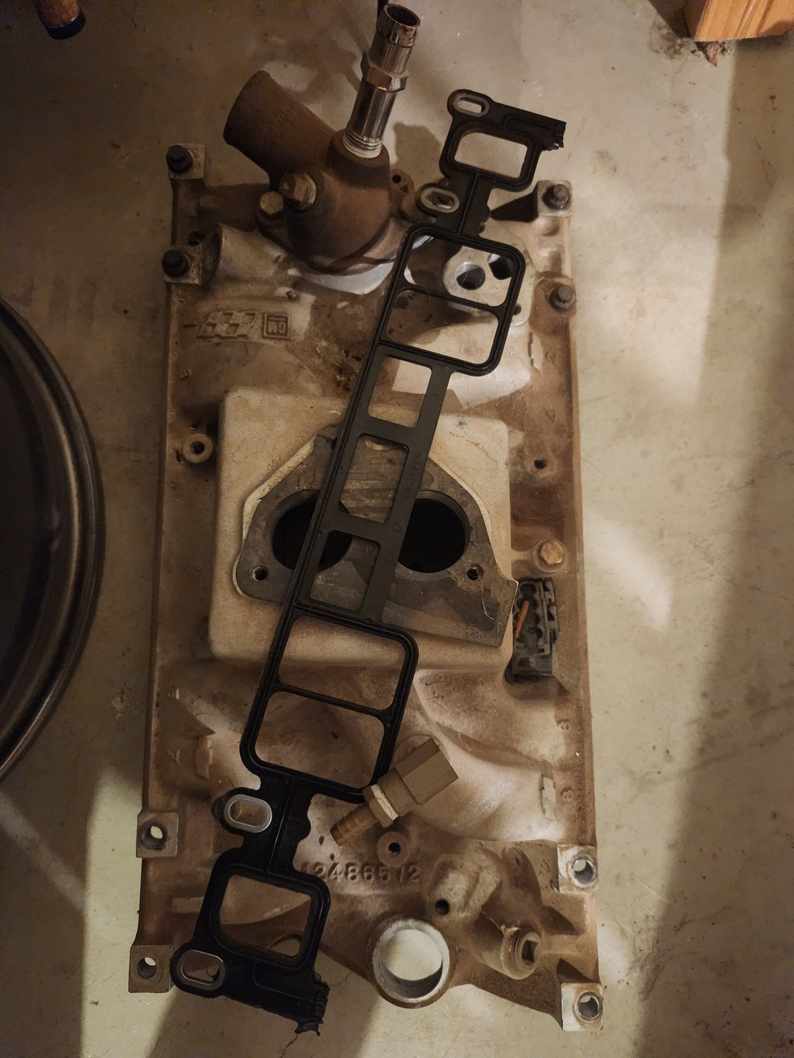

this is the vortec manifold bolt pattern.
Originally Posted by HackTheBox
Will a q-jet fit on a TBI intake? If so then I have a vortec intake i can use.
there is no TBI intake for vortec heads. there are TBI heads that have the middle 2 bolts on each side of the intake pointing straight down. they get mistakenly called vortec heads. they are just smog heads with 72 cc chambers and a funny bolt pattern. true vortecs only have 4 manifold bolts each side.
nothing fits on a TBI intake but a TBI and tbi intake only fits 87 to 95 tbi heads.
This is the head i bought from Scoggin-Dickey.
Intake from Summit or maybe Scoggin-Dickey cant remember exactly where. But yes def not gonna work on q-jet without adapter. SDPC makes an intske for TPI for these heads. And from what i recall these heads are the vortec design. I have the paperwork stored away.
And the TBI. Had all yhis running on a C10 years ago, would turn tires at lights if I touched the accelerator to hard.

i stand corrected. i have never heard of a TBI intake for vortec heads. i guess tbi people want to upgrade to vortec heads too. but, nothing fits that intake but a TBI unit. whereas there are adapters to put TBI onto spread bore 4 barrel intakes. GM used them for years. TBI is a nice emissions-economy efi setup. with the 454 unit you can make some power, but it is still about 500 cfm tops. and it ain't sexy. nothing uglier but a rochester 2 barrel carb. to run TBI in a 75 vette is near the amount of converting needed for more performance-oriented efi setups. wiring in the ecu and all sensors, etc. the advantage is only need 13 psi instead of 40 to 60. but the lower fuel pressure means it doesn't atomize as well also. i don't see the value in running this setup in a corvette. the Jegs version of the spread bore carb vortec intake. https://www.jegs.com/i/JEGS/555/5130...RoCzNEQAvD_BwE unfortunately you need a gasket that is half the price of the new manifold. vortec trucks are in junk yards all over because the intake gasket failed and watered the engine. use this gasket for a vortec head. https://shop.advanceautoparts.com/p/...E&gclsrc=aw.ds
You are correct. Have no plans to use the TBI on my vet. SDPC has a TPI intake for the vortec heads. I've got a complete TPI setup and ECU already. Howell EFI can make harness, dynamicEFI for the ECU upgrade and a few weeks of wrench should do it. Of course new sending unit and fuel pump, MAF coil setup and other sensors need to be added.
I used dynamicEFI on the TBI and it was nice. Not the best but i know how it works.
my 1st goal is to attempt to get this engine running. Drive the car on weekends in summer while I'm accumulating all the parts and prototype assembly on a stand then transplant.

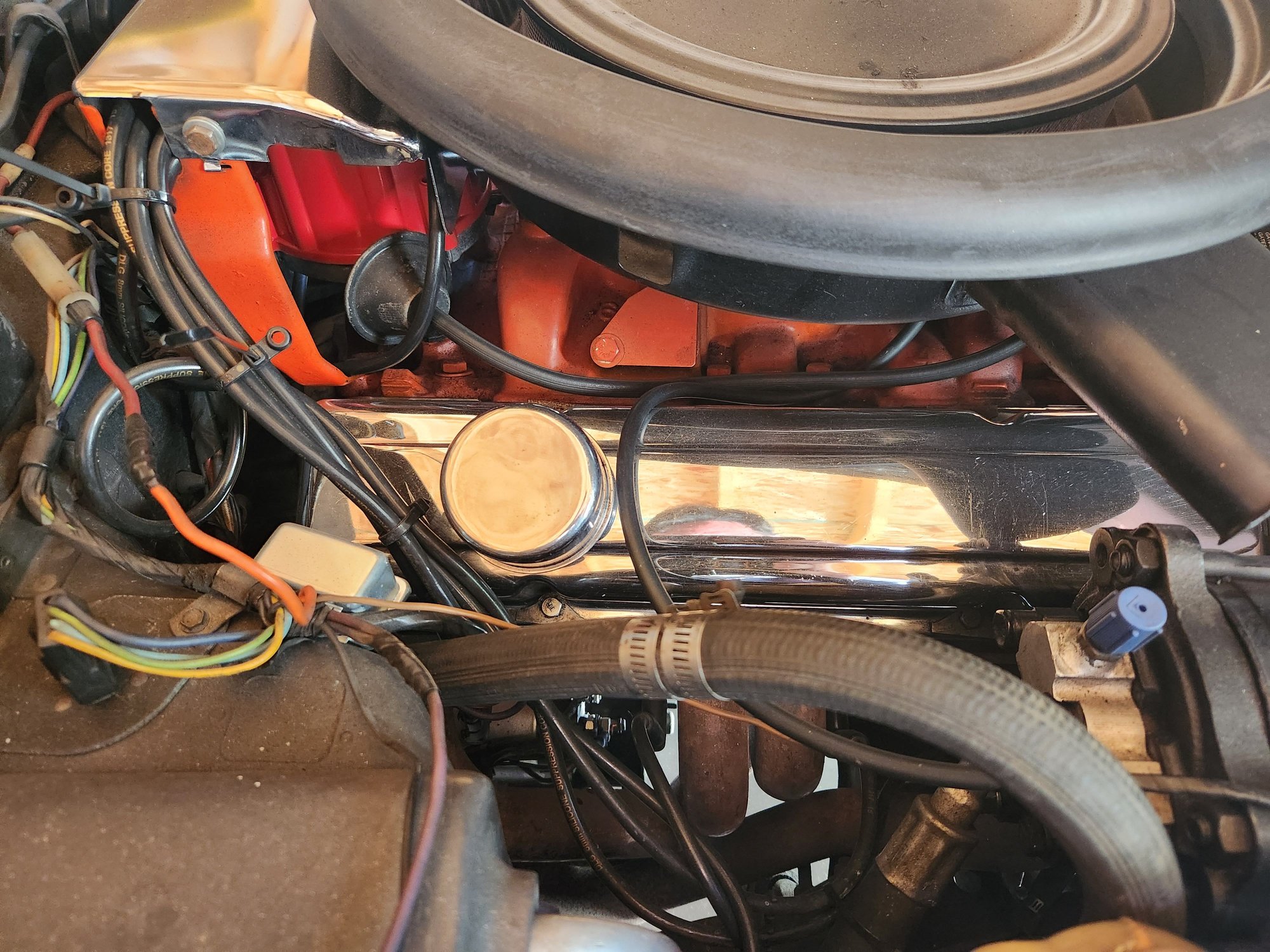

I took the corvette out for a drive today just to see how she runs. There's definitely some roughness to the engine. Doesn't run like I'm use to. However she not bad but definitely lacking that get up and go that a tuned engine should have.
I ran a practice run on my engine for leak down and for a cold block that hasn't run in several years all cylinders run about 4% loss. Worst was 7%. But I may have not been 100% TDC it was tough to hold the crank perfect and the cam I have in there is pretty aggressive.
1st thing tomorrow I'll pop the covers off the vet and snap some pictures of the rockers and lifters. Run the leak down and post the results.
I'll get pictures of plugs to should show any combustion issues or fouling due to burning oil.

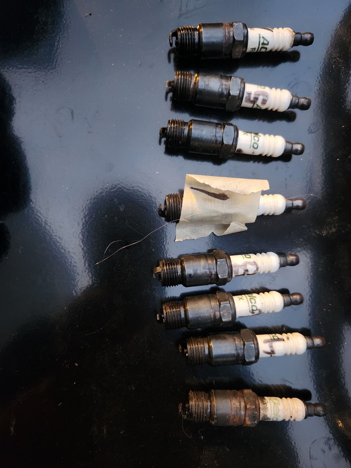

Bottom to top 2 thru 8 then 1 thru 7.

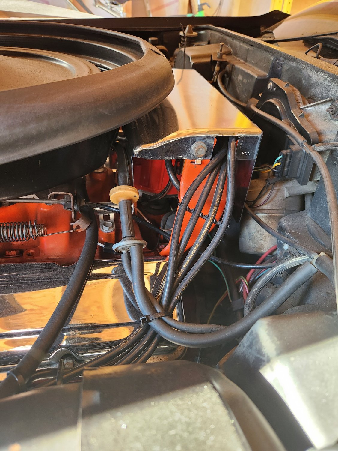

Pulled plugs today, just about every plug was fouled. 5 was actually in good shape. 2 by far the worst. It probably was a dead miss due to over use of zip ties on plug wires. When we remove the zip tie, the plug wire was burn thru and shorting to engine bracket. It practically fell apart.
Could this direct short kill the coil?
Cylinder 1 had good leak about 5% loss. Ran out of day light. Will do rest tomorrow.

Also the valve cover bolts were super loose. Looks like oil was leaking out on sides, but still doesn't explain coming off the back from the bellhousing. So either rear main seal or pressure guage.

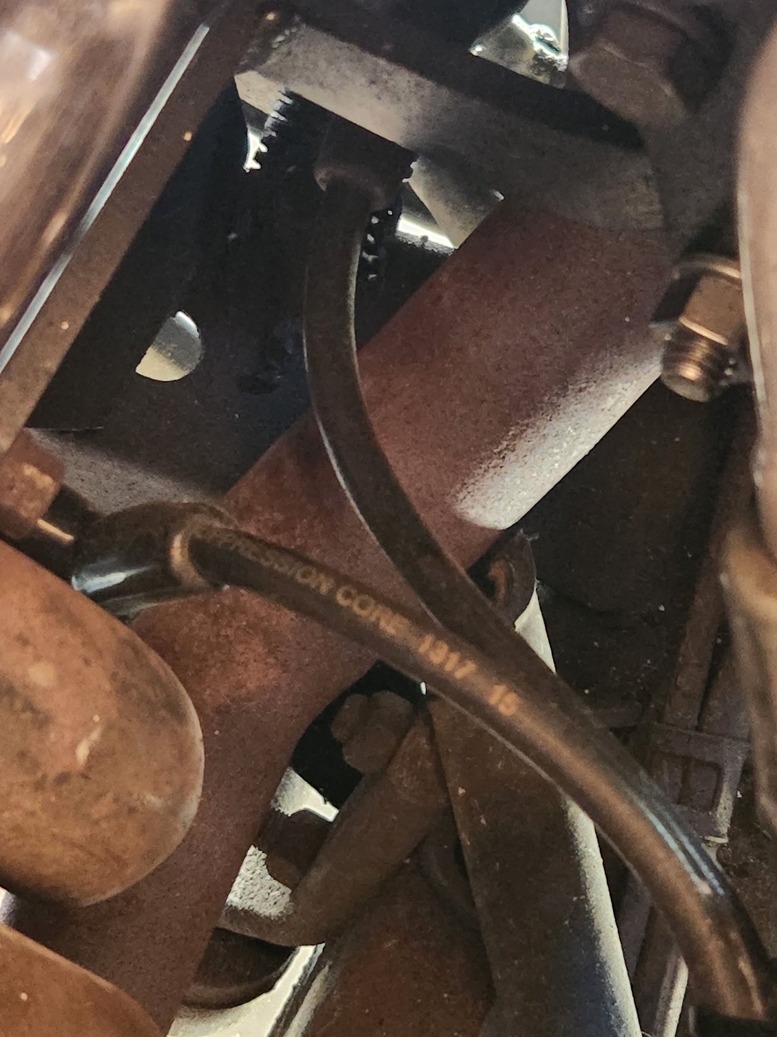

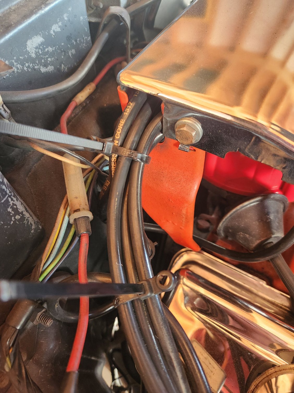

I'll check that too. Thank you
Here why zip ties are not used on soft silicon or any plug wires. Vibration and chafing caused insulation to break down then burn the wires arcing to ground.
Those spark plug gaps look enormous! Granted, I'm used to .032" for points and not HEI but still...
