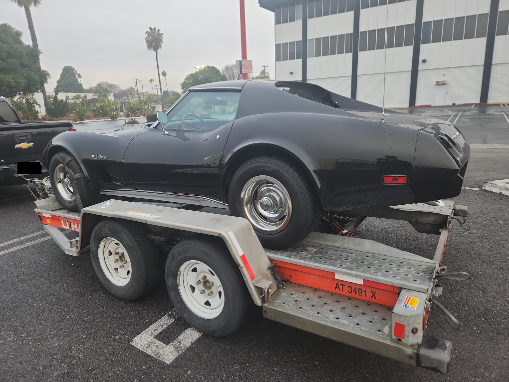

Side view on transport.

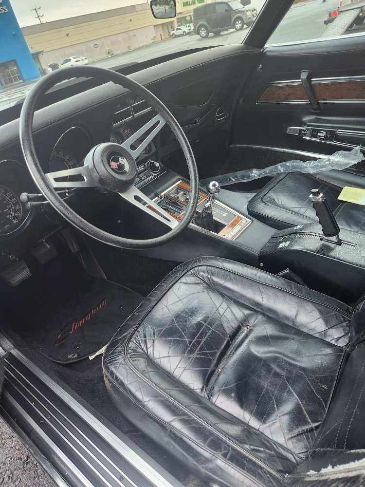

Interior Clean, seats need some work but overall clean and everything is working.

Looks nice...
Have you looked at the trim tag to see what the original color was? No black in '75...

Originally Posted by SEVNT6
Looks nice...
The trim tag has been painted over. However, closer inspection around door trim seems to indicate it may have been white.
