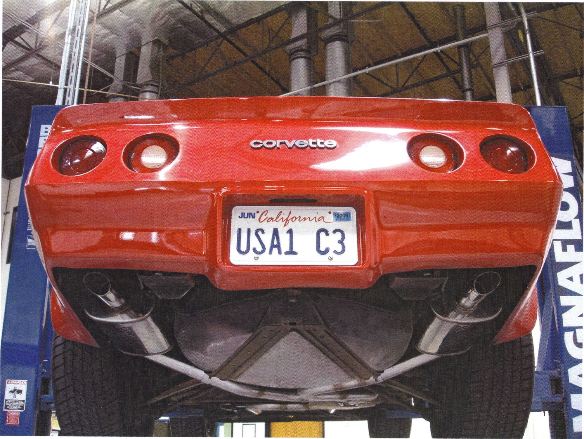

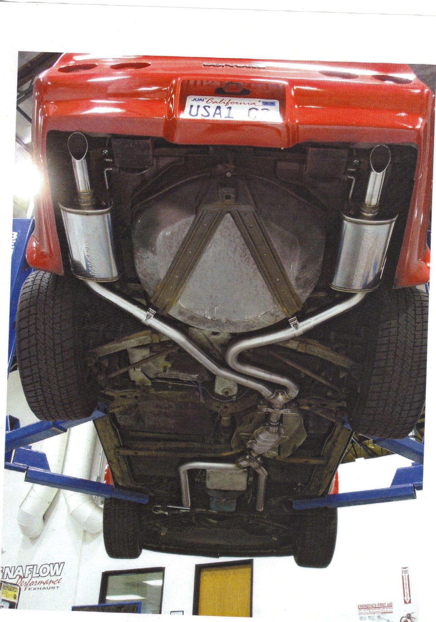

Love the sound of my Magnaflow. I was contacted by them about 15 years ago while at a car show and they asked if they can use my car as a template for a magnaflow exhaust system. The sound is amazing and there is no drone and 15 years later it still looks like it was only changed yesterday.
