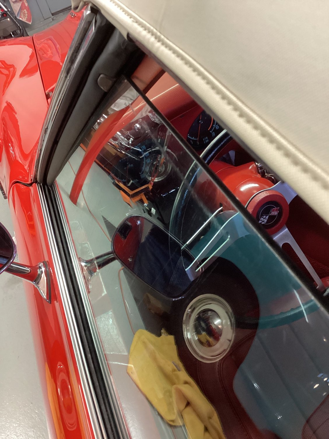

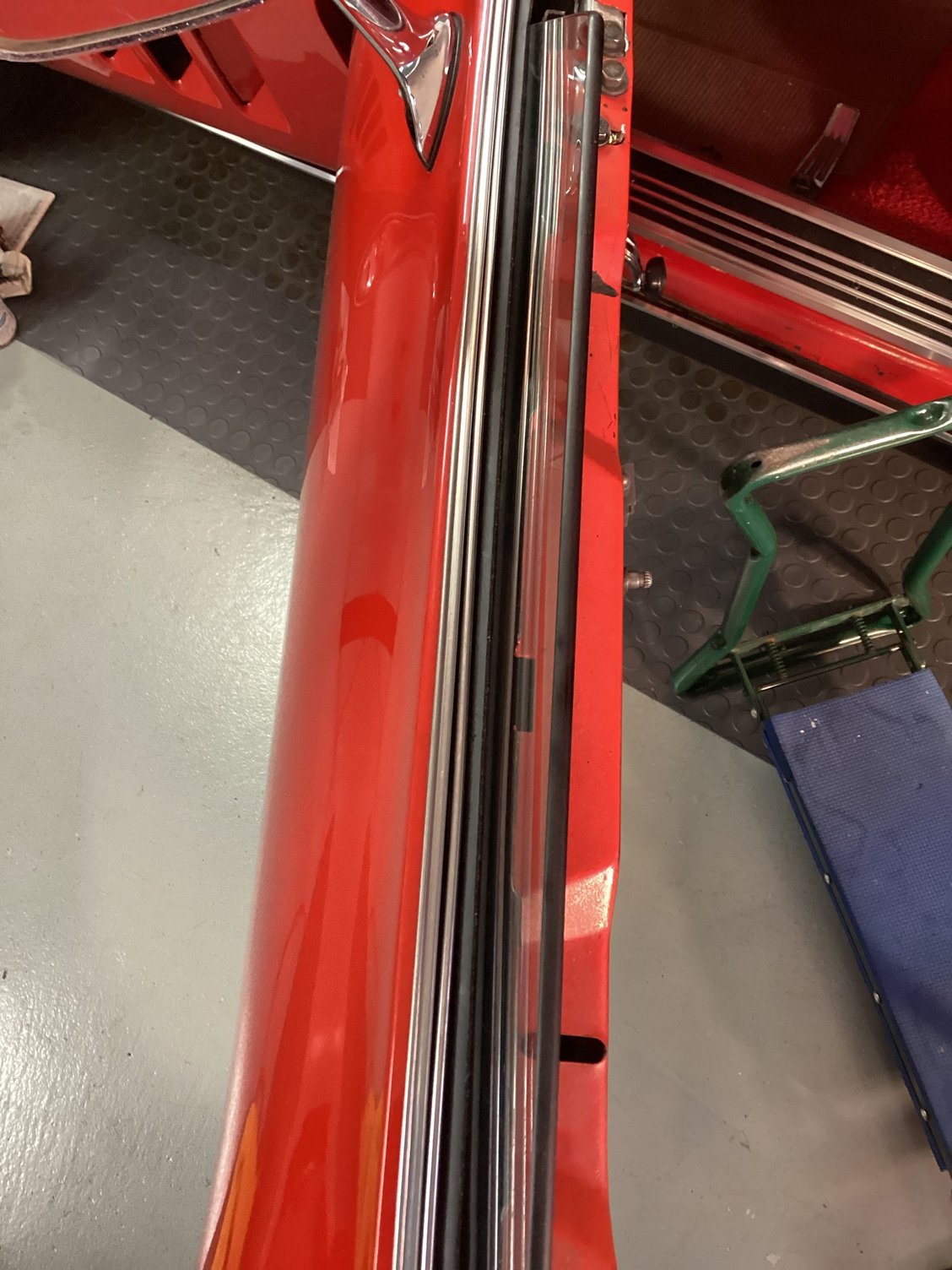

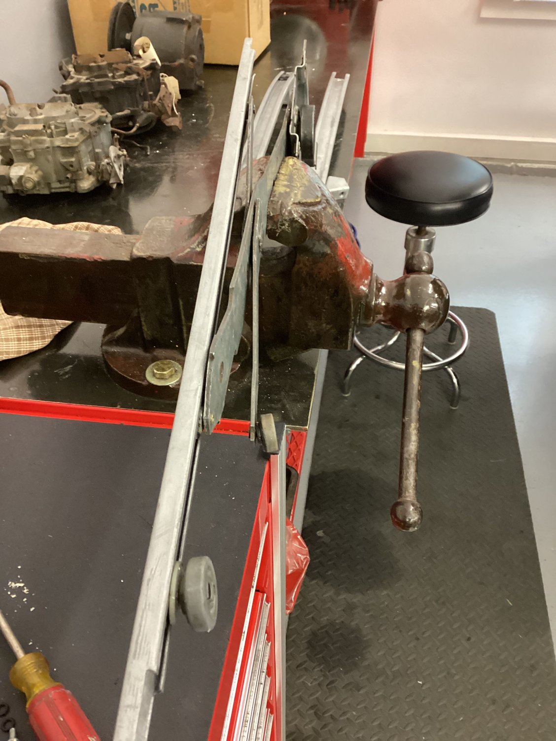

Trying to adjust window whereby it’ll stay outside the clip while cranking up. I can get it adjusted reasonably well in relation to the A post and top. Door hinges and gaps are good. Window and regulator rollers aren’t new but seem ok. Initially straightened out a slightly bent arm on the regulator assembly as I did with the passenger side which is good. Have been through the AIM for adjustment procedure. The window goes up and down fine I just can’t roll it up all the way with the door closed unless I open the door then close it. Any ideas on a fix I would appreciate. Thanks in advance.

Not sure if this is where you might get more adjustment for your issue. There is some vertical adjustment, in and out, on the a frame trim. It is 2 pieces of trim with the rubber gasket sandwiched in between them. The fat rubber weatherstripping is covering 3 screws. If you remove that weatherstripping ( the one inside the clips) you can loosen the 3 screws and slide the track that holds the gasket in or out as needed. Looking at your last picture it appears too far INSIDE at the top. Could that be where the problem is. That track is really only there to control the in and out of the top of the window. Maybe this will help. Good luck.

The top of the window needs to come OUT quite a bit to properly fit the A pillar weatherstrip. At about the halfway point of rolling up if I had approximately 1/2” “outboard “ positioning it would just clear the clip and seat ok. I’ll check that weatherstrip adjustment. Thank you!

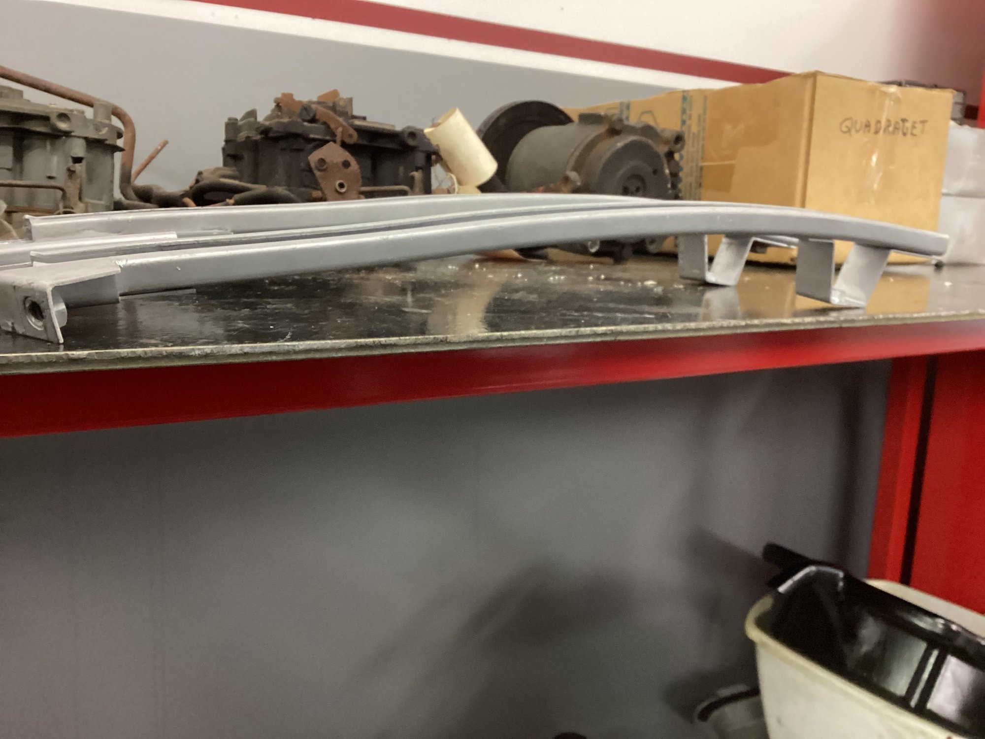

Was the track hat holds the glass bent? I see you have it in a vice. With the felt covers guides on the top of the door removed/loosened, the window should move in & out easily. If the top of the window is stiff, then there is something wrong with th guide in & out adjustment.

There’s plenty of movement with the felt pads out and I was checking the regulator arms and seeing if a slight tweak would lean the window slightly outbound. Have yet to reassemble.

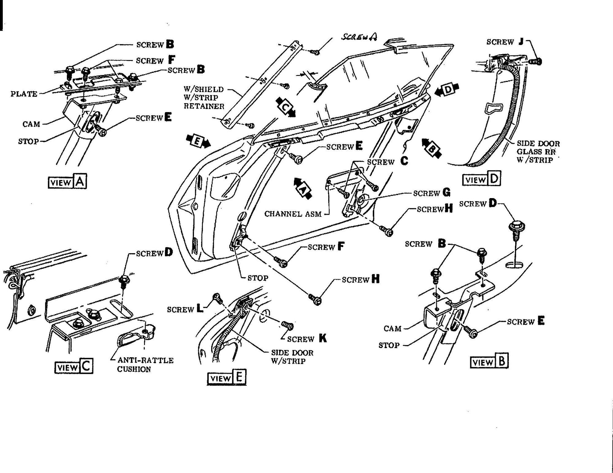

On view 'A' is the 'CAM' fully to the outside of the door?
Same with view 'B'

They’re toward the inside. Moving the top of the glass outbound pushes the vertical tracks inboard.
