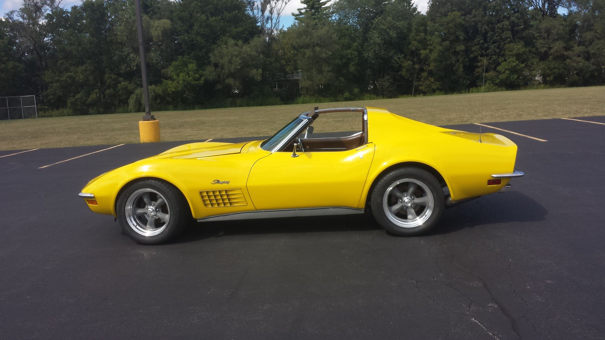

Torque Thrust II 17" x 8". 255/50/17

Any problems with your tires rubbing or steering problems?
Nope, none whatsoever.

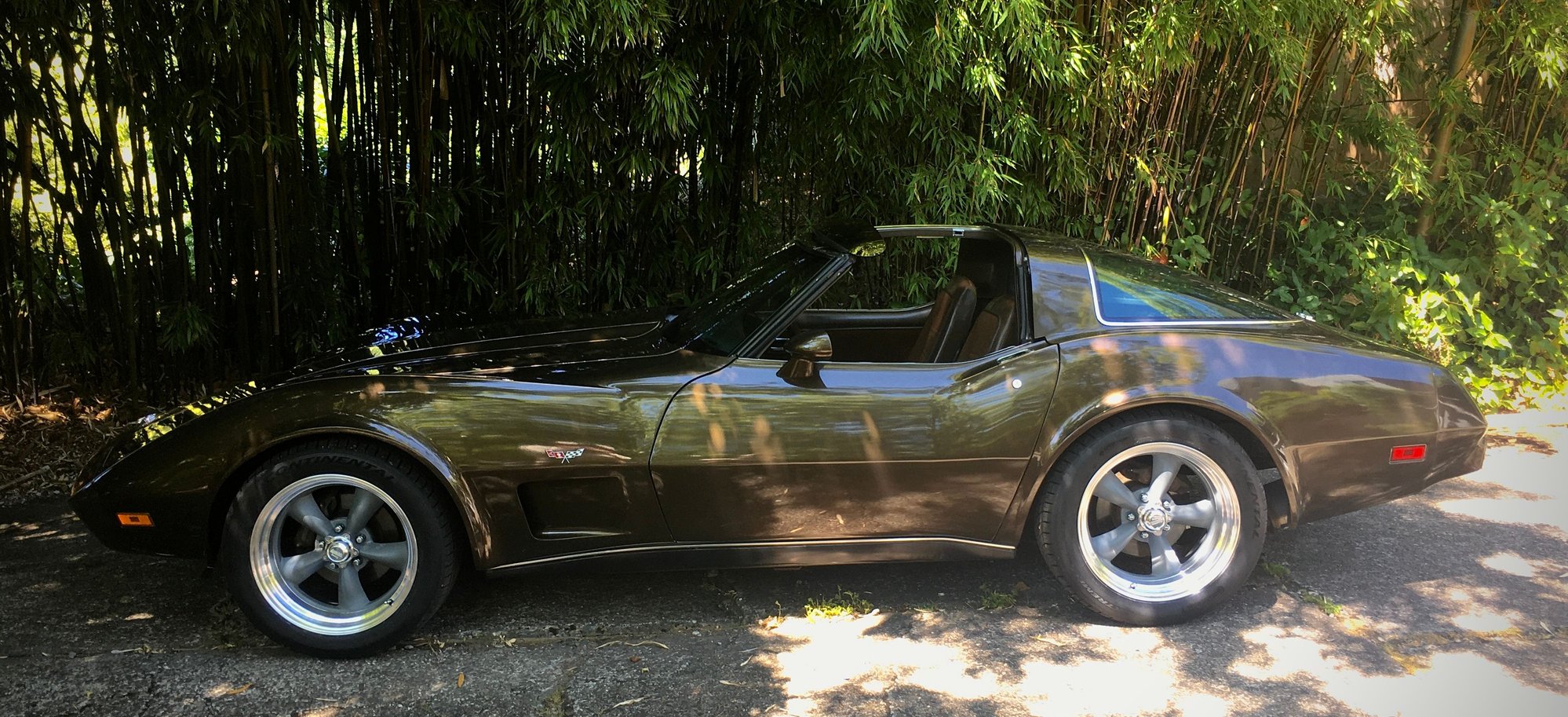

78’s had optional 255/60/15 tires. Front wheel wells were clearanced at the factory on some cars. Others on this forum have used that same size on earlier cars without clearance issues. Others have needed to do some trimming in the front wheel wells, but reported it as minimal and easy. Lots of old threads on wheels and tires. 18x8 wheels with 4” backspace fit easily. For rears, someone on CF used 18x9.5 with slightly deeper backspace without mods. For tires the original 27” diameter fills the wheel wells nicely. I replaced the original 255/60/15 with 255/45/18 on 18x8 TT II’s. Both the originals and new tire/wheels rub the frame in front on extreme turns, but only noticeable while parking.
255/45/18, 18x8 TT II’s, lowered 1”

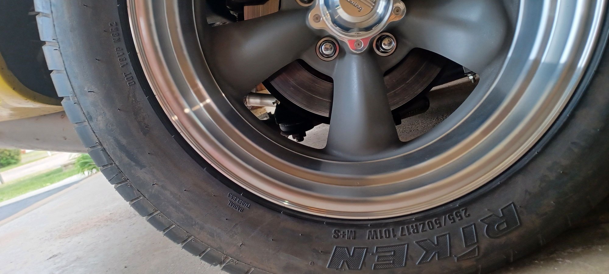

I guess you mean 255 on the rear. Do they stick out of the wheel well? I would like to see a side view of them.

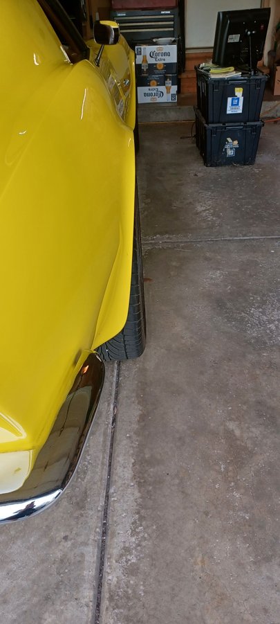

Did you modify your wheel well with that 'flap' on the back of your wheel well?

Uhh, that’s what all wheelwell /fender flares look like on every corvette produced from 1970 through 1982. 68 & 69 didn’t have them.
