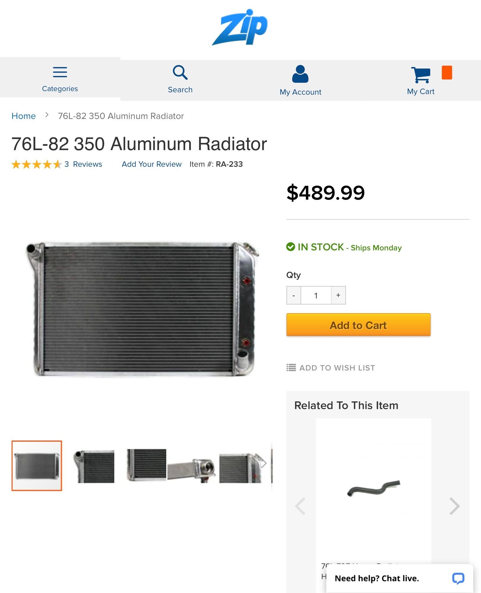

This seems like no brainer?
Usa made sponsor vendor and reasonable price.
https://www.zip-corvette.com/76l-82-...-radiator.html
