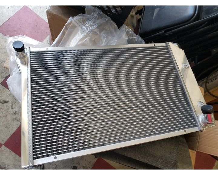

eBay- $134.00 included shipping.
A little file work at the top where mount attaches.
Fit like a glove
