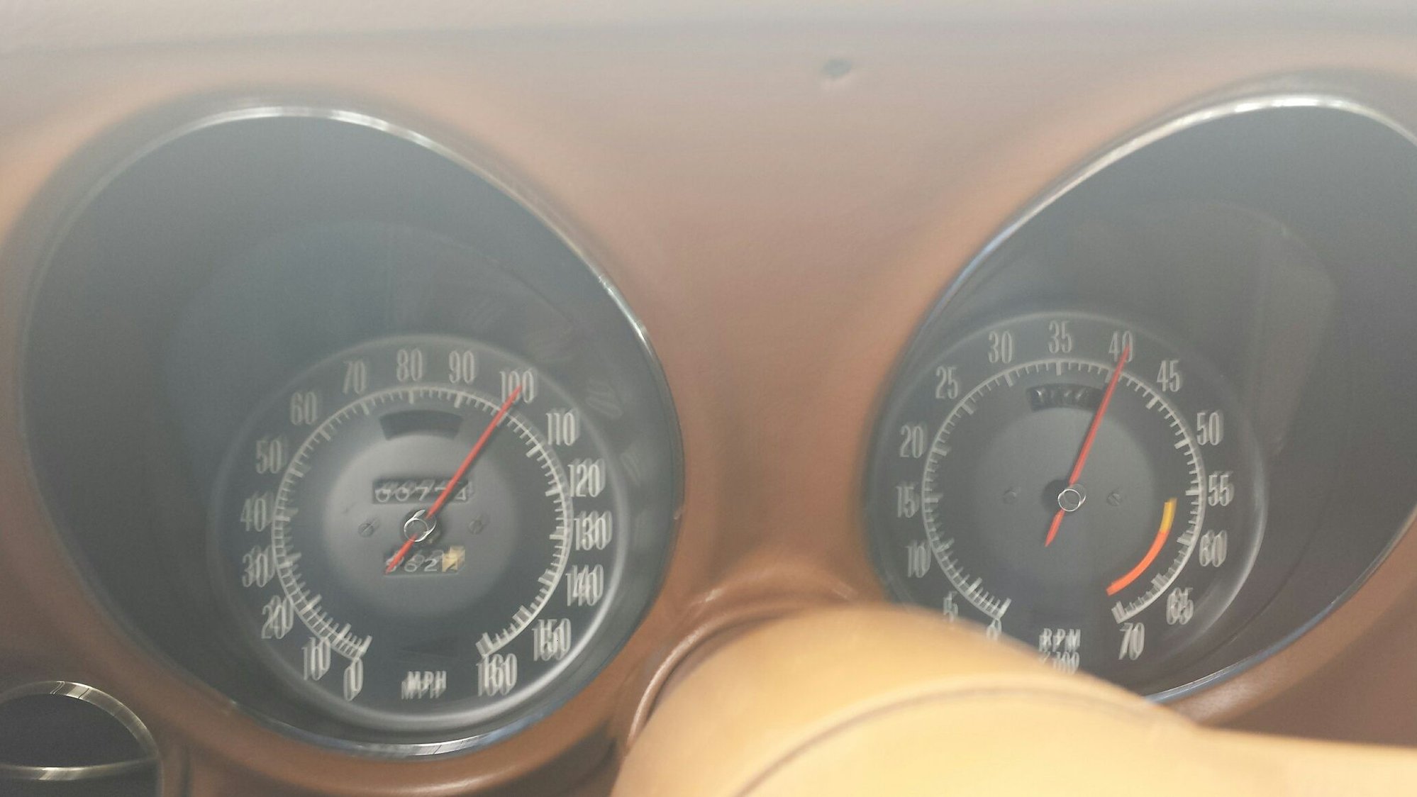

My 73 Four Speed L-82 turns 4000 RPM at 100 MPH if that helps...still wants to rev and pull hard.

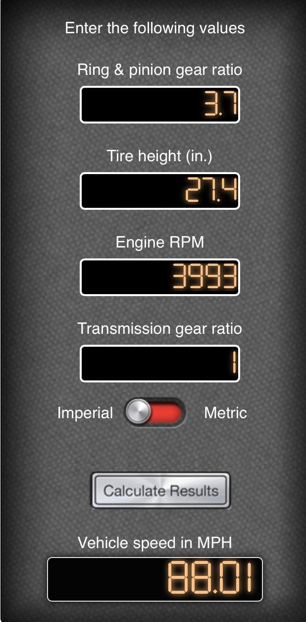

The only correct answer is factory wheels tires 4 speed 3.70 gears to reach the correct speed to go back to 1979
https://spicerparts.com/calculators/...rpm-calculator
You don’t need 5th gear where you’re going
