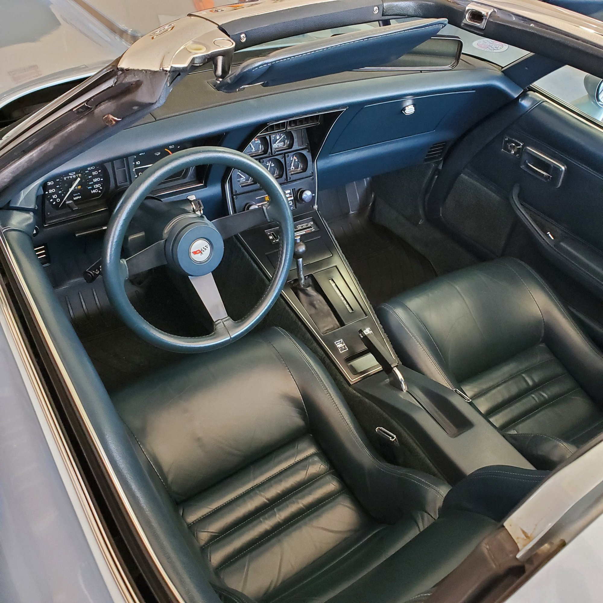

Not gonna lie, I fell asleep reading your post...twice. However, I'm another 82 owner that has had one in the garage for 20+ problem free years. I maintain myself.
I graduated high school in 1982 so that's the year I wanted. My crossfire is a time capsule and takes me back to those good old days. She's been in both of my daughters weddings and I'm teaching the grandson's about her now (but first, we work on lawn mowers!). Find you a car like that.
I'll add, I put new BFGs on her last month and she rides better than my wife's Q7 now. Also, while the 1982 Corvette may have been the quickest US production car built in 1982, I add a C5Z to the garage for some real speed. You simply cannot compare the two cars, each has their own "thing" that often makes me stop and stare. Again, find you a car like that! I hope you haven't fallen asleep reading my post, LOL. Happy hunting!
