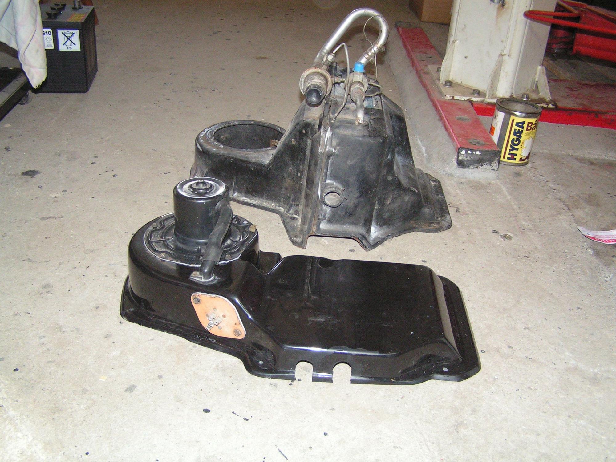

You can remove the evaporator, but you probably also want to get rid of the huge box it is mounted in.
Options are:
A) Replace your heater element with a non-ac model and find a cover from a non-ac car
B) If your heater element is OK then get an AC Delete cover. Google acdelete and look under Y-body on their site

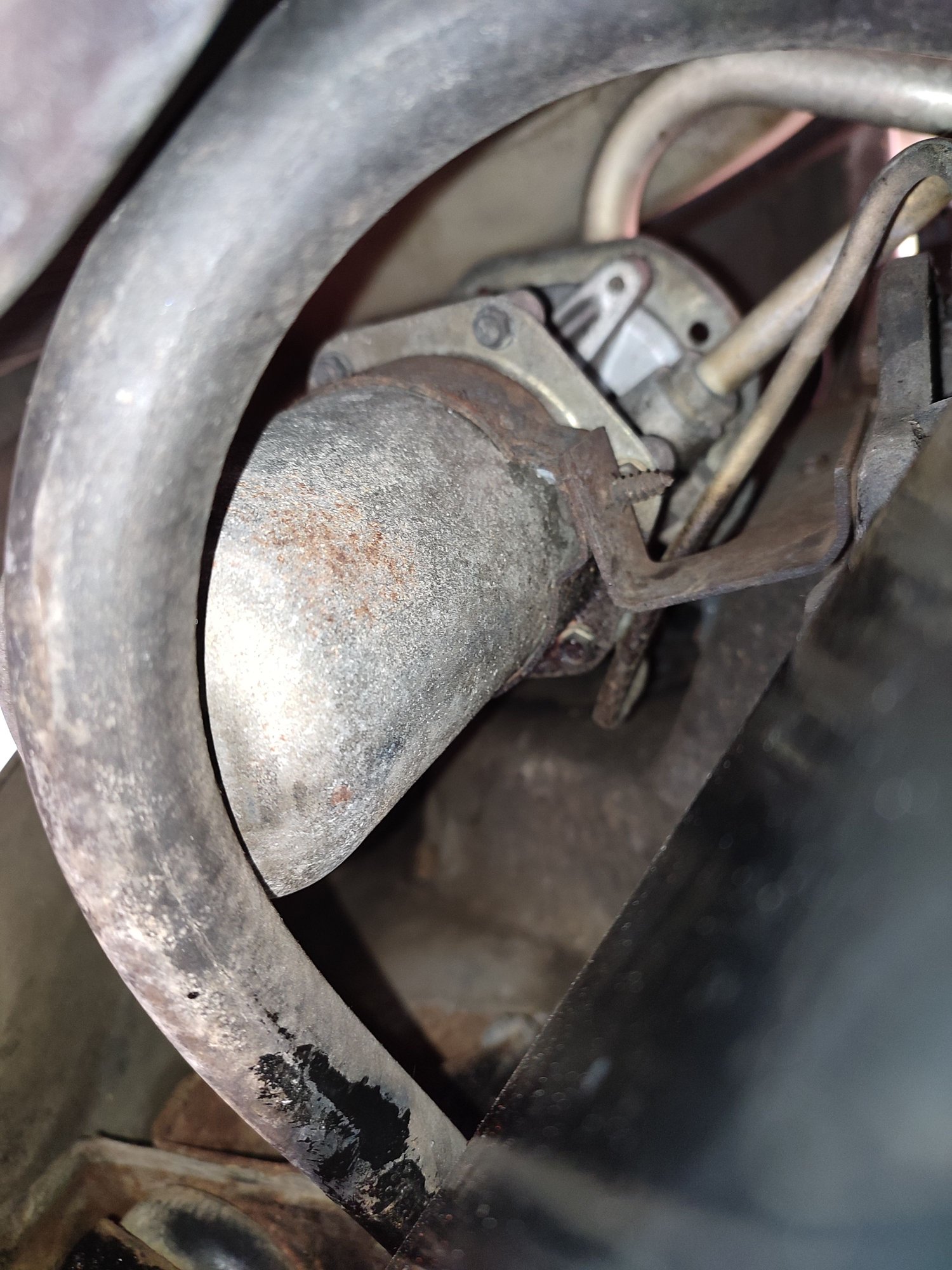

And you have an early 77 based on the photos. It doesn't have a accumulater. That thing in your right fender is the VIR valve.

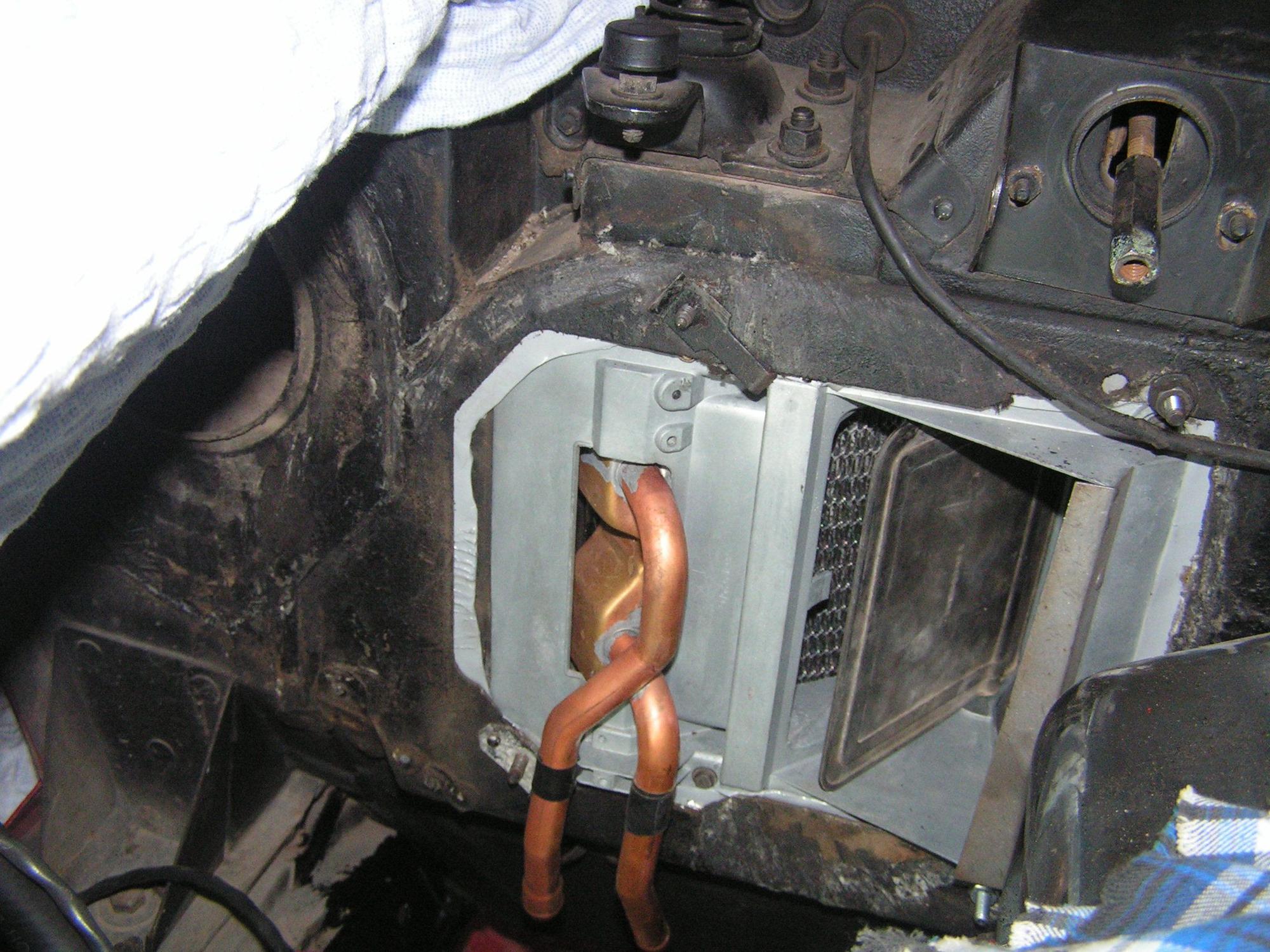

When I did my 77 it all went. I replaced it with a simple heater box from a 69 so I still had heat and defrost.
The 69 non ac box is obviously smaller so I glassed the fire wall opening to look like its always been there. In the car the center vents went and
the Corvette non ac filler plate got snapped in their place. Also wired it so the fan isnt constantly running all the time.
