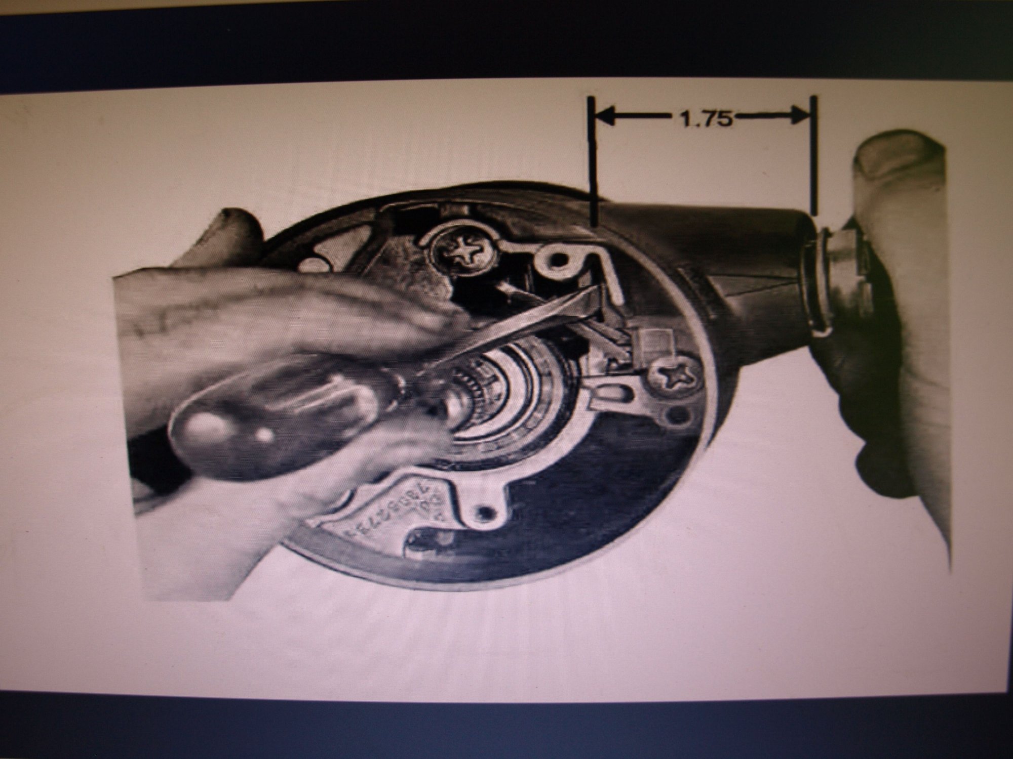

To remove the key switch use a screwdriver and push down as shown and the cylinder will come out.
To ignition switch
