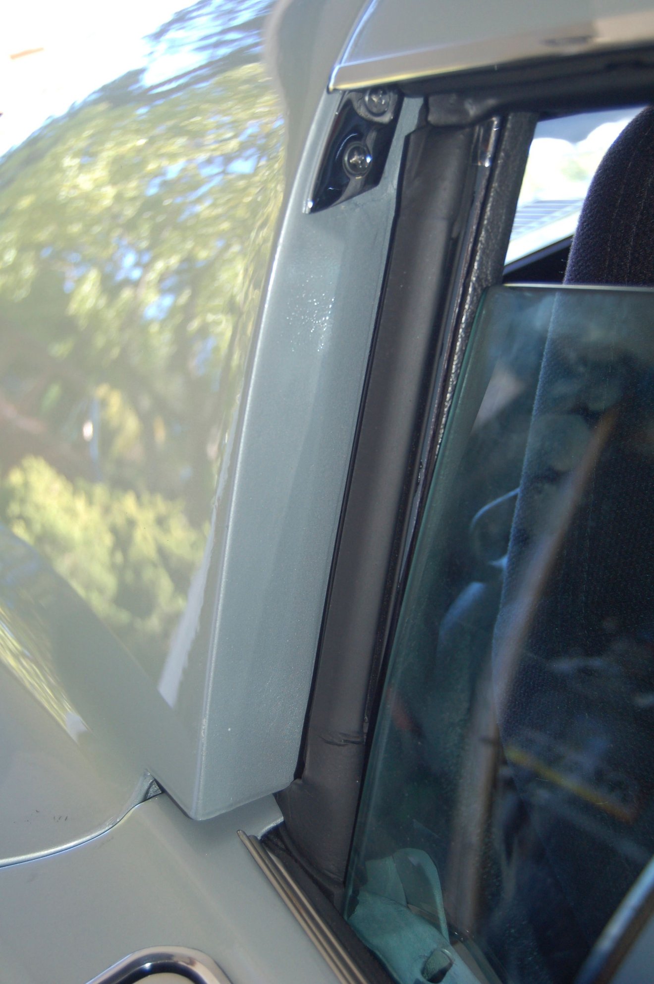

If it's truly the real deal your reward is not having to look at something like this and not know why you can't adjust this away. I could not believe the difference that my NOS find for the felt made, window magically rolled right up after the re-install..

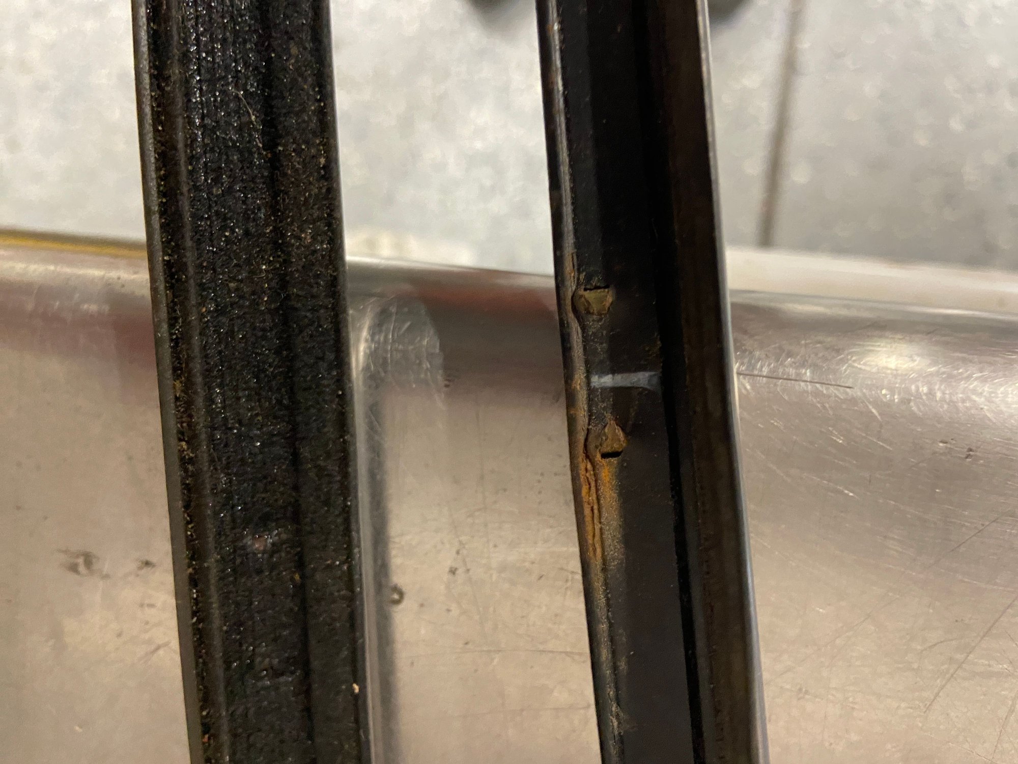

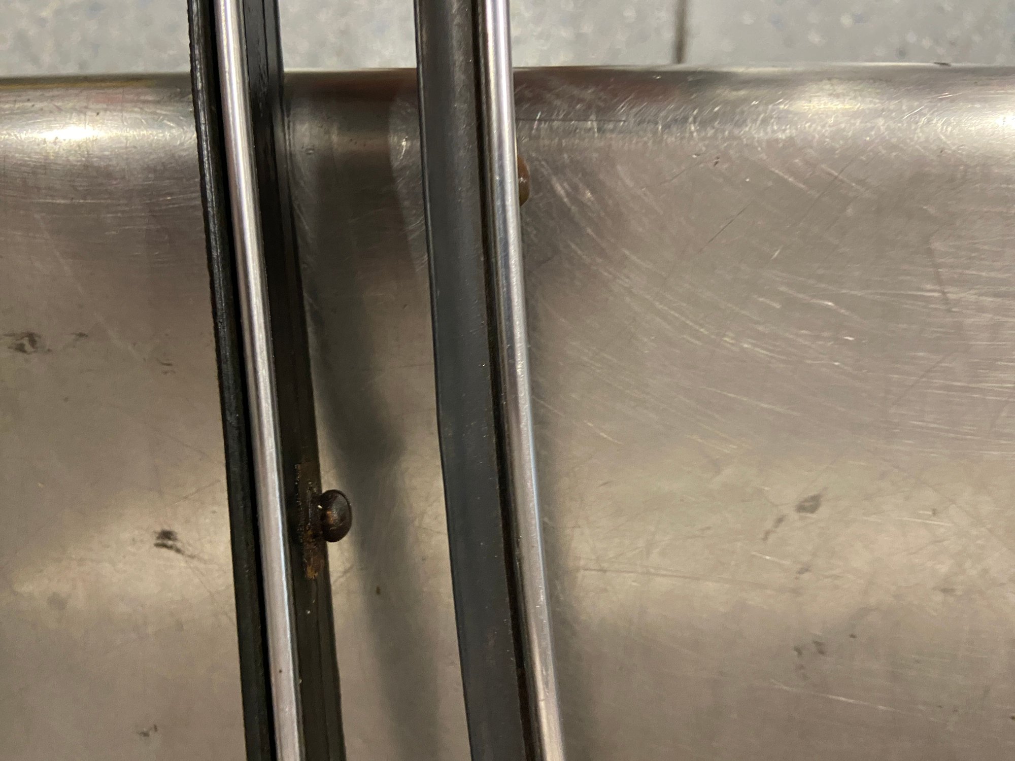

I got my replacement window felt yesterday and it is used but fit is perfect. I am really confused about this stuff. The car ( a 78) has identical sweeps on both sides. Rubber, not felt, a little less than 1/4" wide. Same on each side and I have no evidence that they have been replaced. That is why I thought they were ORGINAL. But the piece that came to me is actually FELT. It is only about 1/8" wide but the felt goes down about an inch inside the door. Can one of you explain the differences to me? Why what I thought was original is now NOT considered original? The biggest problem now is that I will know that the r & L sides are different.My original ia on the right in the pics. No one else will ever notice it but I will! Thanks.

I can't help with your quandary as to originality and our cars are almost a decade apart. All I can say is, that until I found a NOS part, I could not make the window roll up to where it belonged. And I got a lot of friendly advice on this when I posted.

I guess the true test as too how good it is will come when it's time to adjust the windows. It might be one of those parts that was superseded with the felt one and that is all that's out there. I do know that when I took the right door off and apart it had never been touched by human hands after it was manufactured, and pretty sure this one has the same history. I also had the same rubber piece.thanks to all.
