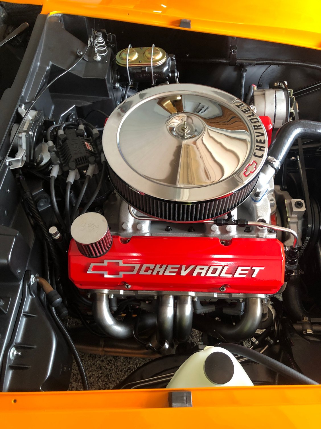

My engine isn't stock - rebuilt to about 370 hp - when I did that about 8 years ago I went with the Patriot "tight tuck" shorty headers - I had to pull the engine again for another issue so am rethinking my exhaust set up - I have had issues with the headers melting plug wires and had to dimple them and wrap them, then put the temp guards on the wires themselves - I am looking to maybe go with long tube headers when I put it all back this time - are teh "tight tuck" headers really needed? would non tight tuck headers help out the spark plug melting issue - I really don't want to go through all that again if I don't have too.....
Looking for input on brands too - not a show car or a race car, just a weekend driver.

I put Flowtech 311016FLT long tube headers on my 76. You can use regular plugs and I run Taylor spiral core wires and haven't burnt one yet.The headers fit well and I run stock exhaust gaskets,Fel-Pro, with no leaks.IMHO, shorty plugs, especially Accel, are a compromise at best

mdunlavy,
No mention of plug wire brand, but an excellent set that can handle over a 1,000 degrees and have the silicone boots are north of $120.
I recommend a 90* angle boot at the plug, and I installed a sock or a sleeve at the plug also.
This is on "77 with SBC and Flowtech headers.
I don't buy plugs just because they fit or just because they clear the headers. Buy plugs that your head chambers want, proper reach and proper heat range. Then figure out how to keep the wires from interfering with headers later.
If you install the wire looms / brackets that hold the plug wires along the valve covers, they are less likely to get burned.

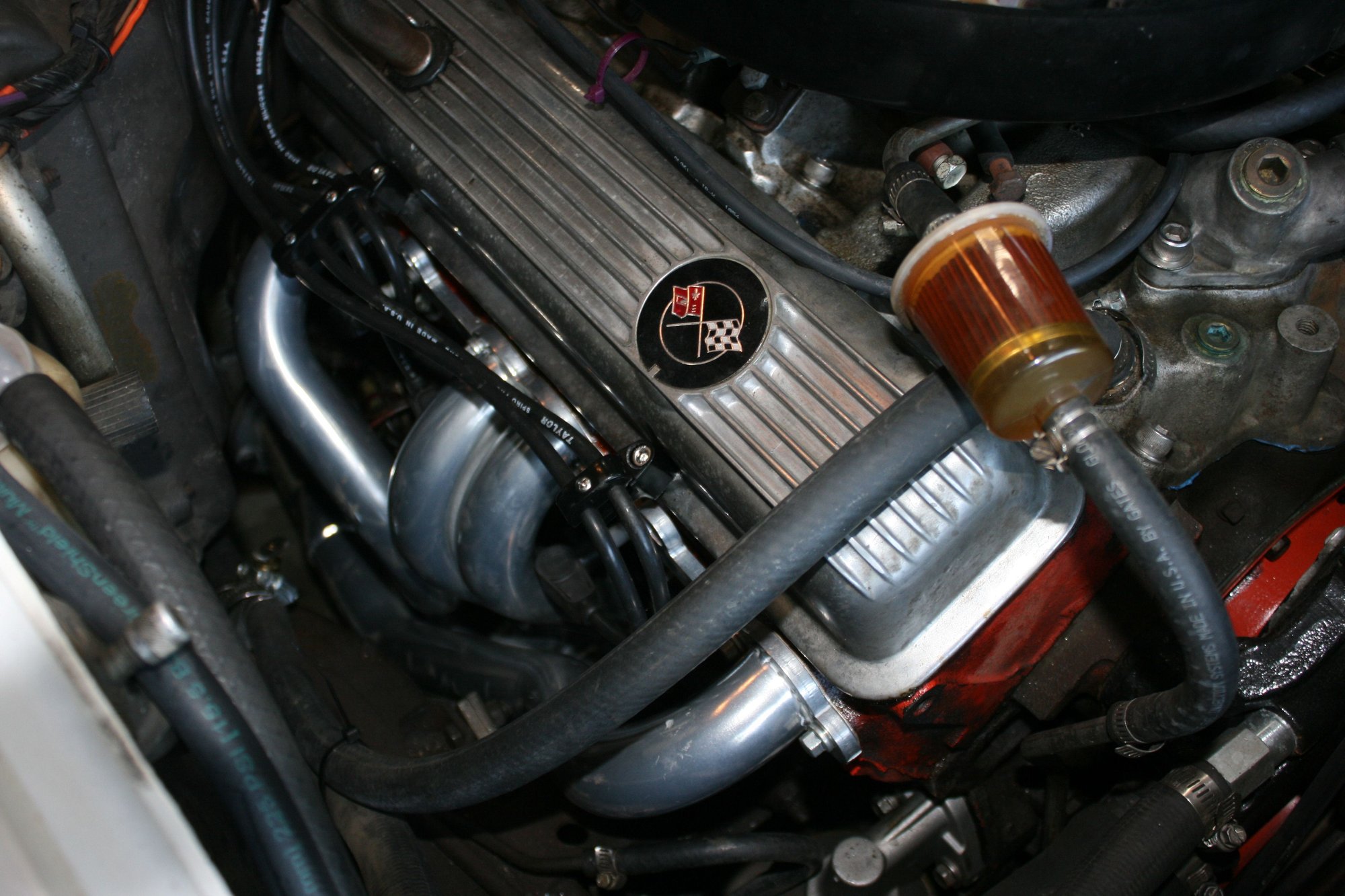

Like these and yes I need to replace the fuel filter.
