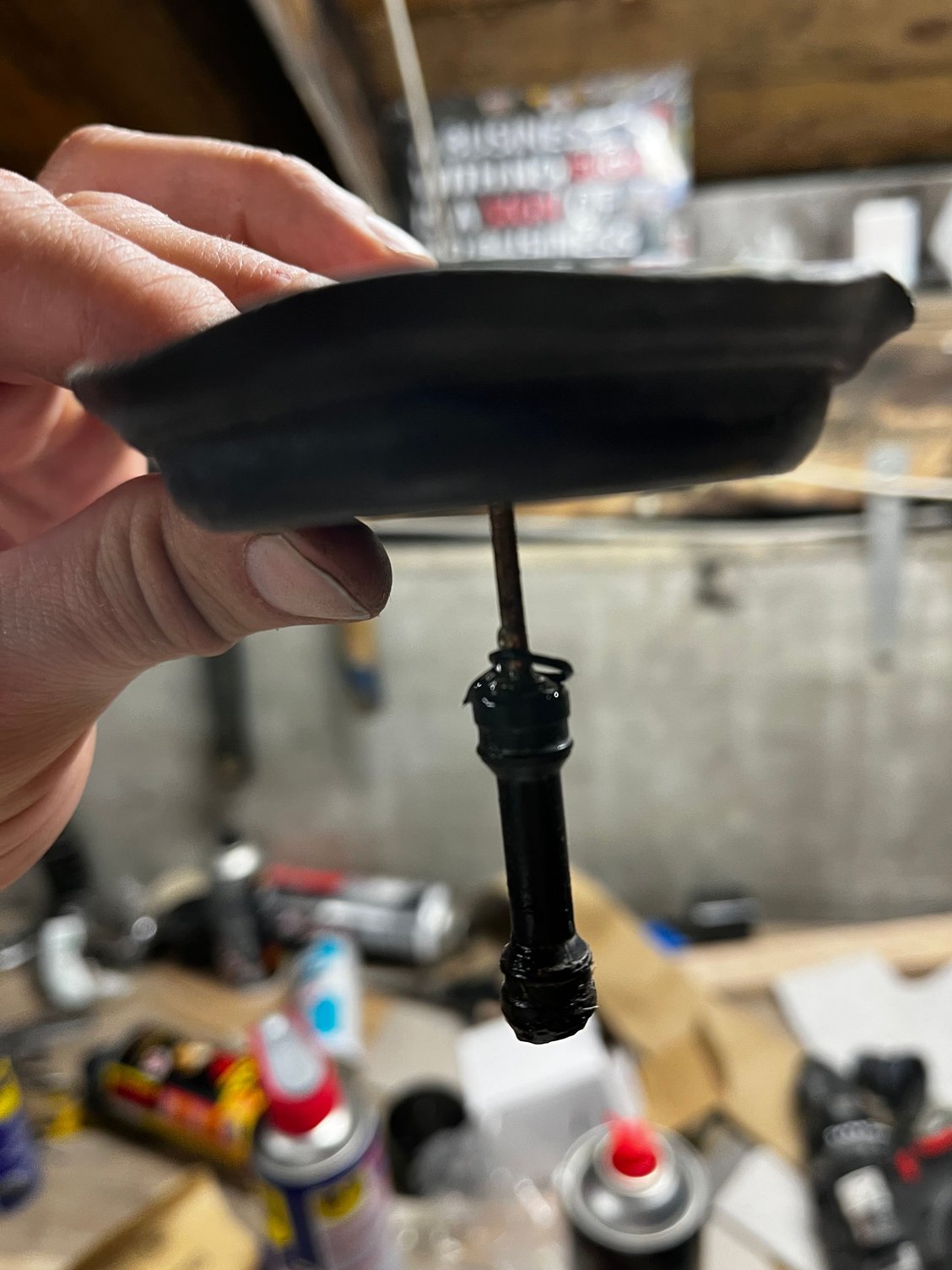

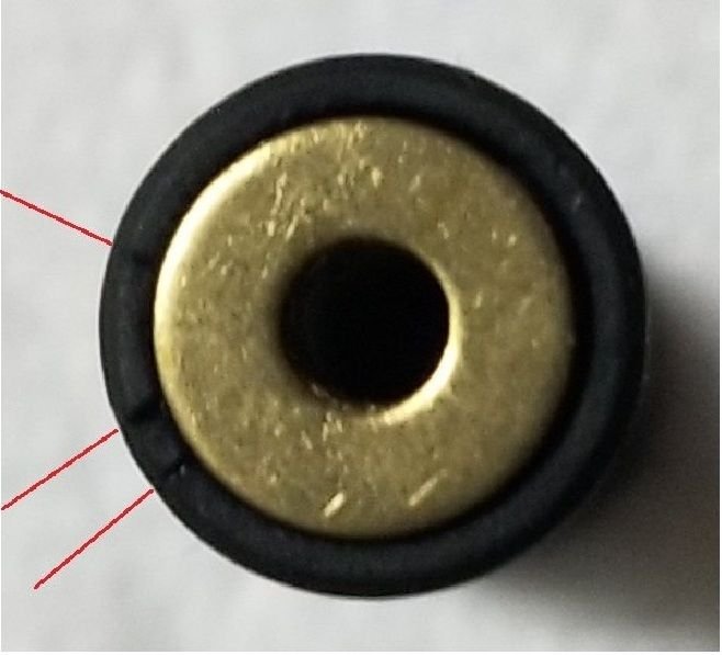

Yes you push the spool down all the way so there is just enough actuator rod showing to install the internal tooth speed washer.
After the spool is removed inspect the spool for cracks around the sealing surface.
I had one spool that had several cracks in the sealing surface.
This spool is no good!
I also used a brass washer on top and bottom of the spool just to maybe keep the "O" ring in place if the superglue let go.

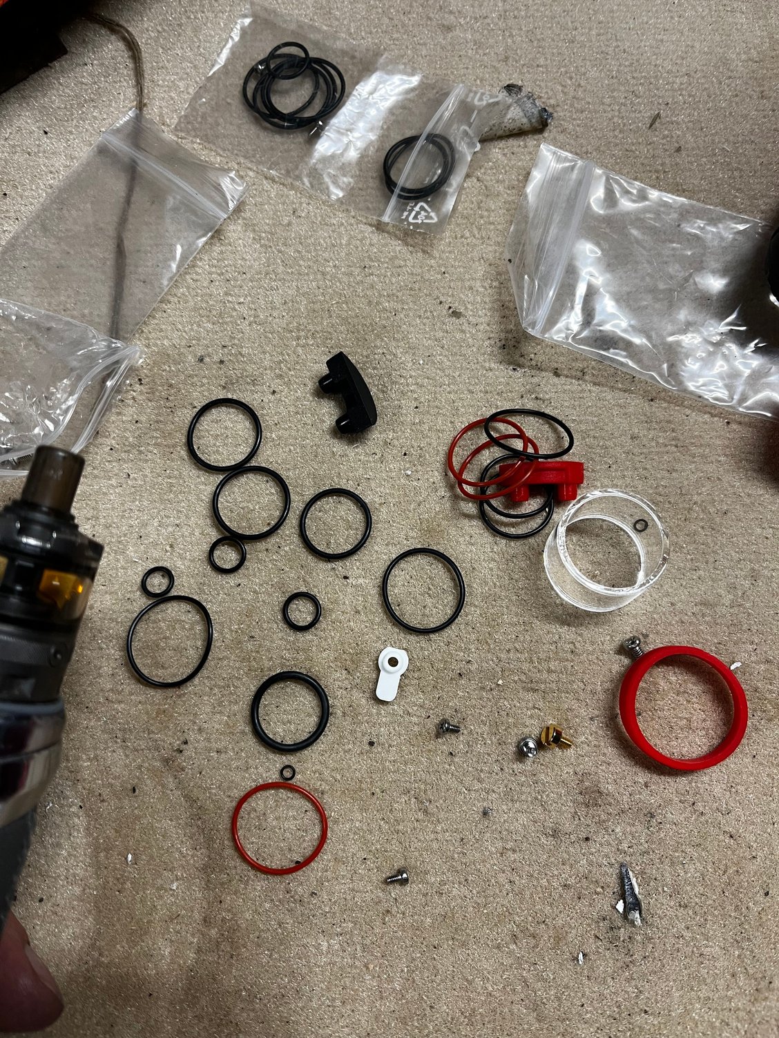

this stuff is God sent:
And if you have a friend who vapes your o-ring problems are history

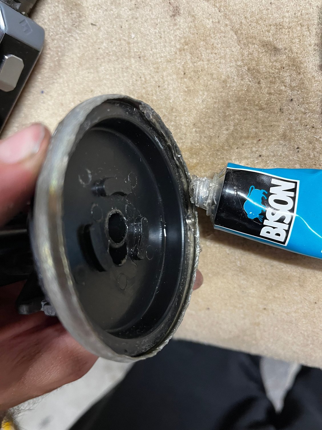

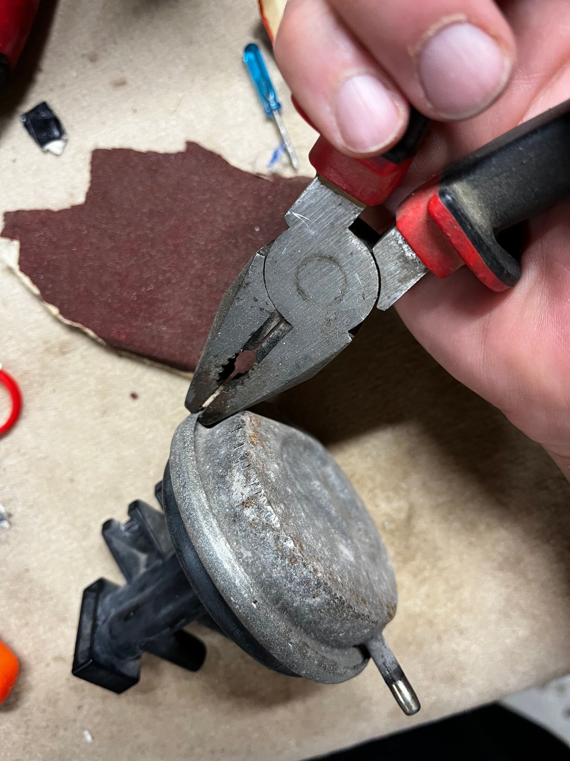

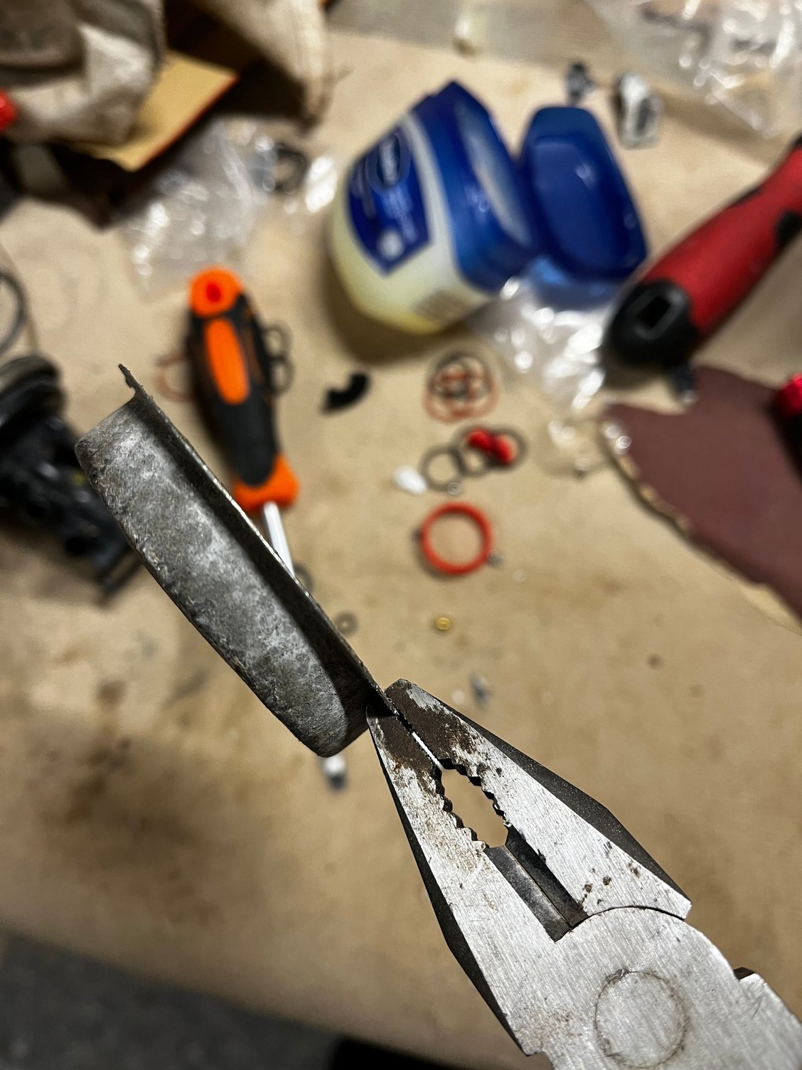

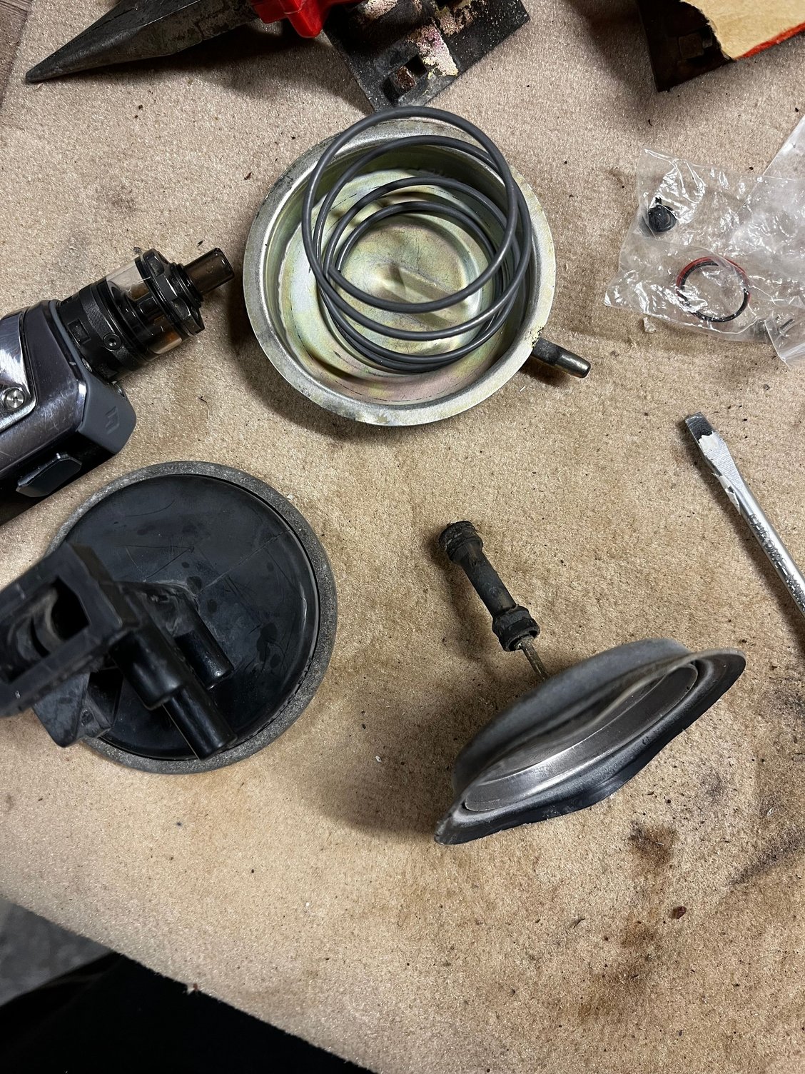

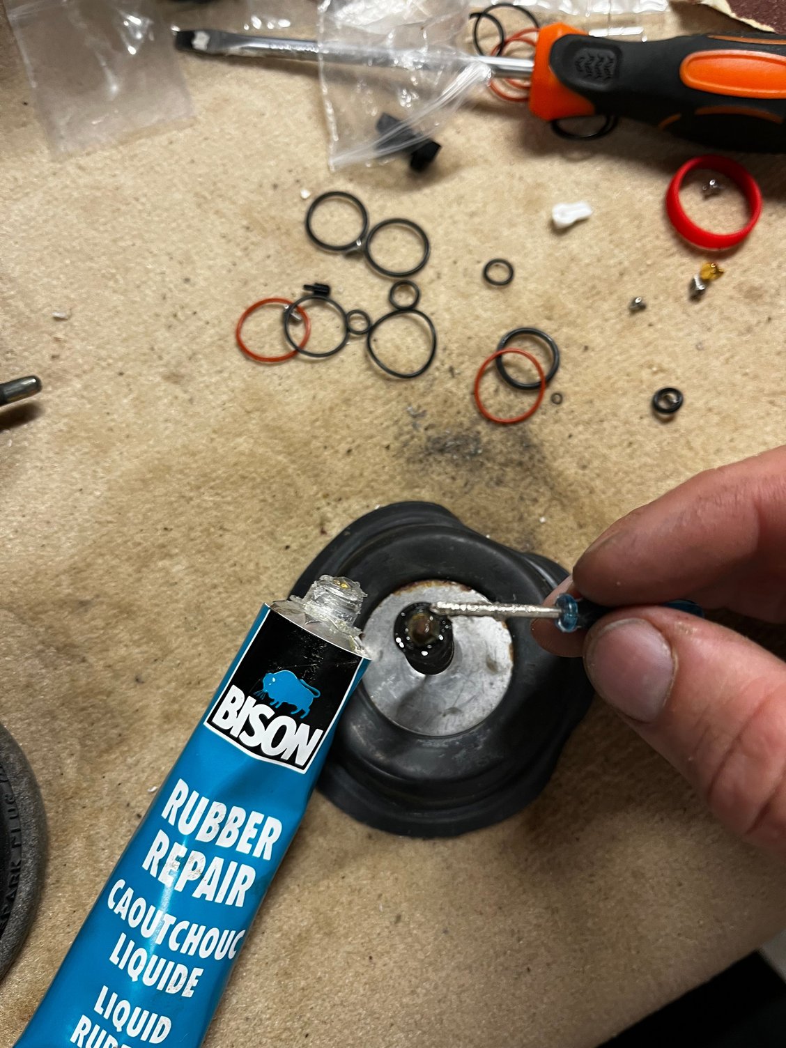

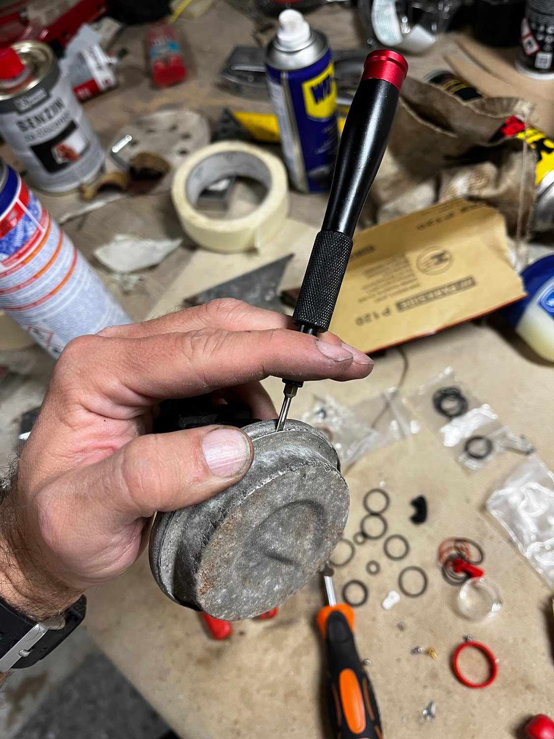

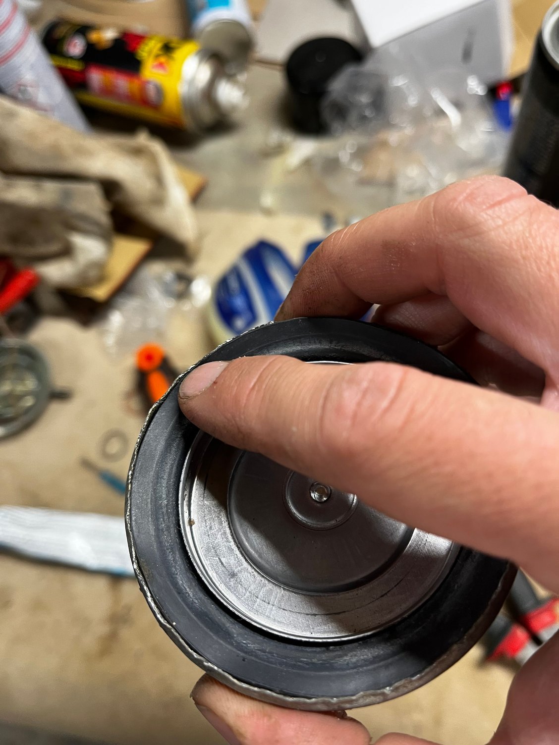

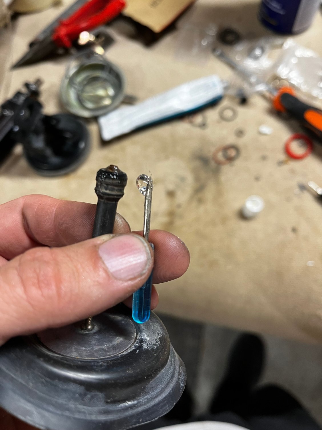

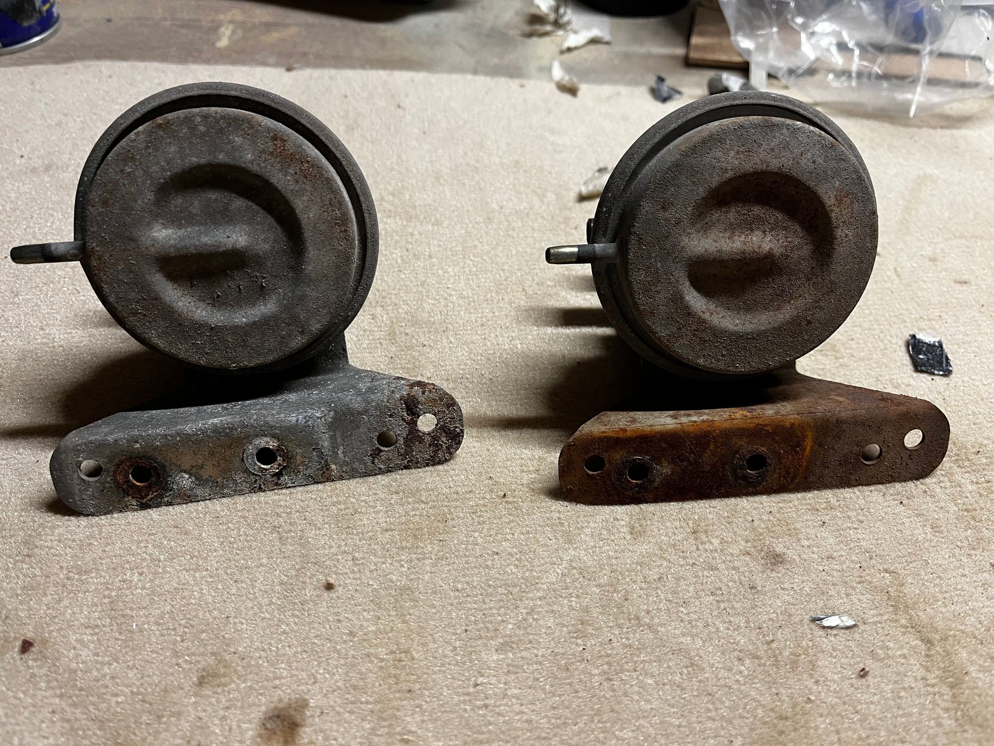

Ok, so here’s how I did it.

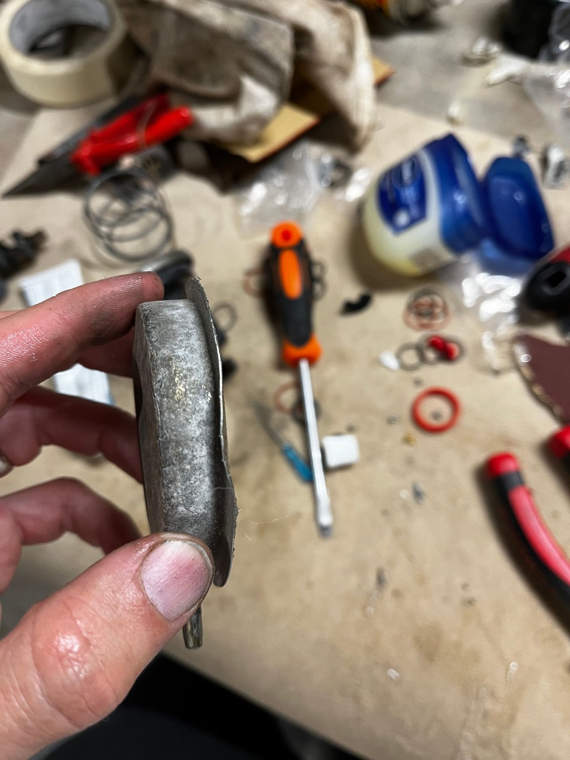

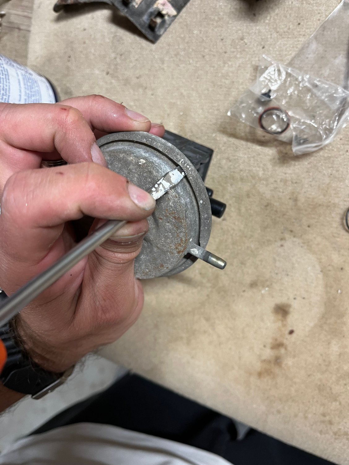

They were rusted and super oxidized. I took a flathead screwdriver and pried the ring:
and pliers were more helpfull:
used a small flathed to pry it open (carefully, don’t damage the membrane)

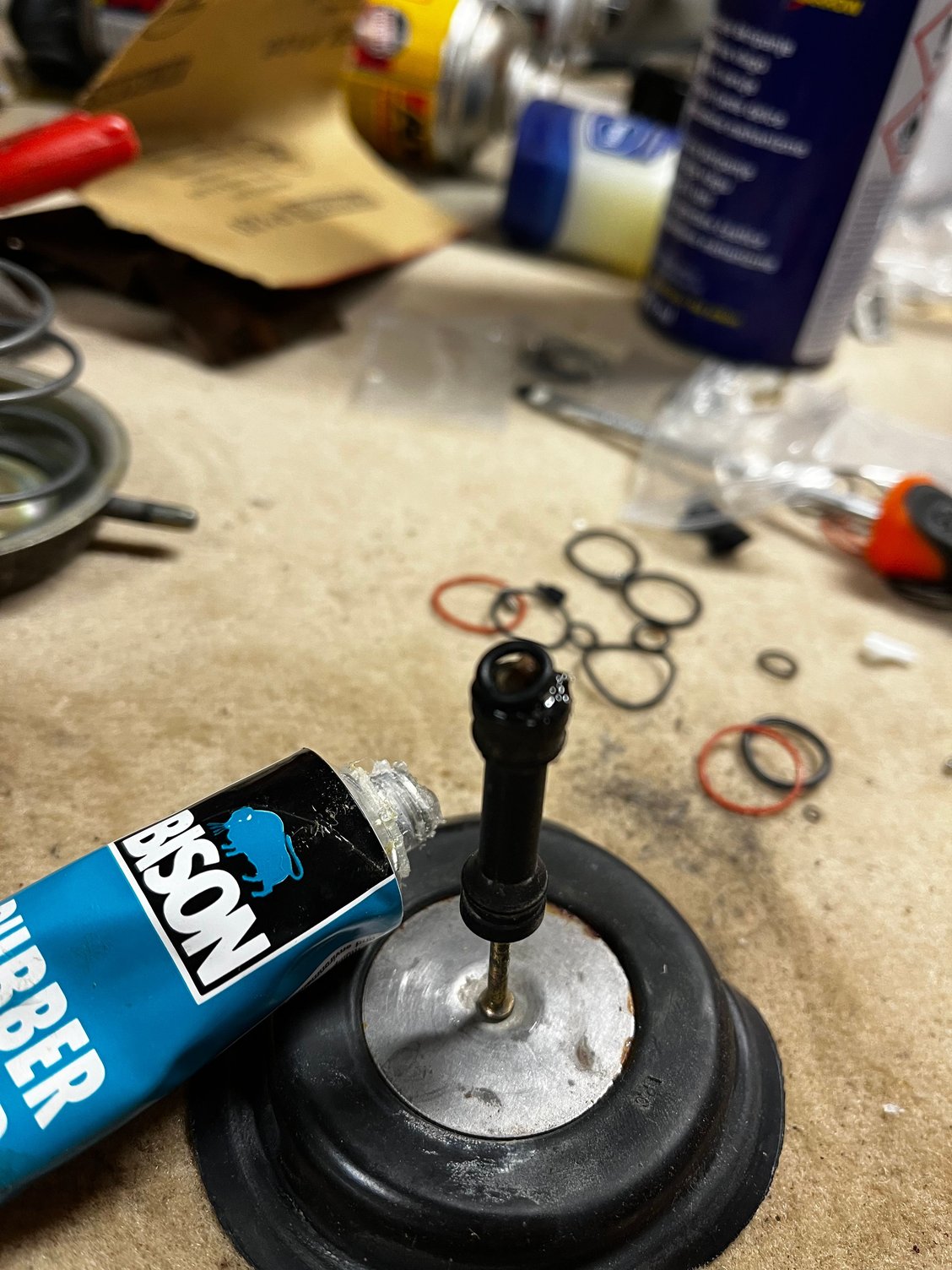

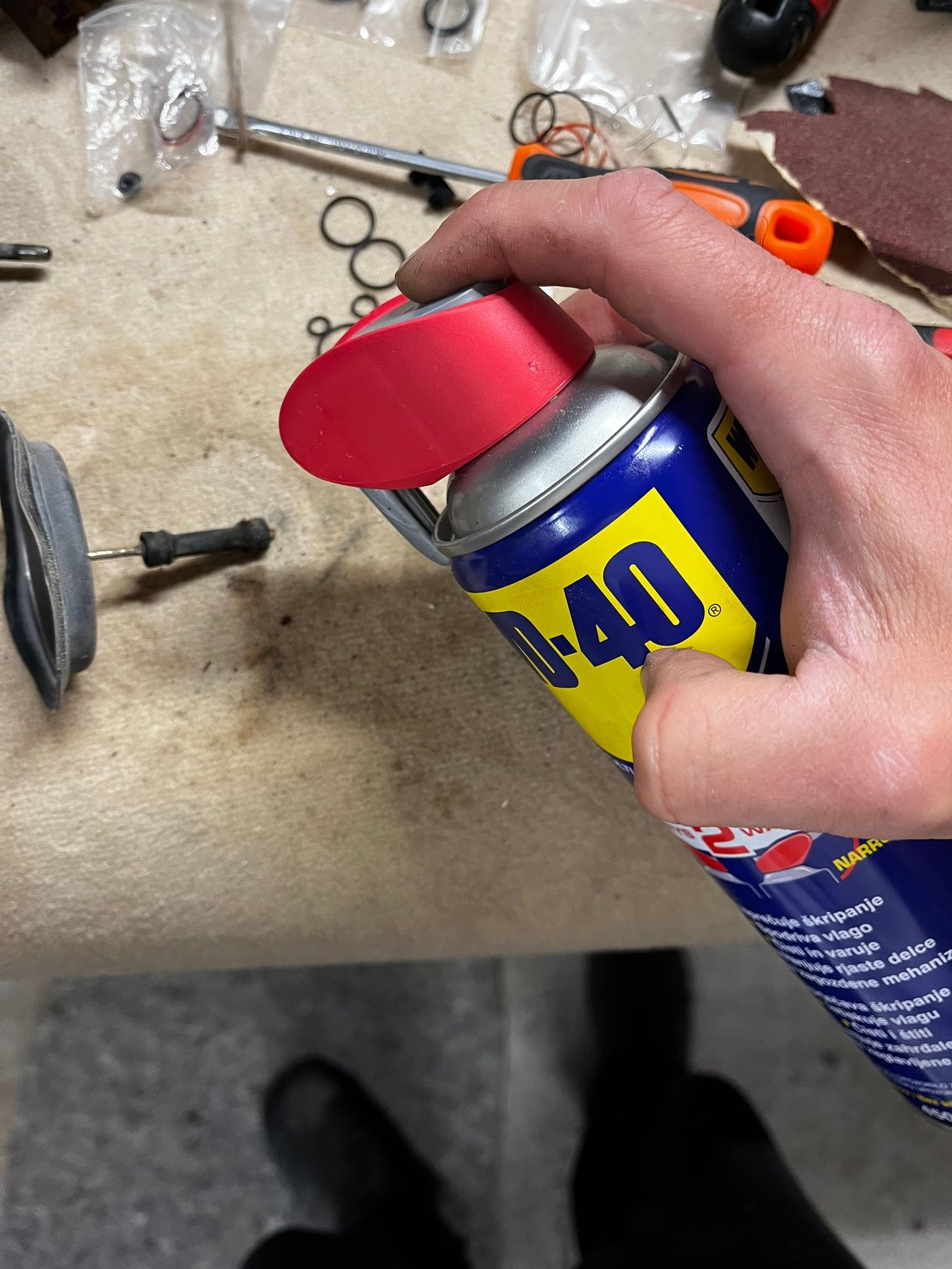

cleaned everything with WD40 and contact spray

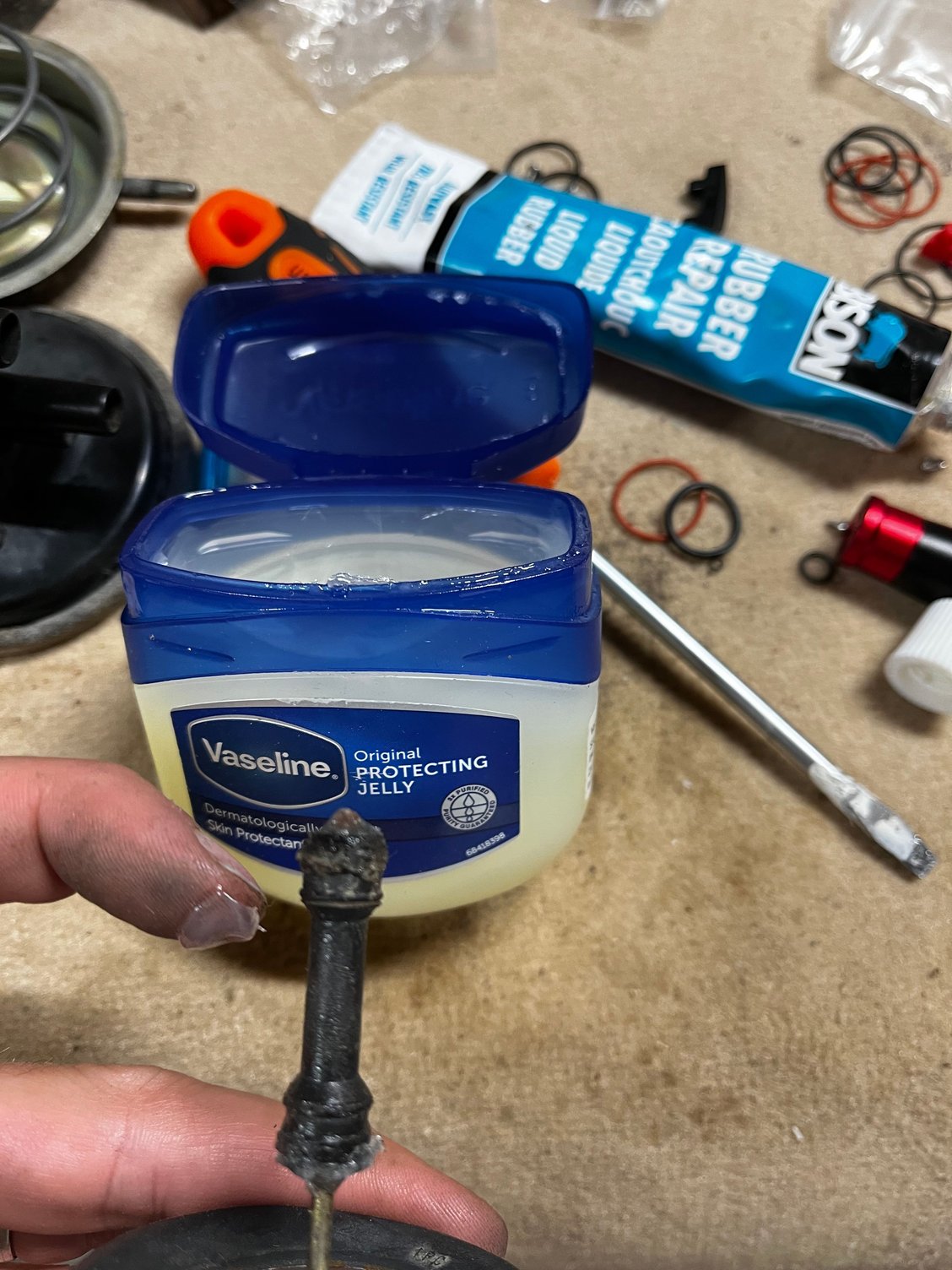

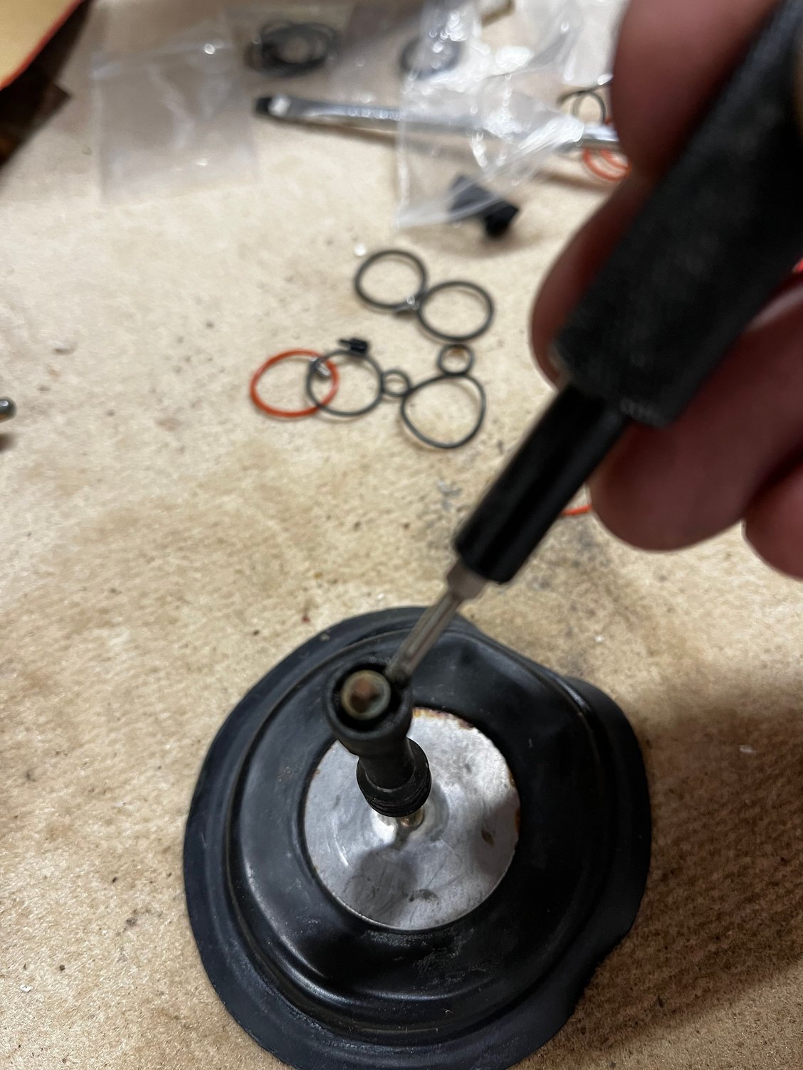

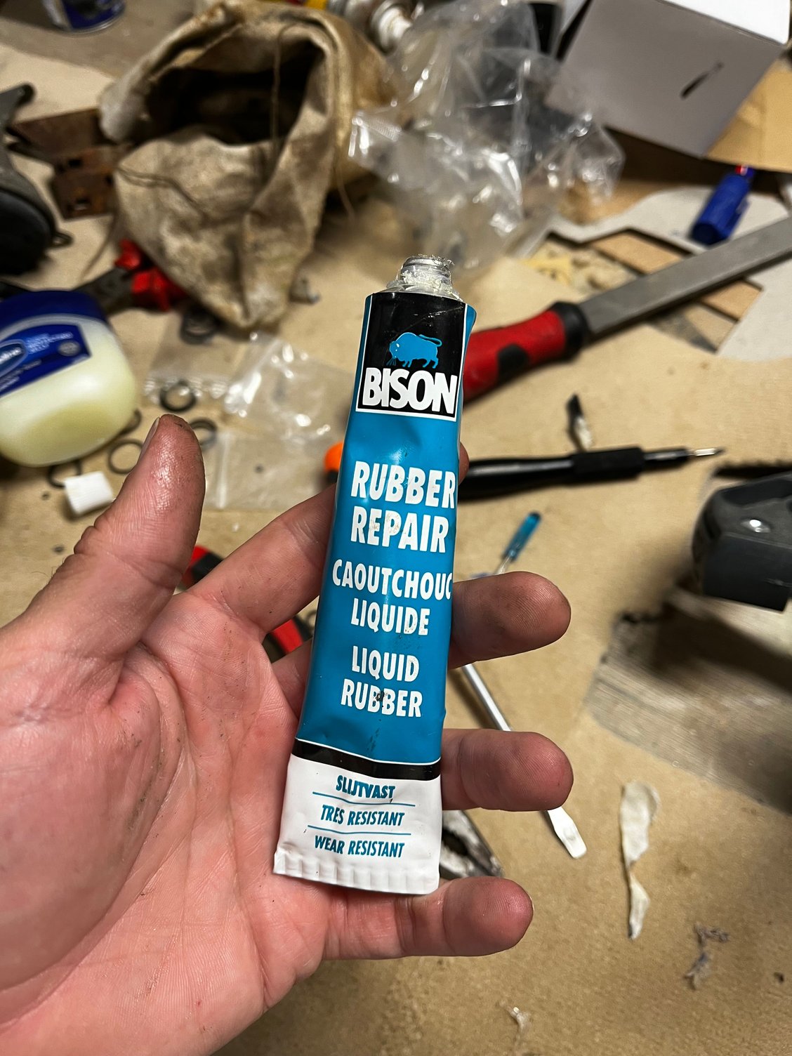

streched one o-ring to the far side and placed one on the bottom side, sealed everything with rubber gasket maker
swabed a thin film around the piston
placed a thin layer of vaseline around the piston

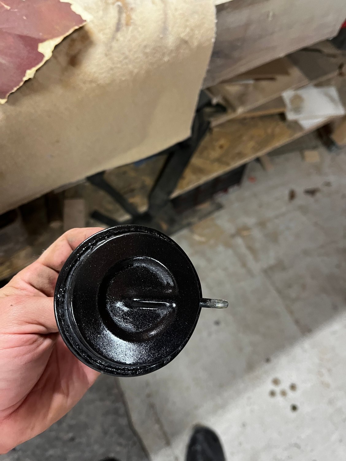

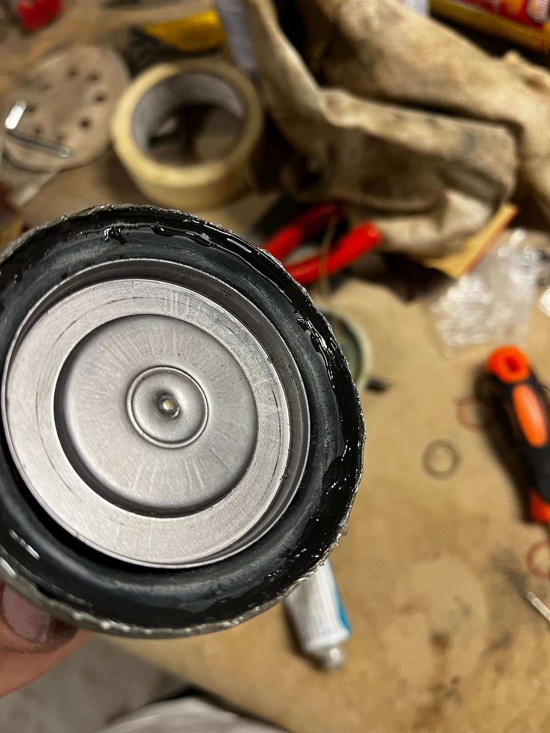

swabed a thin layer of gasket maker under and on top of the membrane and reassembled all together

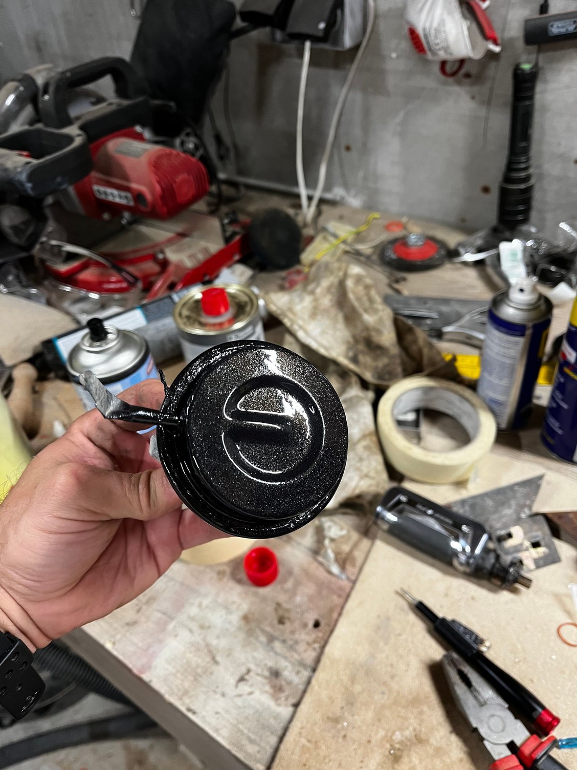

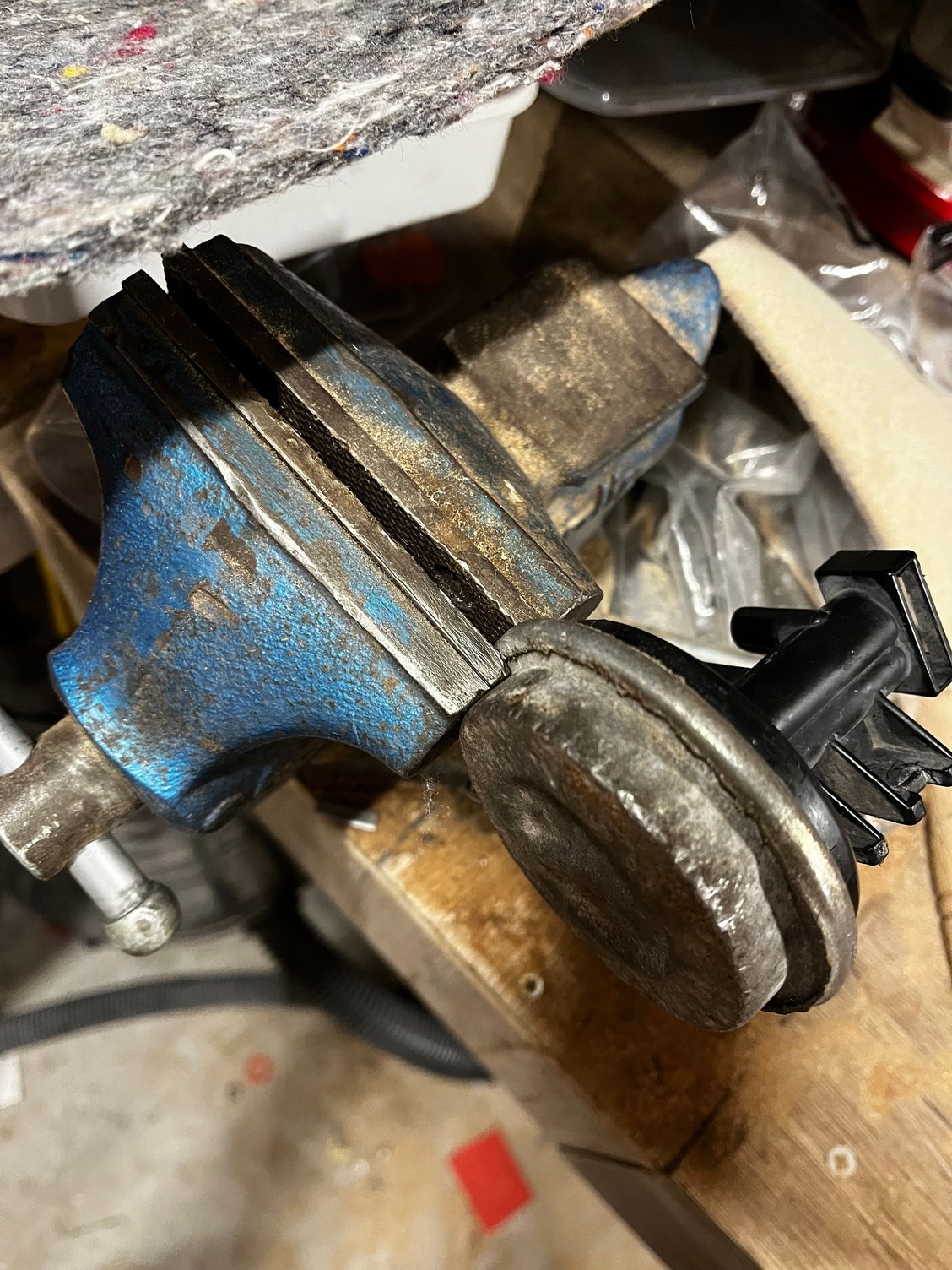

bench pressed the ring together, sanded and painted
Tested, it holds. Super happy with performance and how it turned out.
