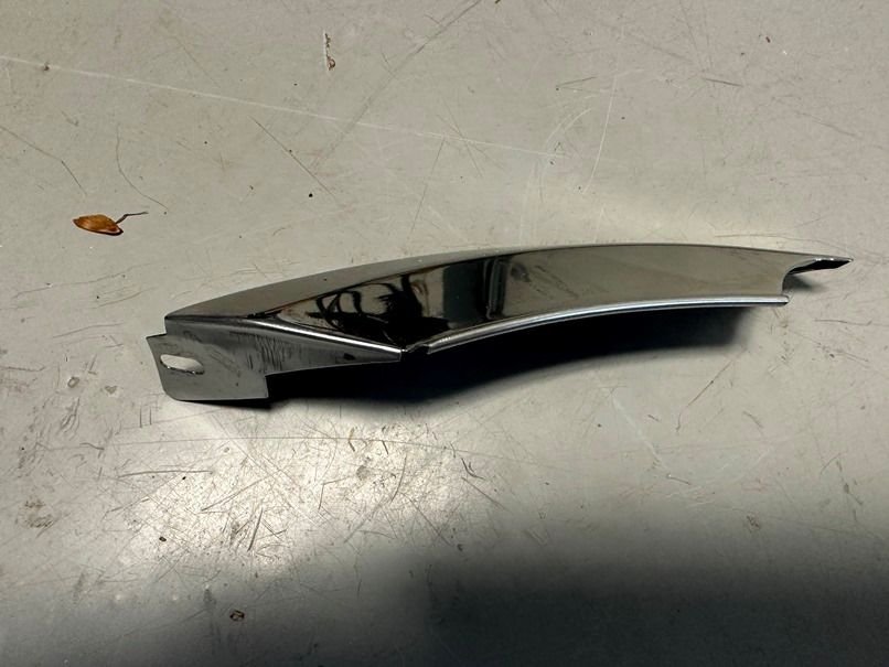

Are these really glued on from factory??

There should be a clip and a screw. I don't believe GM used any glue.

From the only picture that you shared, it looks like someone has cut off the screw flange...

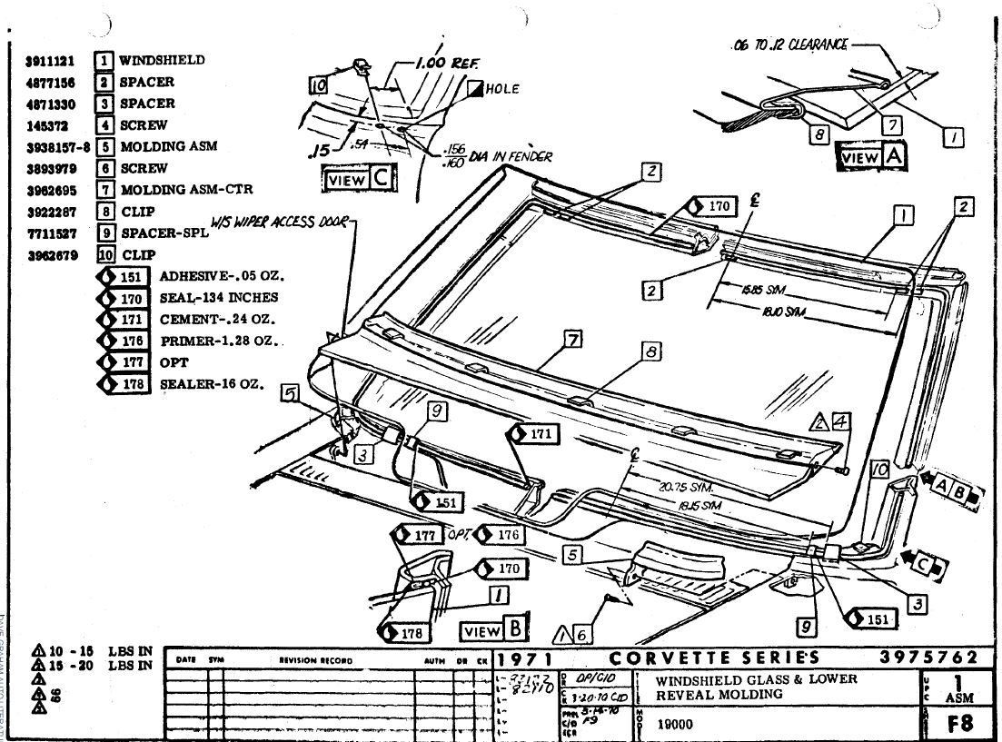

As I recall it ain't no hardware store screw either. I think I have a set bagged somewhere, screws included

https://www.corvettecentral.com/c3-6...s-outer-333106
Found this info on the screw/ 3893979 is a #8 x 3/8" black phillips trim screw with a special button head which is flat on the under side.
Photo below shows a screw and washer.... it works.
https://www.corvetteforum.com/forums...ner-piece.html
These look like the screw that is used/ call Paragon and ask:
https://www.paragoncorvette.com/prod...xoCxC0QAvD_BwE
