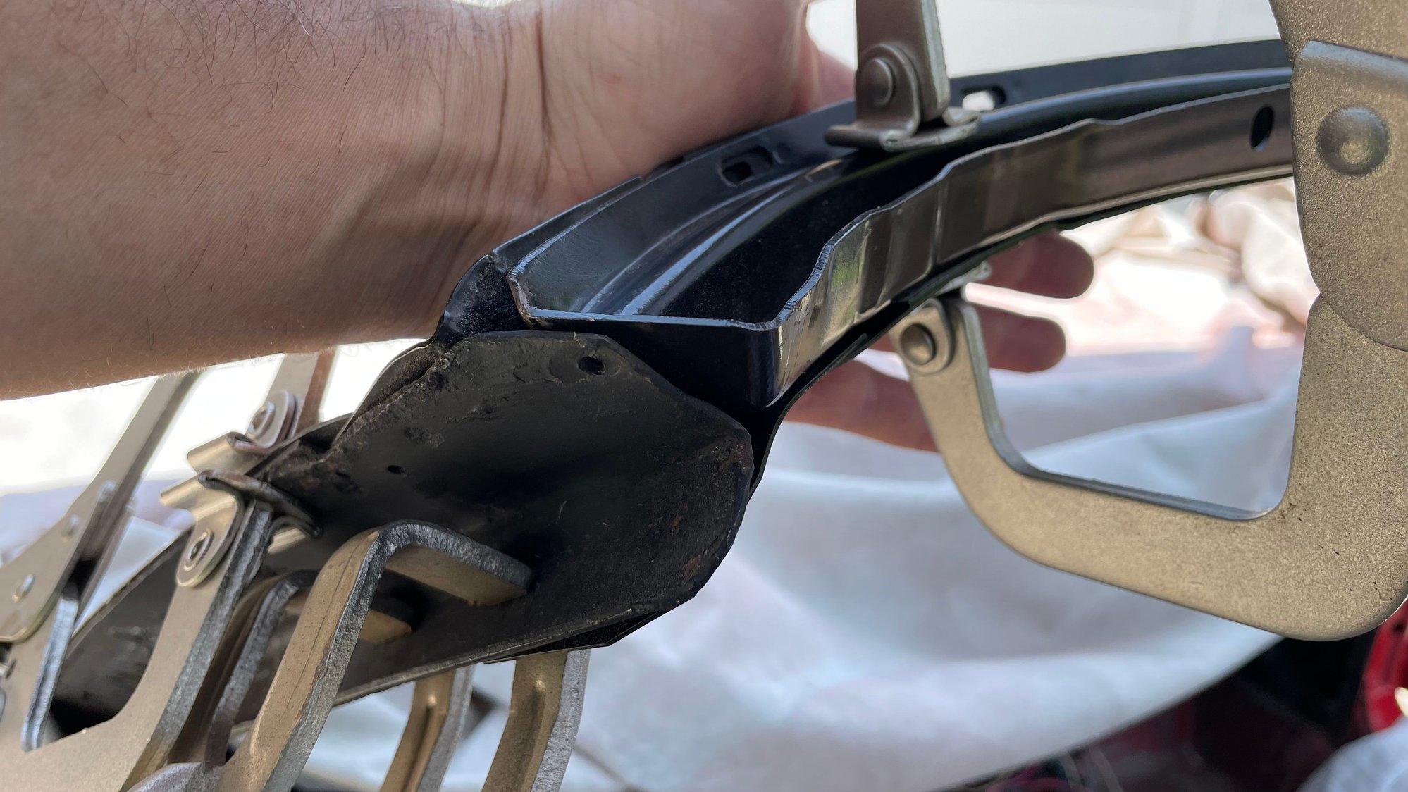

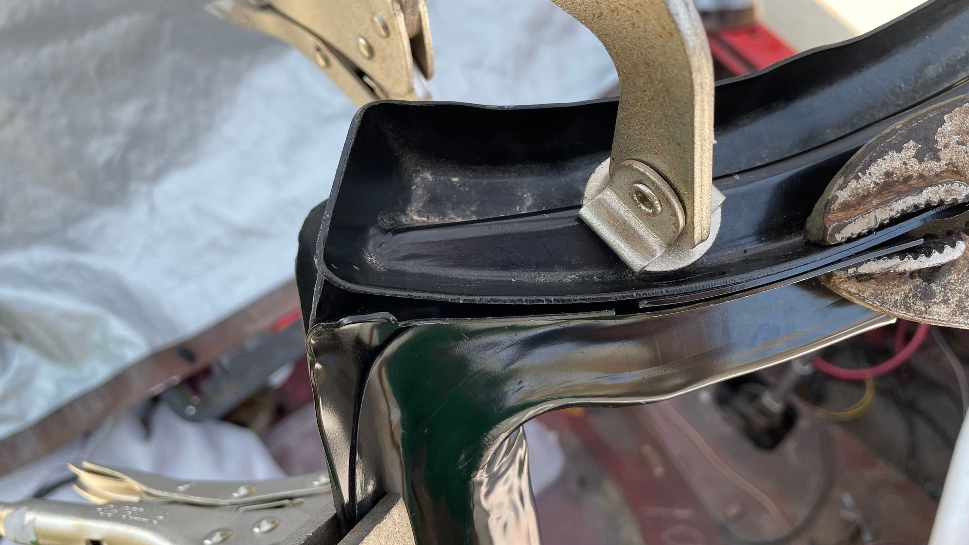

Hey guys,
My goal is to install the windshield corners and header. The two new corners and header are all from the same maker and yet, not fitting together as nicely as one might imagine (or prefer).
Some of you have a lot of experience with restoration and fitment, and I’m hoping you can help with a course of action that I can do in my home workspace.
The main issue, is getting the PS header end to sit down into the corner bracket. See photos and watch the video if possible.
https://youtu.be/SRZ3O91dqWM
Thank you for your help.
((( update- progress : https://youtu.be/ze3tiST7bek )))
(PS Comments regarding what “should/could” have been done up to this point are not as useful as ideas about where to go from here.)

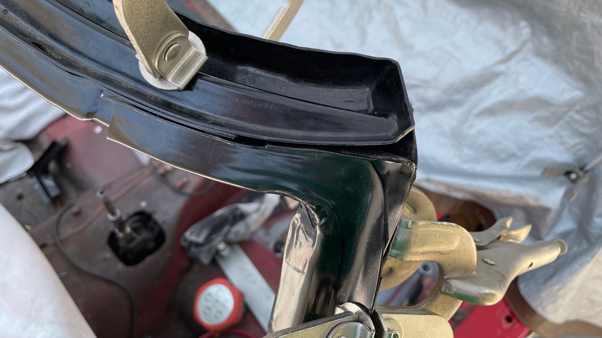

I agree 100% with your general advice. It’s been my experience that even simple tasks often require problem-solving skills and experimenting.
i did make some progress by finding my disassembly videos and using those as a guide. Then I did some grinding on the corners until the fit was much better.
see this video for details:

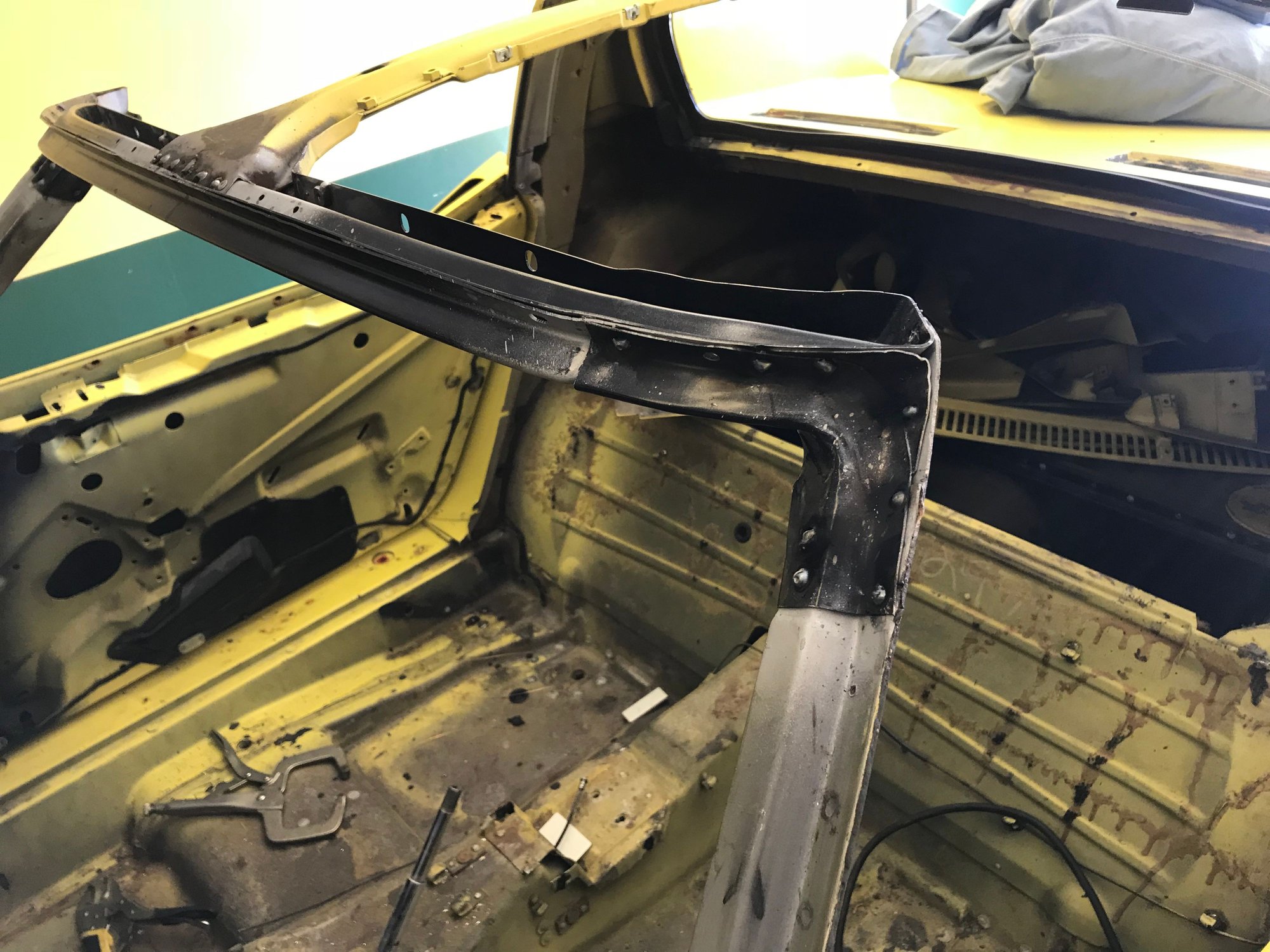

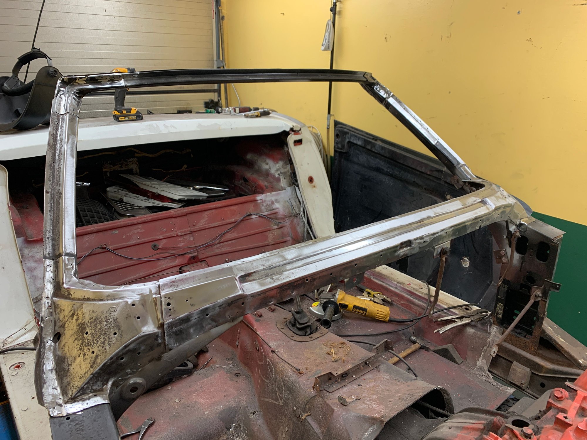

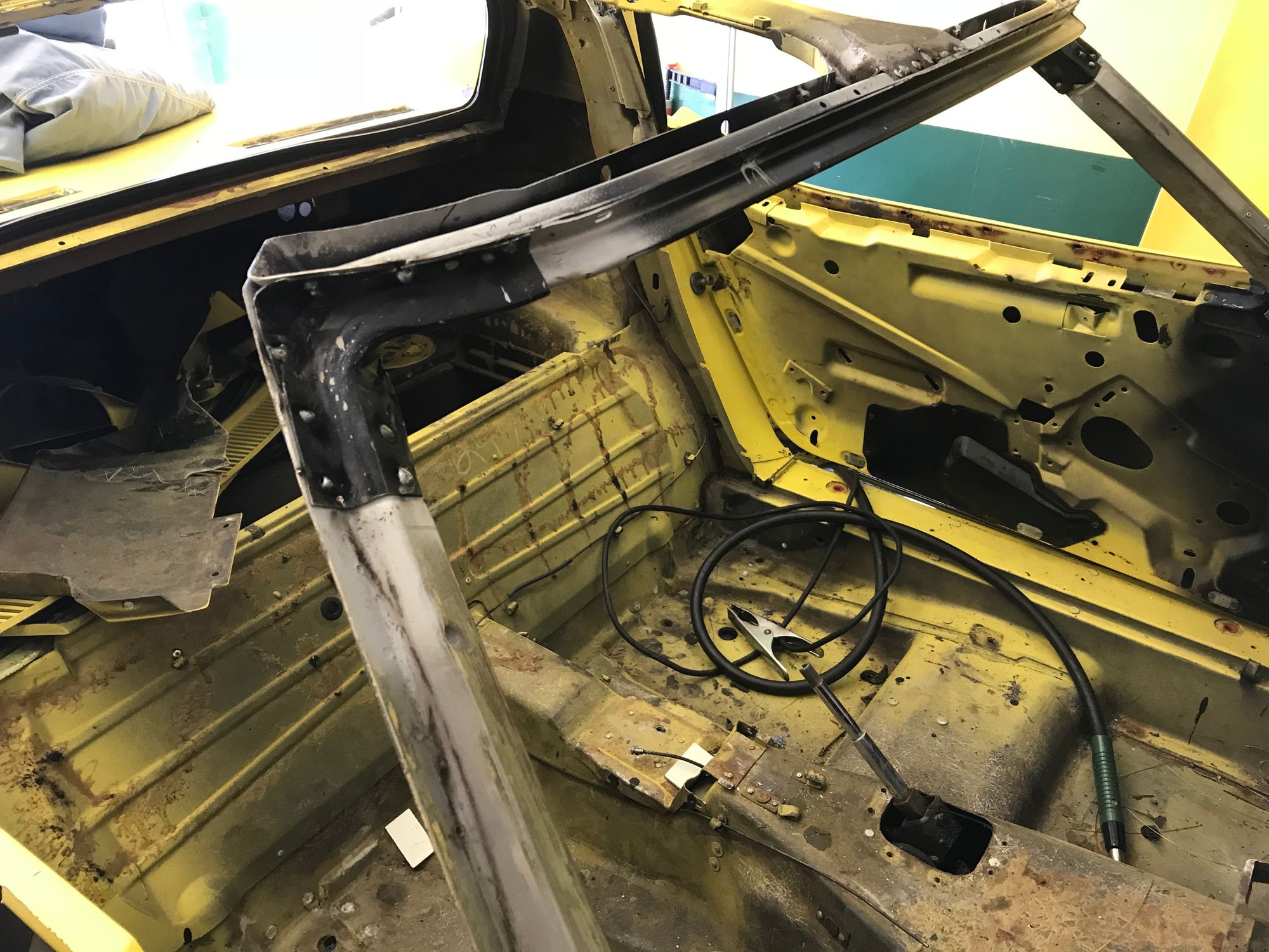

Originally Posted by K-Dog
Yes - I plan to fit the windshield glass and the hard and soft tops before welding. I’ll get it with screws first, just to test, then glue, weld and seal. The doors are completely apart, so I’ll have to trust that the glass will fit, but as you mentioned, both the weatherstripping and the glass have some adjustability built in.
thanks for replying
I have replaced the top bar and corners on my 69 coupe and my 71 convertible. I started with a lot of mesurements and positioned the top bar with the old one as reference, then tacked it temporarly. With the top bar tacked in place I trimmed and massaged the corners to fit. Checked measurements and windshield fitment, then final welding.
Thanks for the pics and description.
Would you agree that the top lip of the header aligns with the top of the A-pilars? That appears to be what I’m seeing - and what I found on mine.
How did you get the corners to fit back into the very top, where all 3 (header, corner, pilar) come together? The corners I got seem to be rounded where they need to fit into that triangular area.
thanks
Yes, agree. Also check with the chrome plated end covers. I fitted the corners with clamps and pressed into the triangular area with a chisel. The area was then filled with body seal before final paint.
