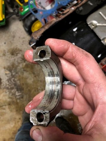

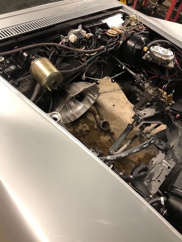

Hey everyone i got a update of course its not a good one or one im happy about but i need to move forward.
pulled the motor, that was fun, ill need a engine leveler when it goes back in.
started to dissemble and check to see if its able to crank over as i go (still locked up)
i got 2 pistons out and i still cant crank the engine over, (heads off)
the rod bearings have some wear. pics attached.
i got to get the rest apart and ill update again.
thanks for everyones time and comments
That rod bearing got dry and scrubbed past the babbit into the brass......my fear is you will find worse looking ones as you go.

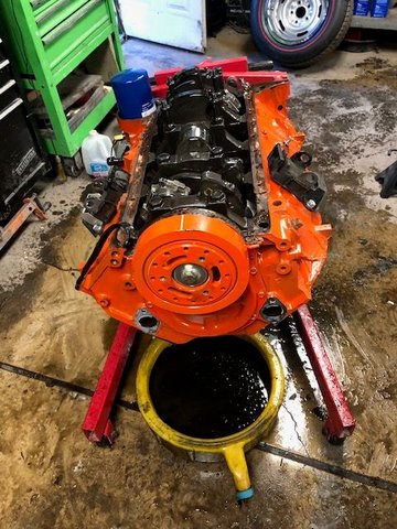

ok. got the engine down to the bare block.
the crank was what was holding it back.
a wear line down the mains, and most rod wear towards the back near oil pump.
i had 60 pounds of oil pressure while this engine was running.
what causes this? when the engine was assembled it rotated nicely.
crank is 20/20 already and needs work after this,looks like ill be ordering a eagle crank.
since a machine shop is in my future, what will it take to put a roller cam with around the same specs as the stock 427/390 specs? never ran a roller cam but always wanted to.
engine is 30 over and the cylinders look great still
cam pulled out very nice and all but number 5 exhaust lifter came out of the block without a fight.
I suspect the journals were not square.....
Oil pressure can look just fine and the journals can scrub themselves to death.....
What were the main and rod bearing clearances?
You need .003+ and .002+ on a BBC and that is the minimum....I like .0035 and .0025 respectively.....
I would have this block line honed.
Also....inspect the cam bearings and their clocking....
If going roller....please do yourself a favor and put a real cam in it.....the 427/390 cam had pathetic specs and just about anything else you put in there will make more power.....if you go with a roller that small it defeats the purpose of even having a roller....
A roller will need a roller spring setup....
I recommend Scat over Eagle right now.....used to be the other way around but I have built three Scat crank engines in the last 6 months....the cranks and rods are beautiful and on the money with STD. Bearings....
Eagle cranks almost always run fat and almost always need X bearings for proper clearance....and they don't sell them that way unless you buy direct and specify them....
Jebby

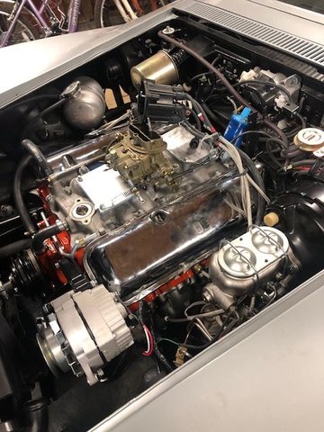

Heres a update on the engine issue.
I tore the engine apart and took it to the machine shop. bought a new Scat Crank, had everything balanced, checked, new freeze plugs, cam bearings, they did a hone and cleaning.
i kept the hydraulic flat tappet cam, I did wanna go roller but i had this cam already.
assembled engine,
reinstalled in car set timing at 10btdc
Broke cam in 25 minutes at 2500 RPM.
engine never got over 210 degrees. runs great so far.
im still on the center carb only, gotta set timing, dwell and then start introducing the other carbs and go from there. so far the second round is going good so thats my update.
im curious on what everyone recommends for my initial timing, ive read everywhere from 4-12 BTDC. specs are: 69 427 with tri power. stock style cam, stock heads, and i think it was .250 dome on pistons. this car was not a tri power car, but i found a NOS one and know it will take time tuning, should be fun. pic attached right after i got engine installed.
i used the eastwood chevy orange quart and hardener and sprayed with my auto paint gun. very nice paint and laid great.
