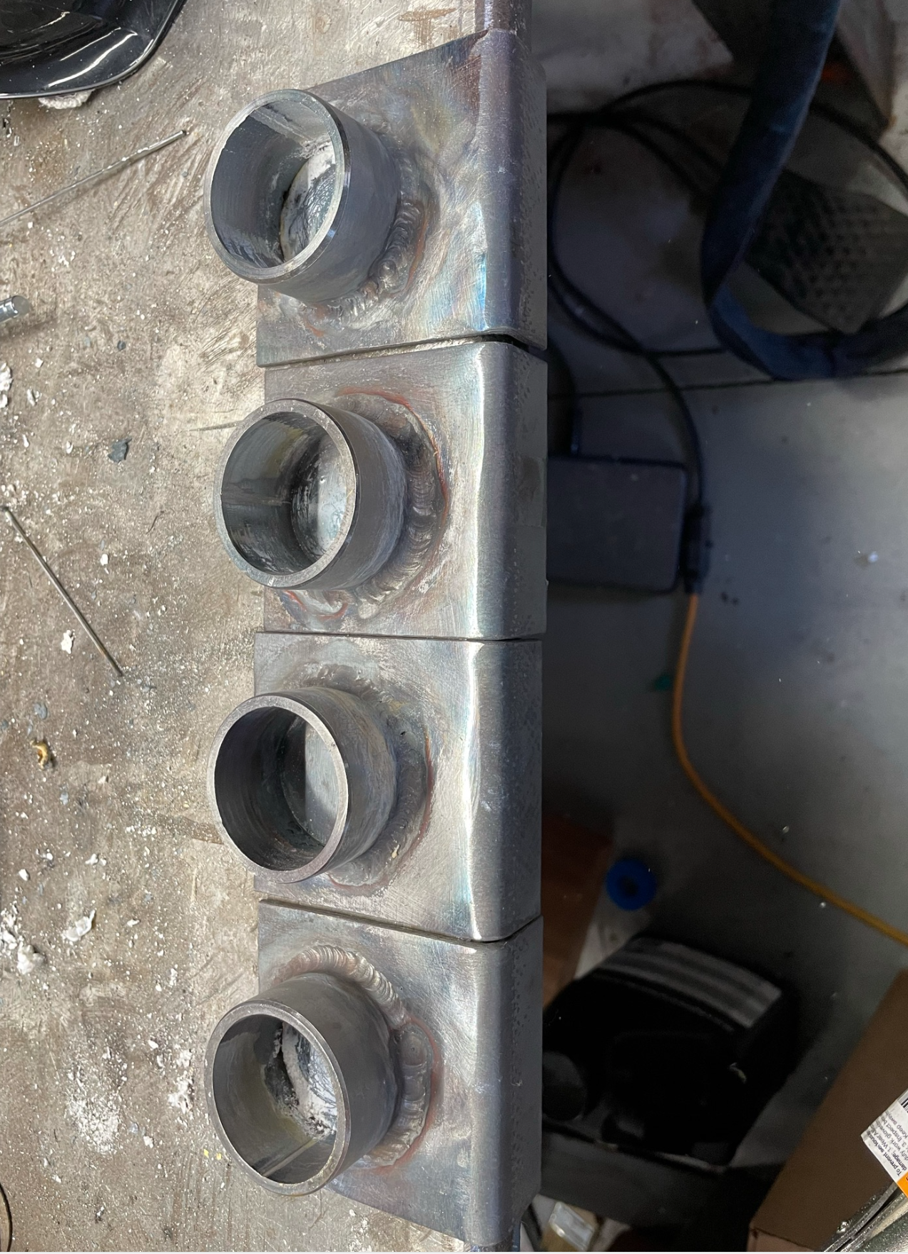

Anyway.... I used a 2 post to lift my body. Not sure how you'd use a 4 post for that! I didn't use straps, I made adapters for the lift arms and raised it with the lift. They look like this:
Then I rolled the frame out and lowered the body onto a dolly. (and in reverse to get it back on the frame)

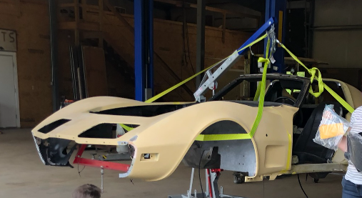

Bonus lift: When I picked up my car from the auction I had to improvise because I only had 24 hours to move it, and whatever the local Harbor Freight had in stock. Here it is lifted by a strap and an engine hoist. Not recommended, but nothing broke! (They wouldn't let me use that lift in the background!)

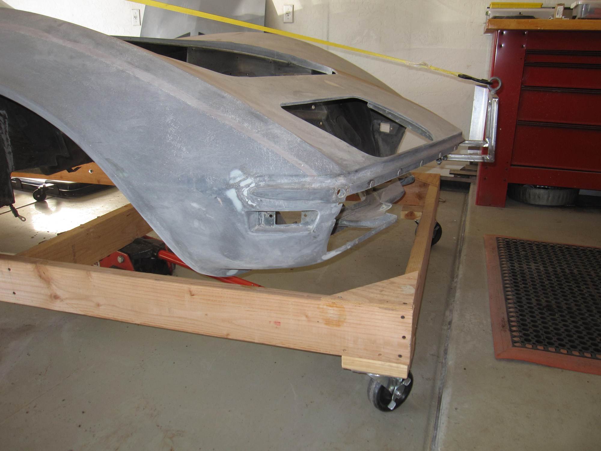

The body can be safely supported on a wooden dolly. Don’t overthink the design. 2x6s work fine with 2x4 cross braces. Be sure to include the ability to support the nose.

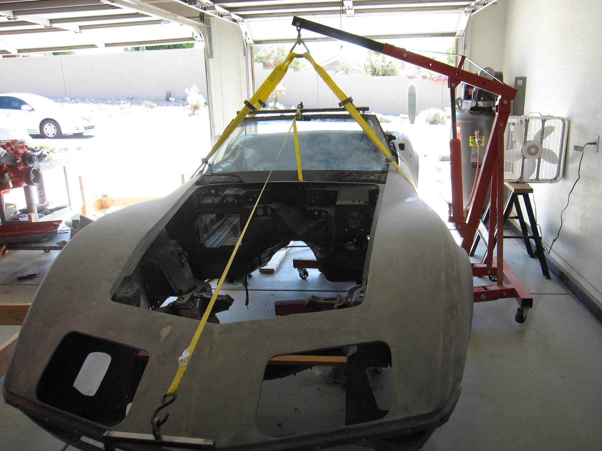

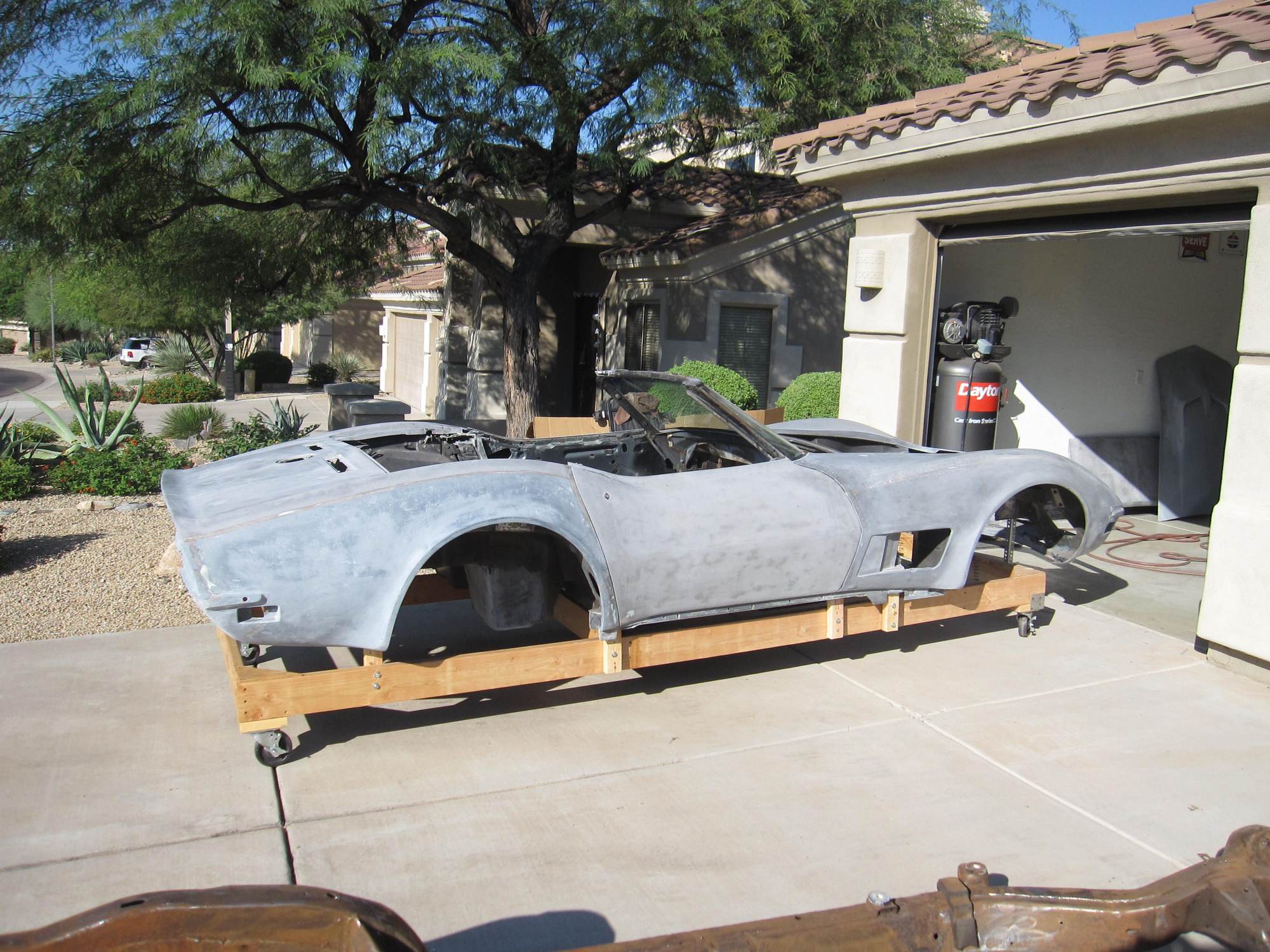

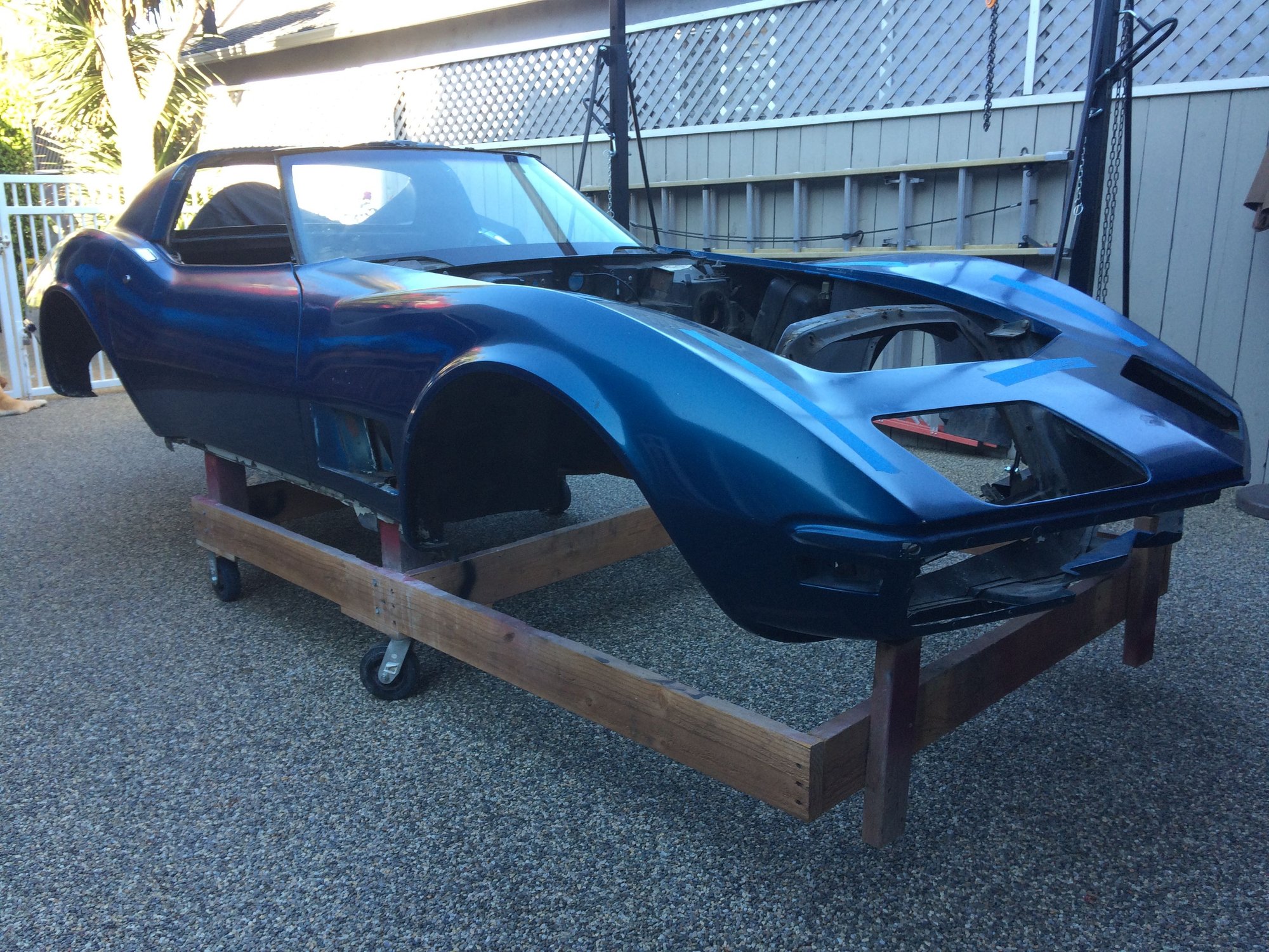

Here is my body off

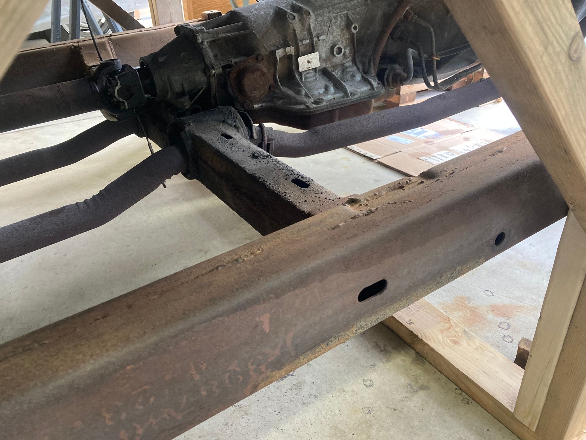

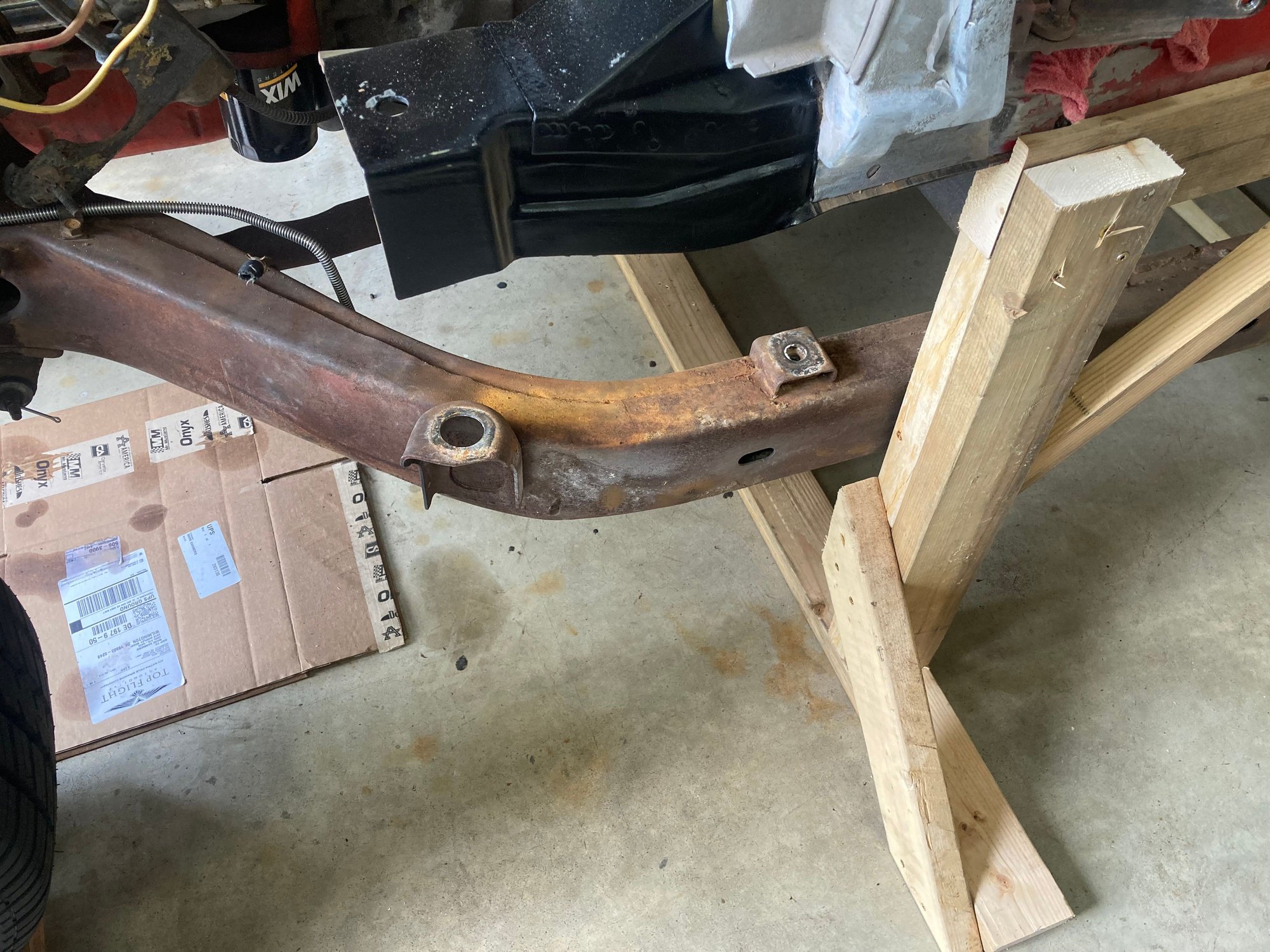

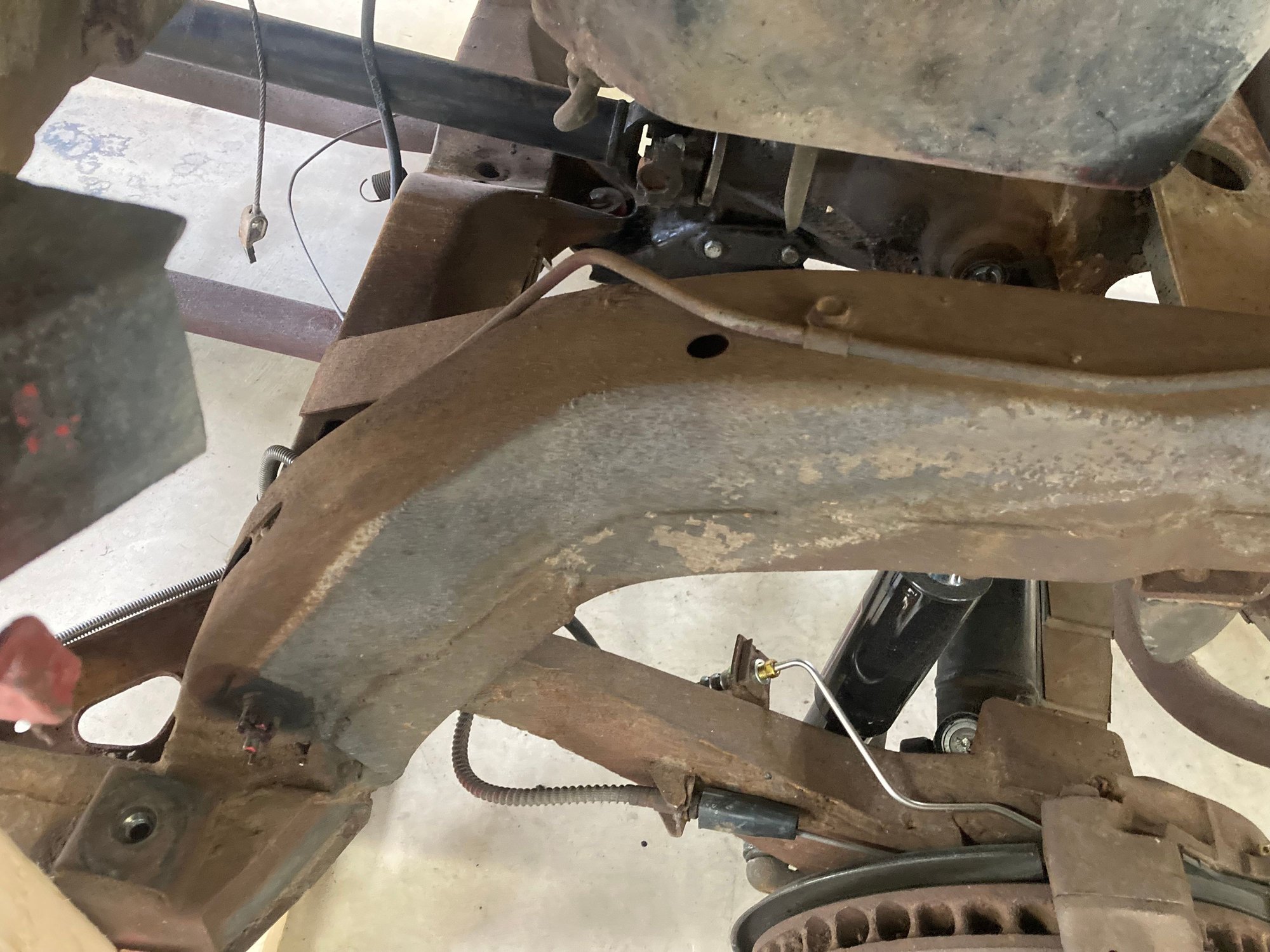

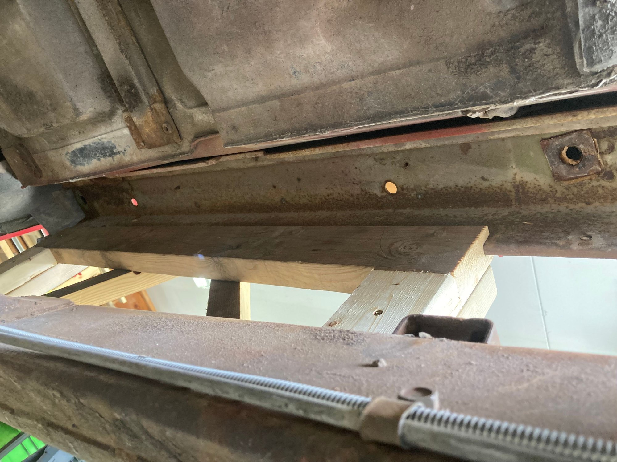

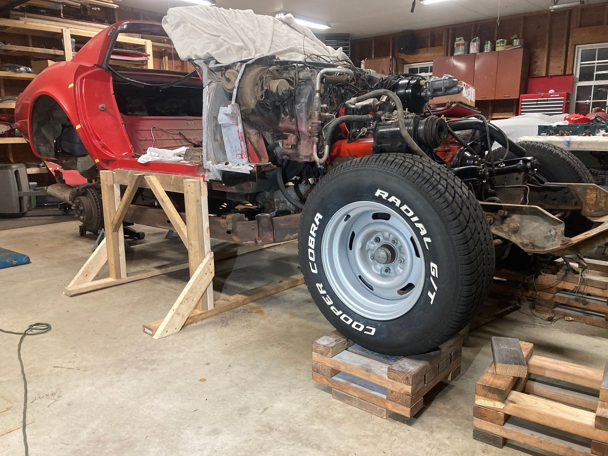

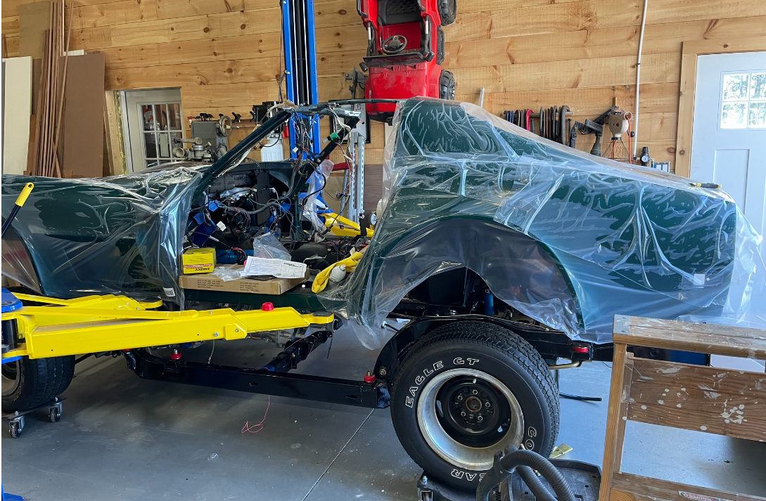

I wish I had a lift when I separated the body from the chassis, but where there is a will there is a way. Instead of lifting the body, I lowered the frame. First I built a set of blocks that were about 14" tall and put them under the wheels. Then I disconnected everything connecting the frame to the body. Next I built a simple wooden structure that would support the body when I lowered the frame. Finally, I lowered the frame until it was sitting on the wheels. This gave me full access to replace the fuel and brake lines, the gas tank, and it made removal of the trailing arms a piece of cake. The front bushings were shot. Now, as you can see, the front clip was removed prior to doing this, but adding a simple support to that area should be a piece of cake.
I did not detail the frame or the suspension, but I did replace all of the worn out parts while it was separated. And if I needed to, I could roll the frame out from under the body for even better access. When I was done all I had to do was to jack the frame back up into place. I took my time and things went very well.
Warning: Advice about to be given...The vast majority of the body work should be done after the car is securely bolted to the frame, after the door hinges are known to be in great shape, and after the car is firmly sitting on the wheels/suspension.
Her it is before it was totally lowered down.
Gave me plenty of access to the body mounts.
Access to the trailing arm bolts made removal a breeze.
Plenty of room to get to the tranny even with the body over it.
Detail of the way I used the outside edge of the birdcage as the main support.
Here is another view of the main support I built that grabbed the outside bottom edge of the birdcage. I was very surprised to see them looking so good.
This proved to be a very stable support for the body as I worked on the chassis. Trust me, I shook it from side to side and back and forth to make sure it was not going to go anywhere. After I got it all bolted back together, I started the paint and body work.

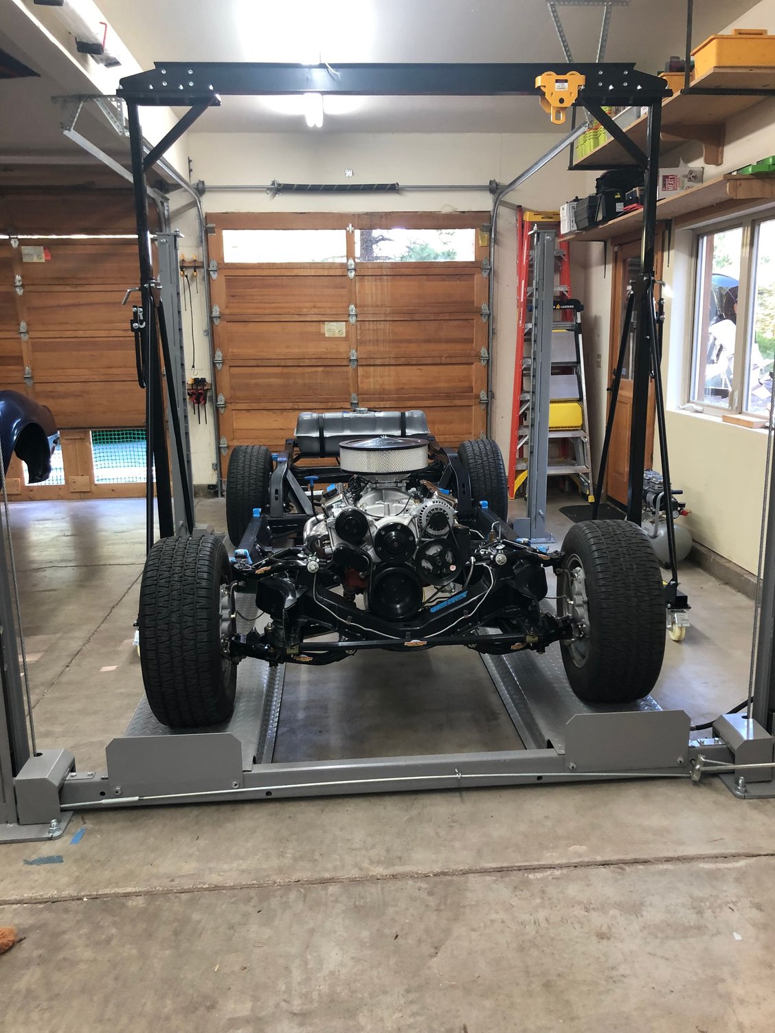

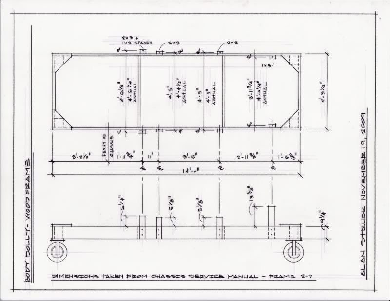

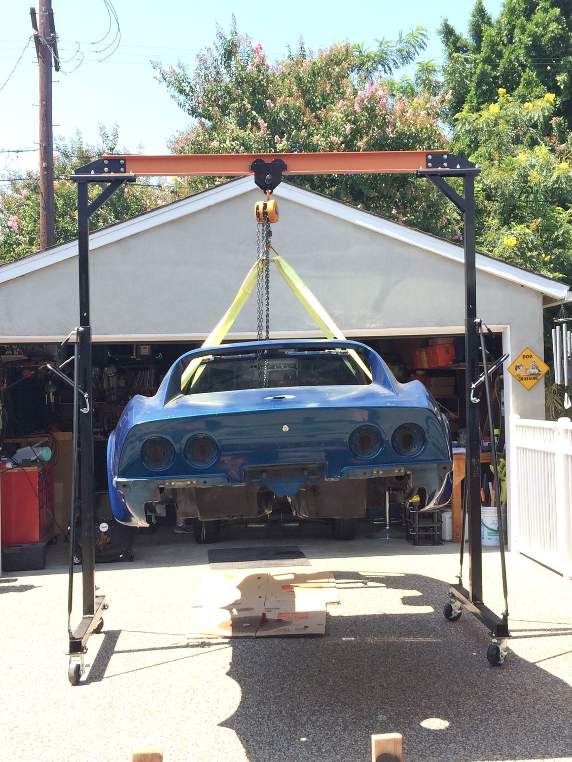

I chose to buy a 1 Ton gantry crane (palletforks.com) & straps made for the lifting of the body (Corvette Central /Body Lift kit) a use $50 dollar dolly ( I'll post Alan 71's dolly) and a 4 post TITAN Classic lift (you can spend a lot or less it all depends on use / 220V or 110V). As for the interior as was mentioned the seats out give you less weight and easier access to the #2 bolts. If your going to strip the cars interior anyway do it before you lift the body IMO.

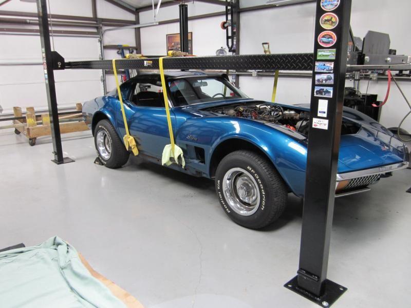

Another way to lift the body with a 4 post lift

Originally Posted by 69FASTFUN
Here is my body off
Did you install 'hanger bolts' at the body mount locations on your dolly? Did you install them before or after setting the body on the dolly? Thanks for your advice and help.
Old Jul 1, 2023 | 04:36 PM
69FASTFUN's Avatar
69FASTFUN
Joined: Aug 2006
Posts: 1,729
Likes: 193
From: Scottsdale Arizona
I installed the bolts after I set the body on the dolly. They were lag bolts.
