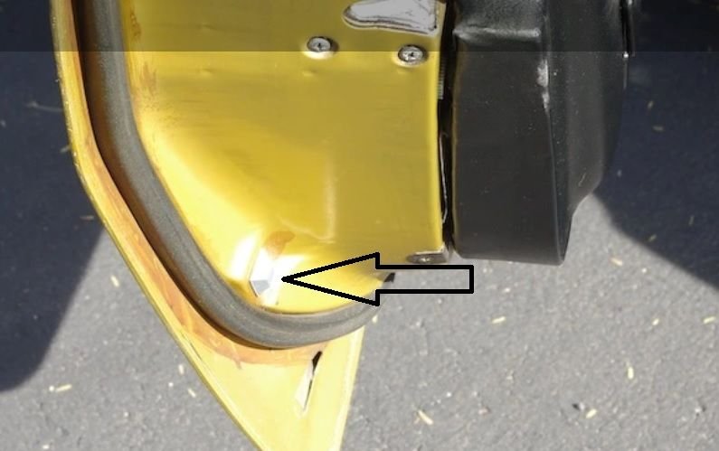

Did you have a helper so you could push both plungers in a the same time? Do you have the rubber bumper attached to the doors.
With ignition on, or engine running on my '71:
In theory, if one or both doors are open, the door ajar light come on.
If both doors are closed all the way and the plungers are correctly adjusted, the door ajar light goes out.
If one or both doors are only shut only to the first click, the door ajar light comes on if plunger is correctly adjusted.
If one or both plungers are in the out position, the circuit is closed and the door ajar light comes on.
If both plungers are in the pushed in position, the circuit is open and the door ajar light goes out.
In conclusion, you need to know if the door ajar light goes out when both door plungers are pushed in. If they do, then check to see if the rubber bumpers are attached to the doors, this might be your problem as others have stated.
If the door ajar light stays on, then remove the plungers to check the wire connections.
That's all I can think of without knowing your plunger conditions....now it's time to go pour my first cup of coffee.
Rubber bumper on door, file photo:
