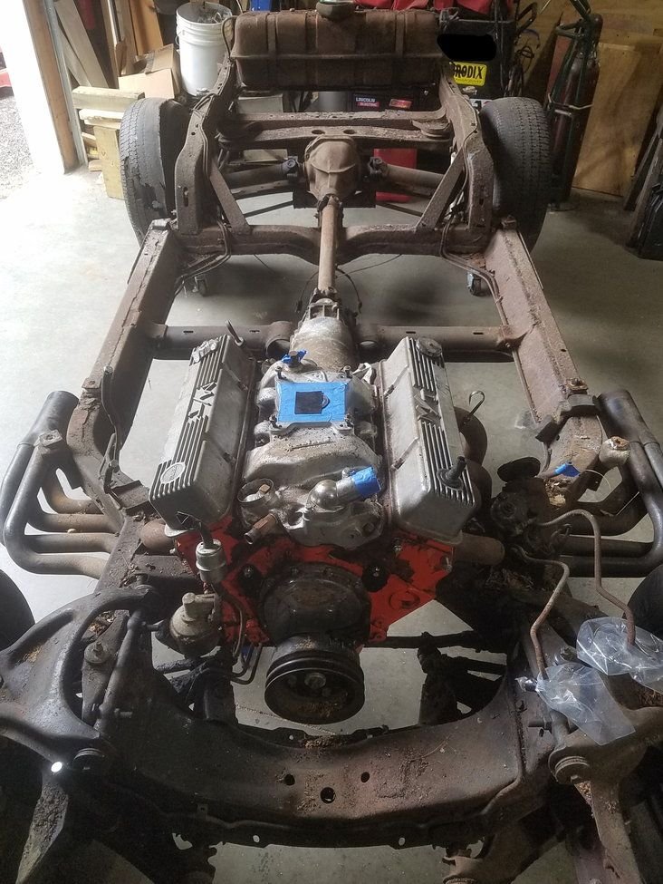

That is really surprising, seeing as Hooker Super Comps (1 3/4" tubes) fit C3 Corvettes with no problems. I ran them for years on my '69 and I have a TH400 auto trans. Consider these.....https://www.summitracing.com/parts/h...ette/year/1969
