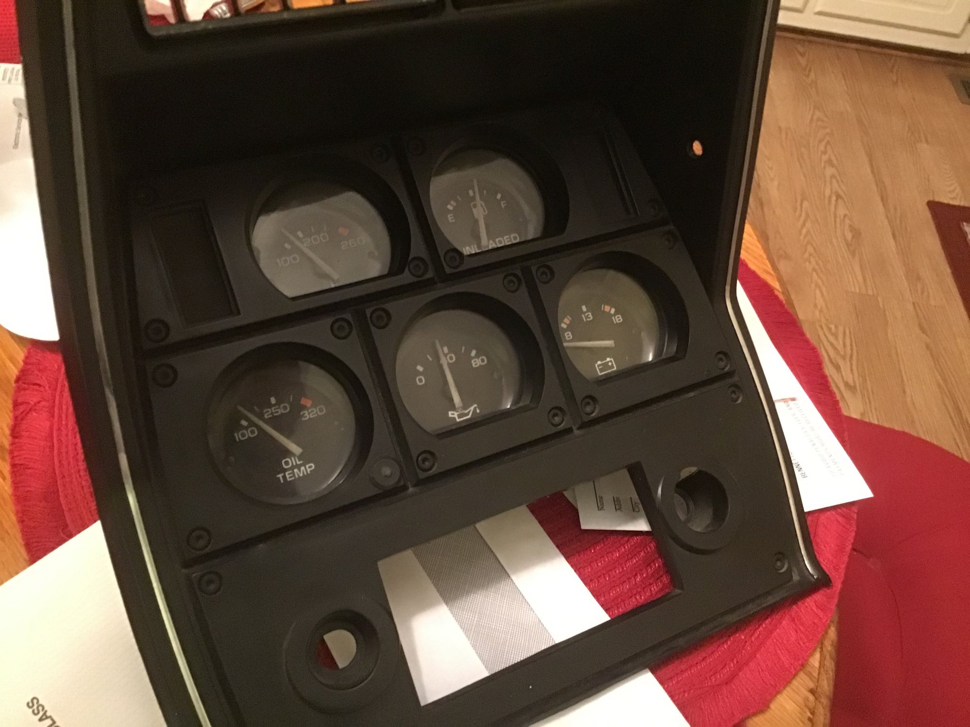

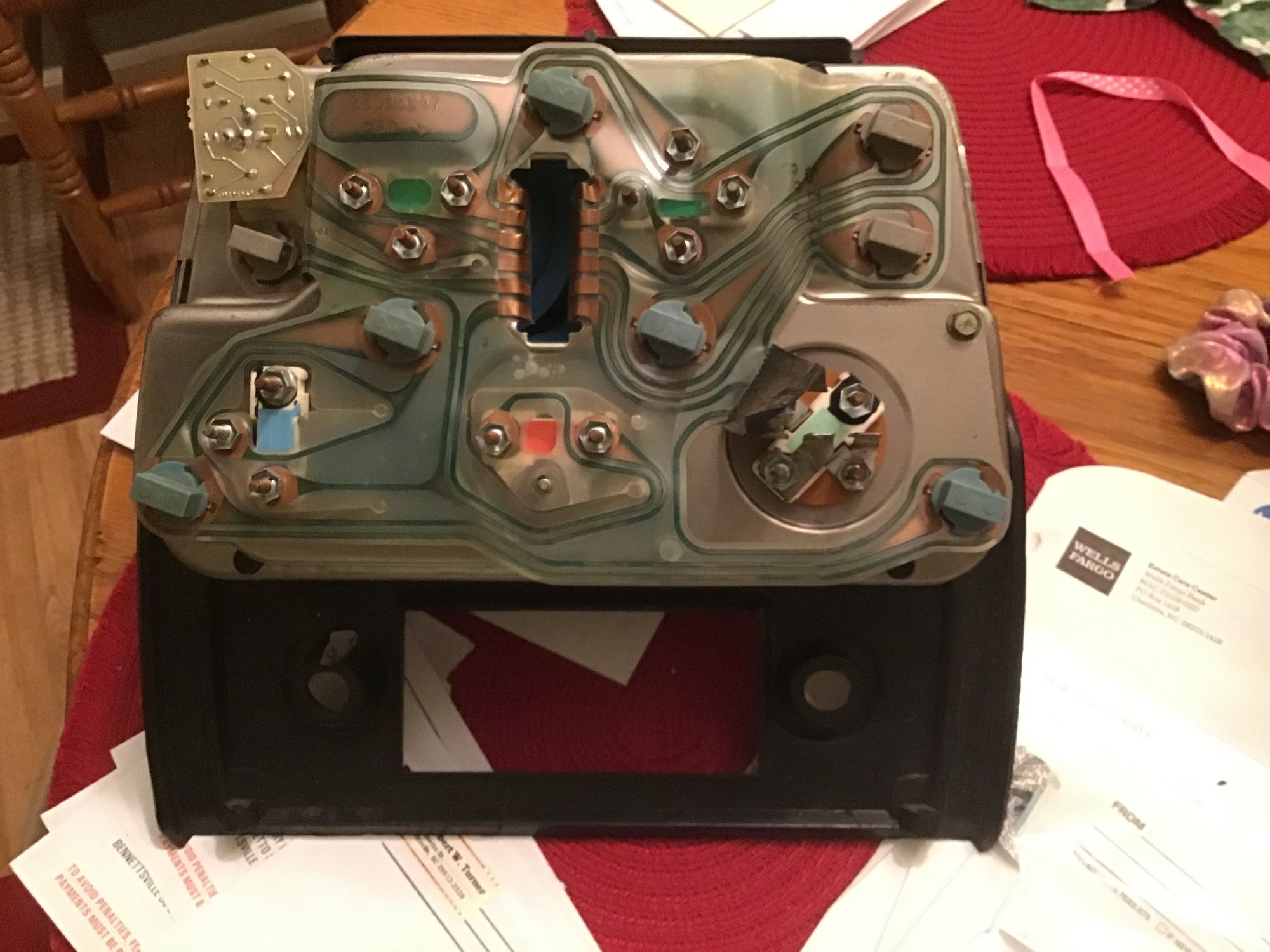

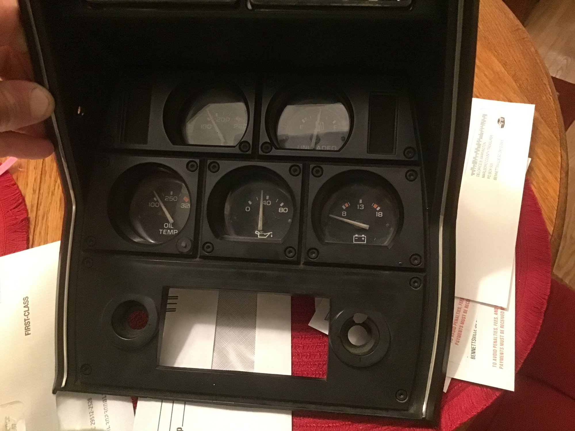

Ok,taken out gauges,and besides cleaning up real good,the bulbs seem to be good or replace them,any tips is very much appreciated.

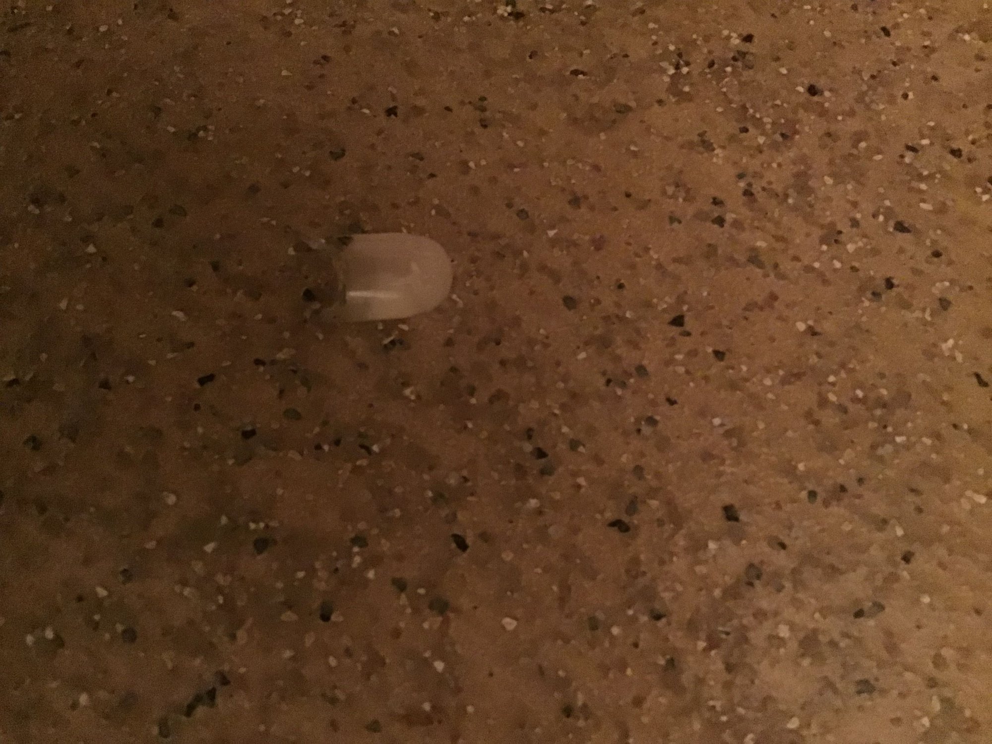

This is what I found inside rattling around.

Yes, if you're all the way in there definitely replace all the bulbs. Incandescents tend to darken with age. Nice new bright bulbs will certainly help.

Polish the clear plastic gauges oninside, will look new

Consider Warm LED bulbs from SuperbrightLEDs.com (or eBay). Just check the orientation before installing, if they aren't orientation agnostic. You may be able to reach behind and swap them after installation, too.

The printed circuit board harmonica contacts look like they are coming loose from the green sheet in a few places. If your gauges were acting flaky it would not surprise me. I got a new one on Ebay for $30. I did not want to have to go back in there again.

My 77 always seemed to dark even with new bulbs and new LED's. I wound up painting the blue backing plate of my center gauges, tach, and speedo white.
Made all the difference in the world, plus they dim if desired. I like the later oil pressure gauge, I may swap the clock for it.

it looks like your wife's fake fingernail. haha

If the plastic face of the gauges are scratched, fogged, discolored, while it's out I would replace that with brand new plastic / what a difference it makes. Usually after you take out & apart the center gauge cluster, like you have & put it back, you will soon be reminded it's not a job you want to do again unless you have no choice. It's a PITA project. Replace, repair, repaint, clean, etc everything you can while it's out / TRUST ME ............
