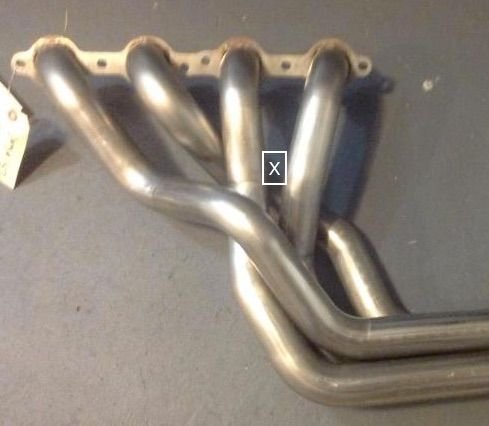

If you're ok with a single pipe instead of the headers extending outside the body, 98-02 F-Body manifolds/shortys will fit (98-00 have EGR port, 01-02 do not). Then you can just run the single pipe outboard from there.
They're not side pipe headers but search Speed Engineering 25-1026-1 for a long tube option. They're not listed as being for a C3 corvette but they fit. They just need some minor massaging around the collector and the #3 cylinder spark plug. They are the closest you'll find out there for under $1,000 and they're stainless.
My engine in this picture is in the "rear" mounting position for LS swaps. A buddy let me borrow the headers to test fit. My actual exhaust is on the ground and uses BBK shorty headers for an 01-02 F-Body. You can kind of picture where they would end based on the flanges.

I love this forum but hate that so many just follow. $300! These headers fit perfectly especially if you are using R&P steering. If you are using a borg box you need to dimple #5 a little. Stock box should be no issue. Using these in both my 69s one with BHP motor mounts other with sbc/lsx adapter plates. Work with Vette and F-body oil pans, I can confirm I've ran them both in my cars. Flange is steel the pipes are stainless.
Ground clearance is great no issues there either and they point out straight no off angle using F-body LS motor headers. Weld a v-band to them and off you go!
Sorry I missed the side pipe part at first the simple answer is No! Not enough volume to make it in mass to = cheap.
