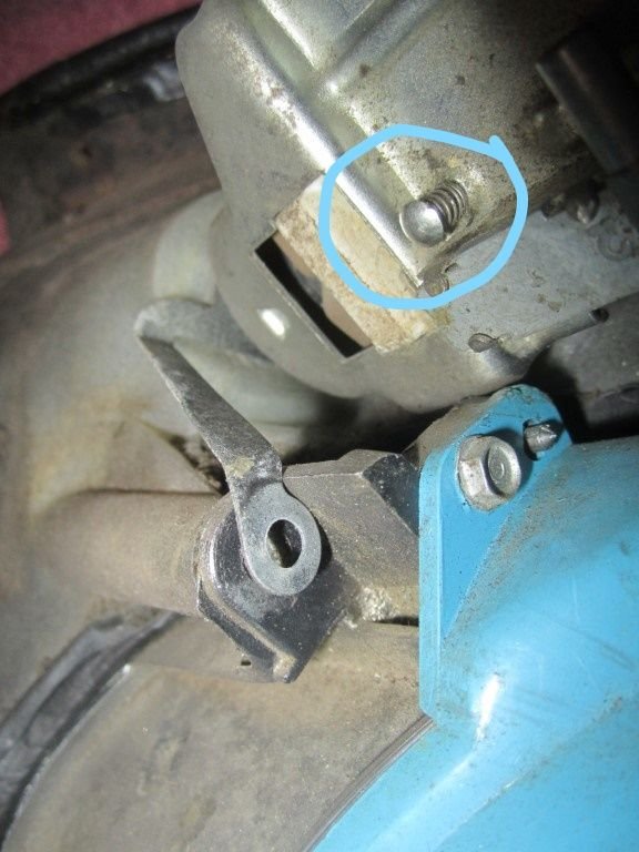

Different year switch but the idea is the same, press this button to let the **** release
M

Once you pull the **** out (press the button in the back and pull the **** out, as the picture above shows the button to press sort of)
Look into where the button was and there is a collar with a flat slot across it. That unscrews and lets the switch come out. You need a wide blade screw driver for it
M
