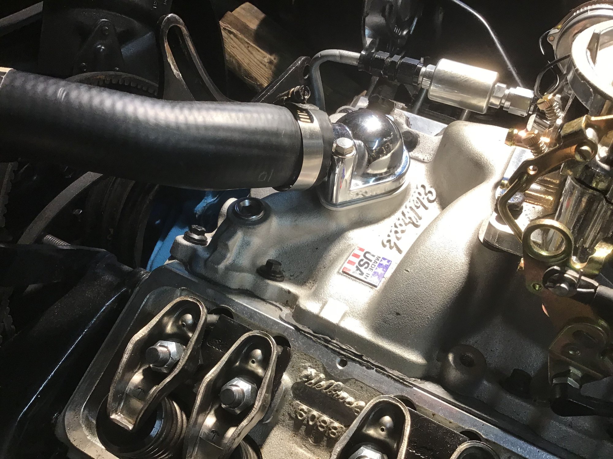

Can I just cap off heater core,I think I have a leaking heater core,or did at some point,I don’t have the hoses hooked up to manifold,because fuel line is in the way of hose,so when I did new heads,intake,carburetor replacement,I never did hook either of the hoses back,so don’t have the one going to the water pump either,question,does those hoses need to circulate through properly or can I just not worry with hooking hoses to heater core,and disregard it. Thanks

That’s what I have now,plugs in intake and water pump,but will that have any way effect circulation water to engine,and I do have AC will it have any issues with that,In SC, I can deal without heat,you got to have AC here.

Sorry wrong side,but you can see my fuel line goes right over the hole of intake,and definitely can’t bend fuel line.

There may be some flavor of big block Chevy that requires the bypass. Not for an SBC, though. Plugs work. Many of us drill a tiny hole in the thermostat to release air bubbles and ensure some flow at all times.
