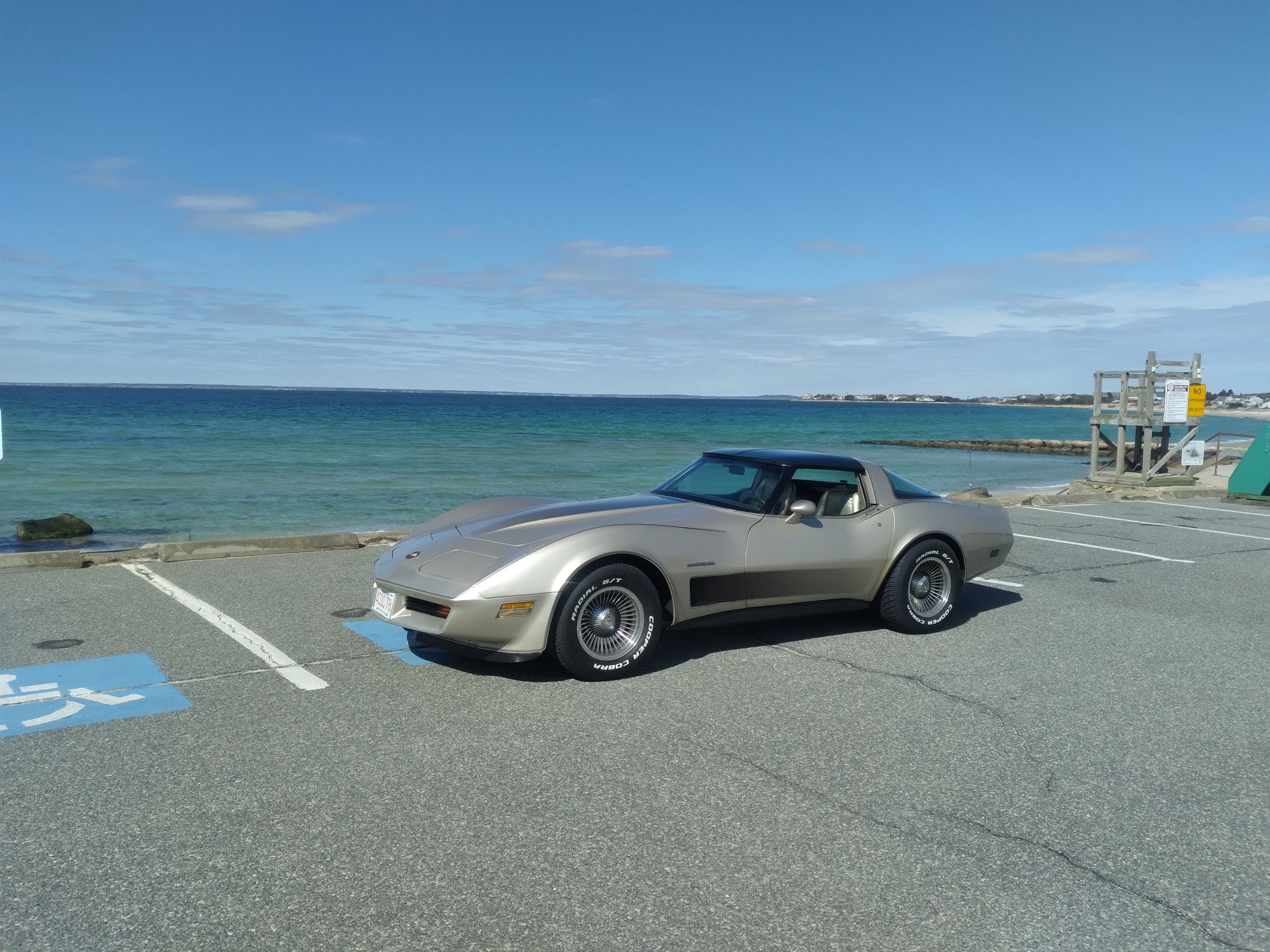

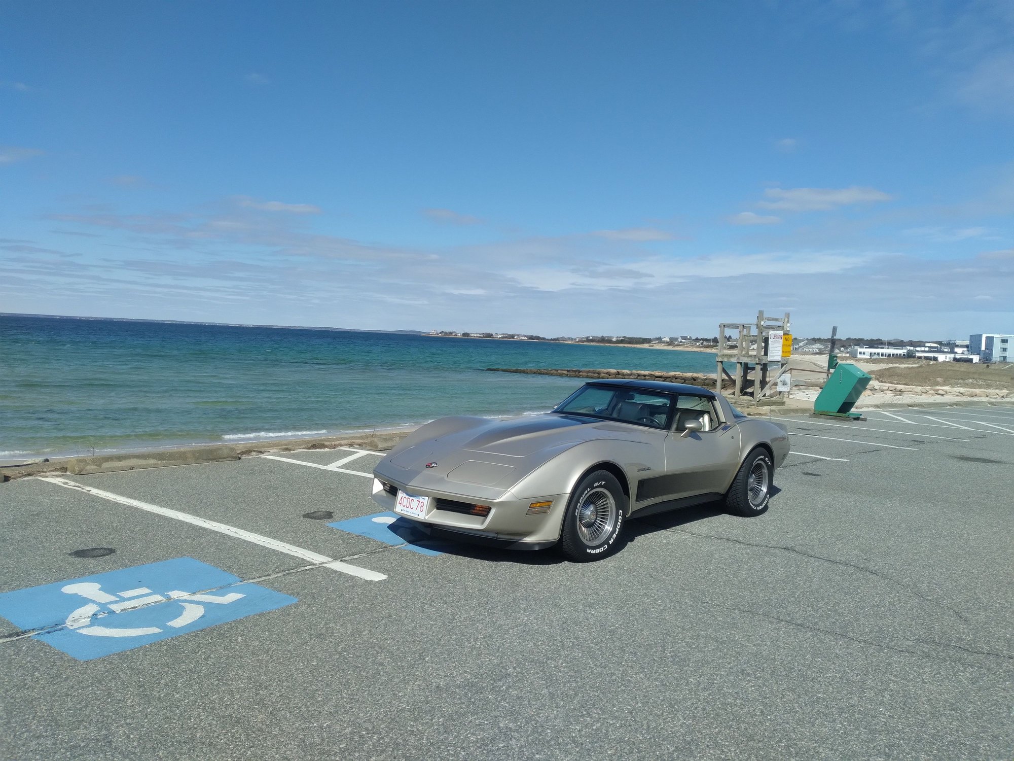

Absolutely love my 82 Collector. Turned 10,700 miles last night. They drive great if left unmolested. Fantastic looking cars. They aren't slugs. They pull pretty good out of the hole and with a 24 gallon gas tank and 28 mpg, you can enjoy long drives.
