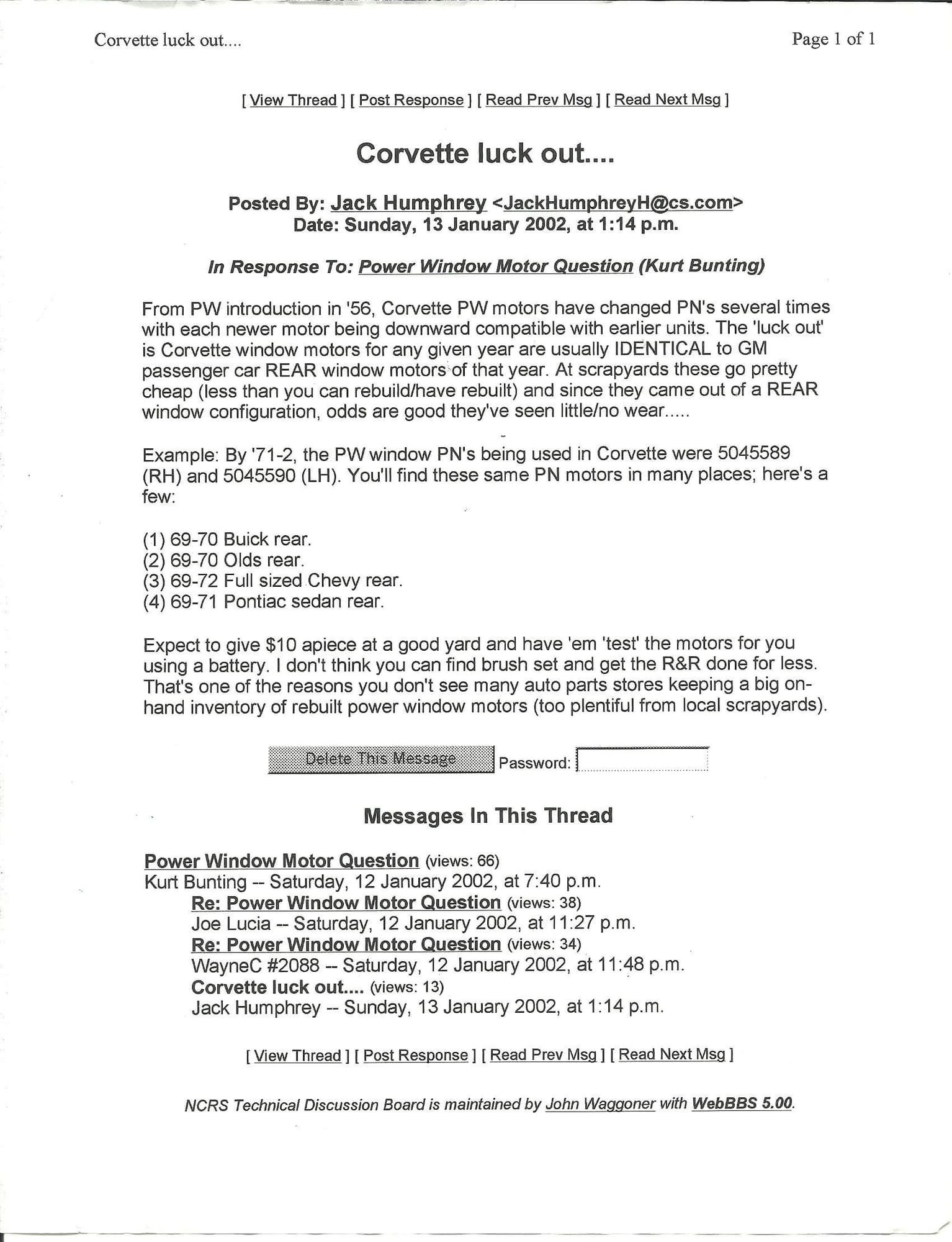

In case you need to source a used regulator motor, you won't need to confine your search to Corvettes. A very good point is made about the likely low use of rear window motors in these models -
