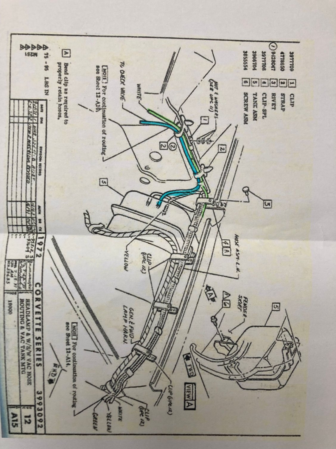

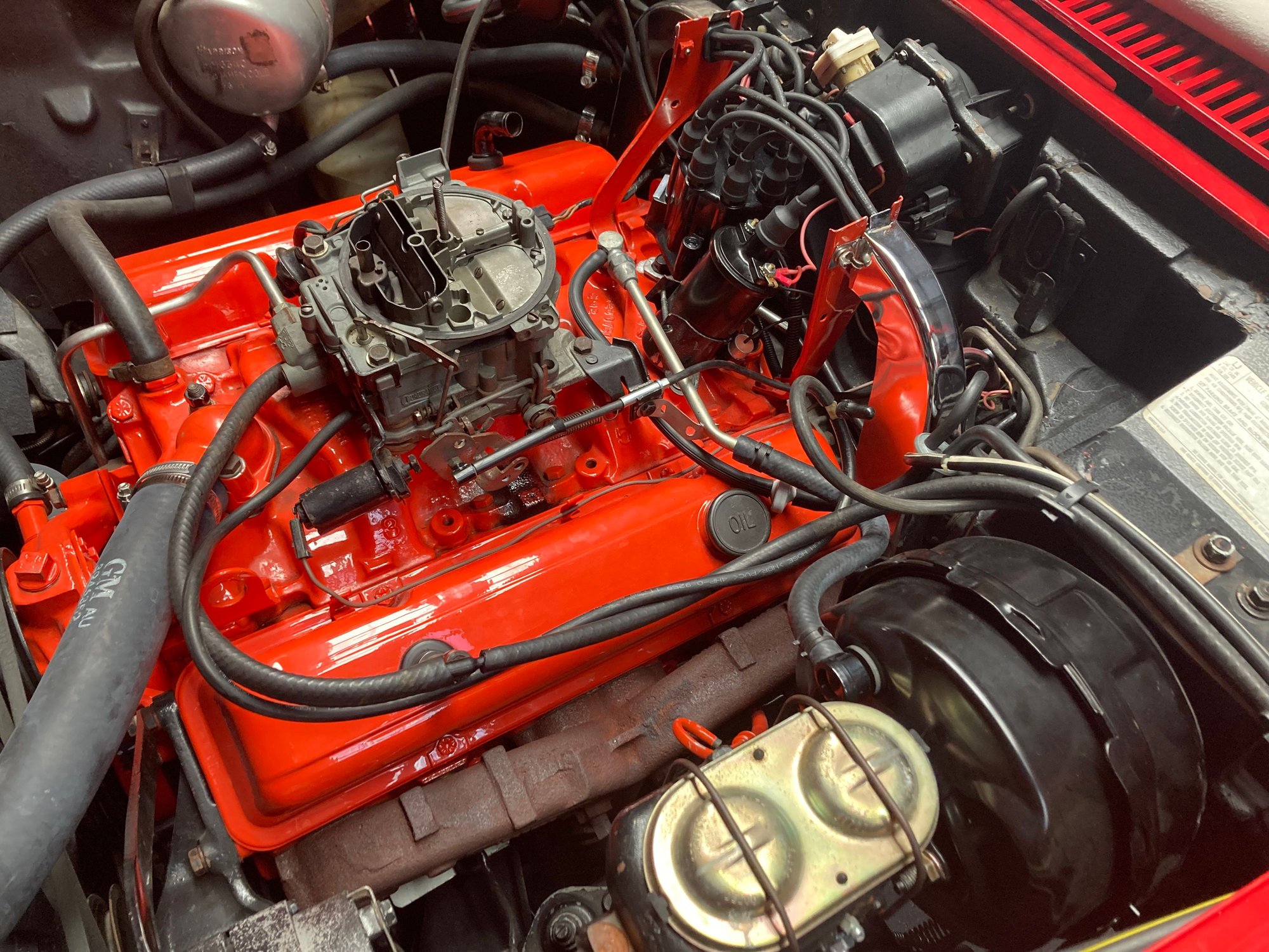

Hi fellow Vette enthusiasts. Can anyone confirm or correct an issue I have with the connection of vacuum to/from the carburetor. Background - I have a 72 with a 350 and a Rochester carby and live in Australia so I do not have access to another Vette for comparison. The issue I want to sort is that the front of the carby vacuum connection where does it connect to? I assume the carby connects to the vacuum cannister via the "White" stripped hose. See attached photo and diagram, confirming it is the front hose connection that I am trying to determine if I have done it correctly.

The vacuum line to the vacuum canister should be the line with the filter and check valve coming off that fitting in the rear of the intake manifold.
As per the line with the white stripe, I blew up the photo and it looks to be a dead end. The vacuum line off the front of the carb gets lost in the spaghetti of hoses near the brake master. Can't follow it.

The two lines from the front of the carburetor go down to the "charcoal canister" which is "down under" the vacumm storage can tucked under the drivers fender, (sorry couldn't help myself)
They go to the left two pipes there, the last pipe is the one that goes back to the gas tank
The vacuum system that runs the wiper door and headlights etc

Where is your distributor vacuum advance hose hooked up to? I don't see it at all. In stock configuration, it should be hooked up to the "ported" vacuum nipple on the forward, left side of the carb's float bowl. It is not... But for better performance, it should be hooked up to one of the carb's manifold vacuum ports, which I also don't see. Do you have your vacuum advance hooked up at all...? It's essential for good idle, good throttle repsonse, and good fuel economy. Whatever hose you have hooked up to that "ported" nipple should not be on the "ported" source - it should be manifold vacuum.

Accelerator pump arm in wrong hole which I know thanks to you.
