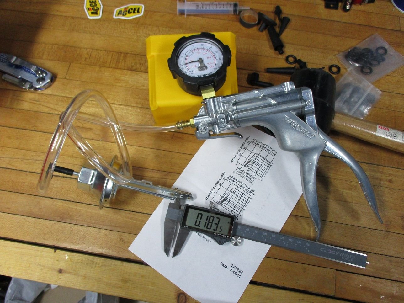

A timing light, vacuum gauge, and Mity-Vac are critical tools for these cars.
@HeadsU.P. covered most everything. Perhaps this image of bench testing an adjustable vacuum can helps.
Also, you may immediately see an idle improvement if you make sure the vacuum can is connected directly to a manifold vacuum port on the carb, not ported. You can check with your finger, or a vacuum gauge.
